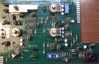

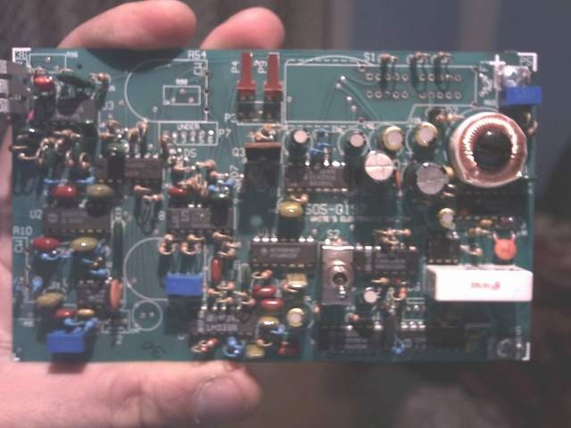

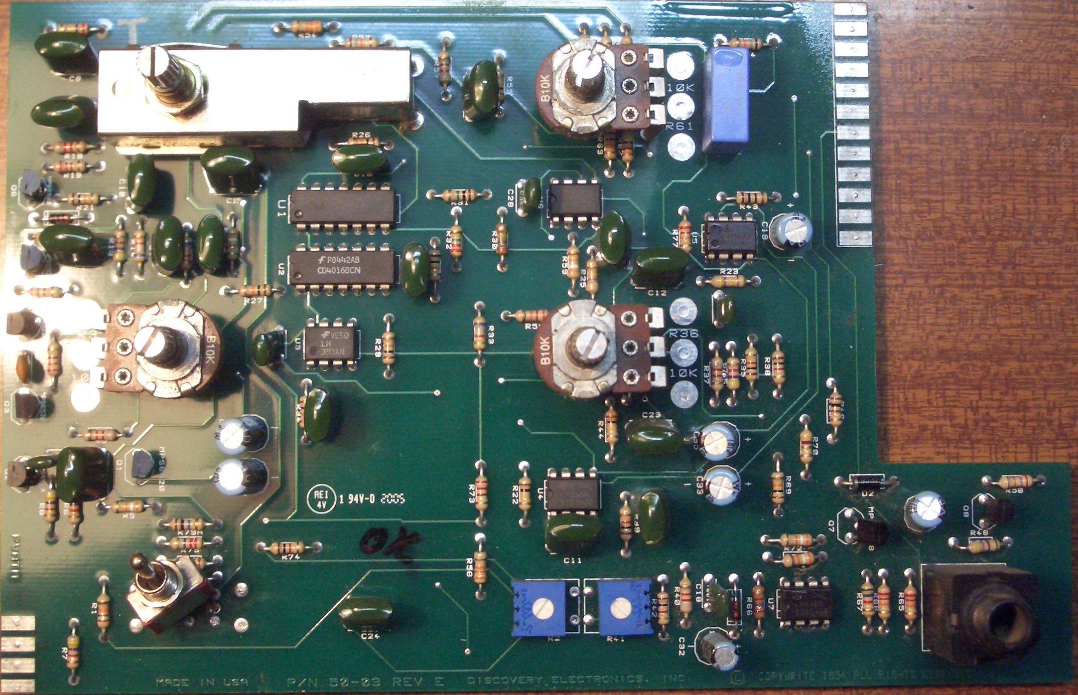

    oh mamma mia! we again stand up the matter(( THIS IS ONE COMPANY, ONE TOWN, ONE REGION. the pic of Ivconic autorized.
    TM-808 is the part of White's detector 5900 DI PRO SL, 6000 DI PRO SL, TF900 is a copy of TM-800. take attention i write sometimes name with the dash,
    and without the dash. you have to write RIGHT, SORRY AMIGO , too.
ID:	415949 pcb of TF900
        pcb of TM-808 Click image for larger version
          KT....the TM-808 is different, but the TM-808's with Cave mode are not.....different beasts with identical name. I think at the end of the TM-800 production run, some were labeled as TM-808, but only a few. Not many TM-808's had cave mode.
          Jim
