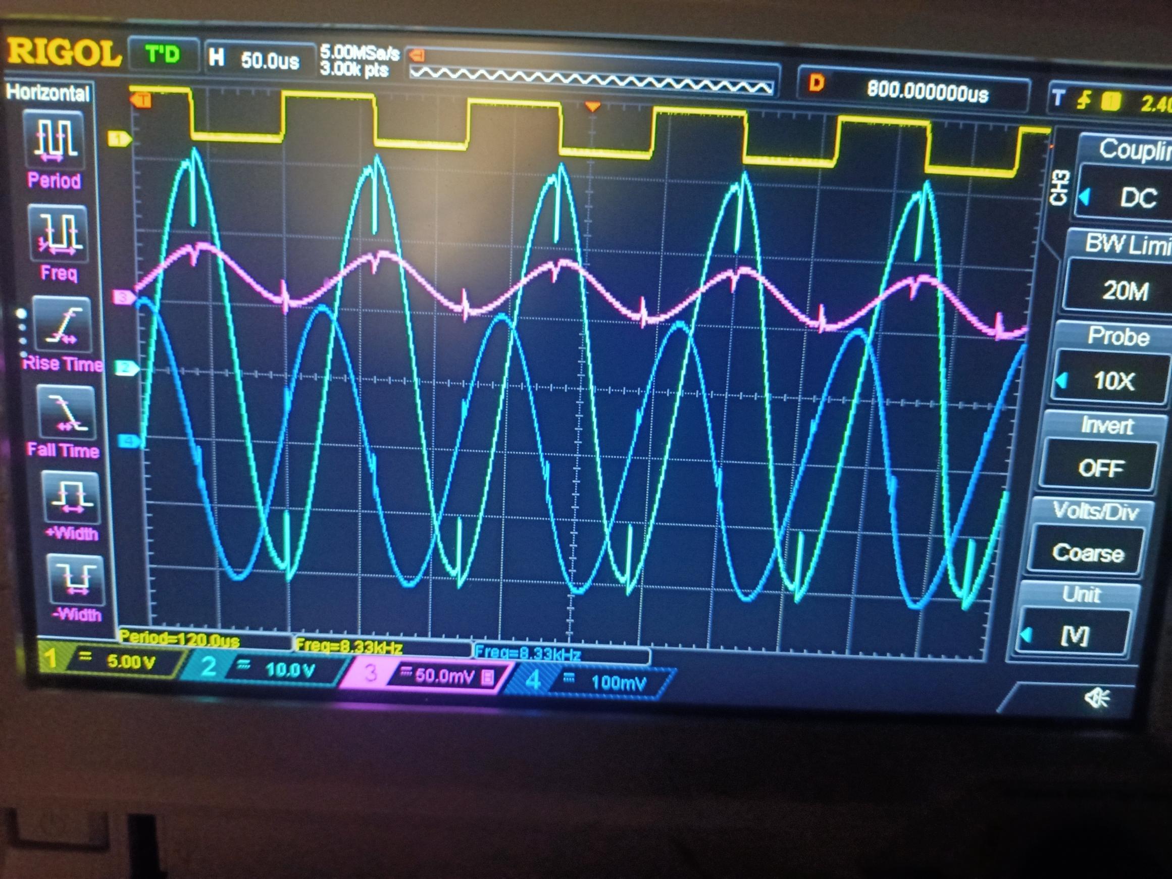

                  Testing the CCPI TX module for suitability for the ARMD project. I have only tested one frequency as there is a lot of gotchas when you move frequency.
                  The selected test frequency is 8.33 Khz and the TX circuit develops 4 Amps peak to peak in the IB Tx coil with approx 10 millivolts of unbalance in the RX coil.
                  The CCPI support Pulse induction mode as well ... so I thought why not. By switching a single capacitor in / out the CCPI converts from PI to VLF. The DSP sampling
                  front end remains practically unchanged and instead of IB balance we can do ground subtract. ??? maybe
                  I was pretty happy with 4 amps in the TX coil and less than 4 watts consumption from the battery. ( in PI or VLF mode ). There are some linear regs in there .. so room for improvement.
                  Note the 4 amps peak to peak is in sinewave VLF mode ... the PI mode is about 1.5 amps as the flyback is 2 microseconds and the mosfets dont like it above that.

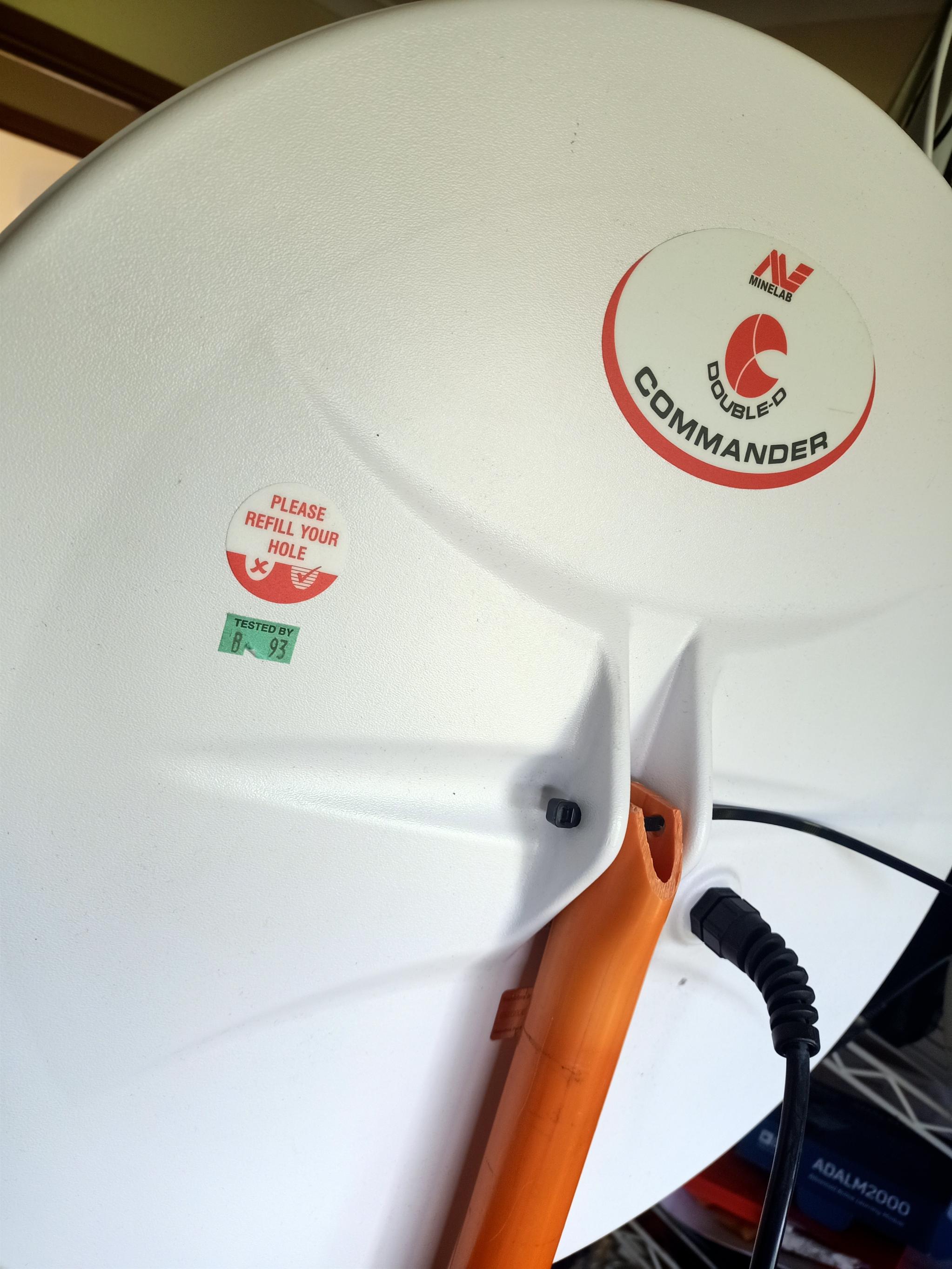

                    Can you post a picture of coil which can handle 4A ?
                        The coil is a minelab DD ... Its made for PI use and I believe the TX coil is wound with Litz wire. There is no capacitor across the coils ( like you may find in some VLF coils ).
                        Its a wide band low capacitance coil and the TX reactance at 8.33 Khz is about 15 ohms - 20 ohms and real ohms is 0.4 approx.
                        It develops 60 volts peak - peak across the coil @ 4 amps.
                        I should have quoted the IB leakage as 10 millivolts per amp ... so the unbalance at 4 amps is 40 millivolts not 10 millivolts. However 40 millivolts at 4 amps is OK for my application.
                        Below is pic of waveforms from the testbench ...
                        Yellow = TX clock
                        Pink = RX voltage ( 40 mv pp )
                        Light Blu = TX voltage ( 60 volts pp )
                        Dark Blu = TX current ( 400mV pp ) sensed by 0.1 ohm resistor in TX leg.
                        Click image for larger version  Name:	ARMDsigs.jpg Views:	0 Size:	451.2 KB ID:	418500

                            40 millivolts​ With IB NULL - how much lower you can get ?
                            Your sines do not look so good, try TC4420.

                                For PWM filtering I use this filter, 10k and 1nF, it gives a pure sine wave. How clean is your signal at the Tx amplifier input?
                                Click image for larger version  Name:	image.png Views:	0 Size:	23.4 KB ID:	418523
                                It develops 60 volts peak - peak across the coil @ 4 amps. = For calculation you should use RMS not pp voltage ​
