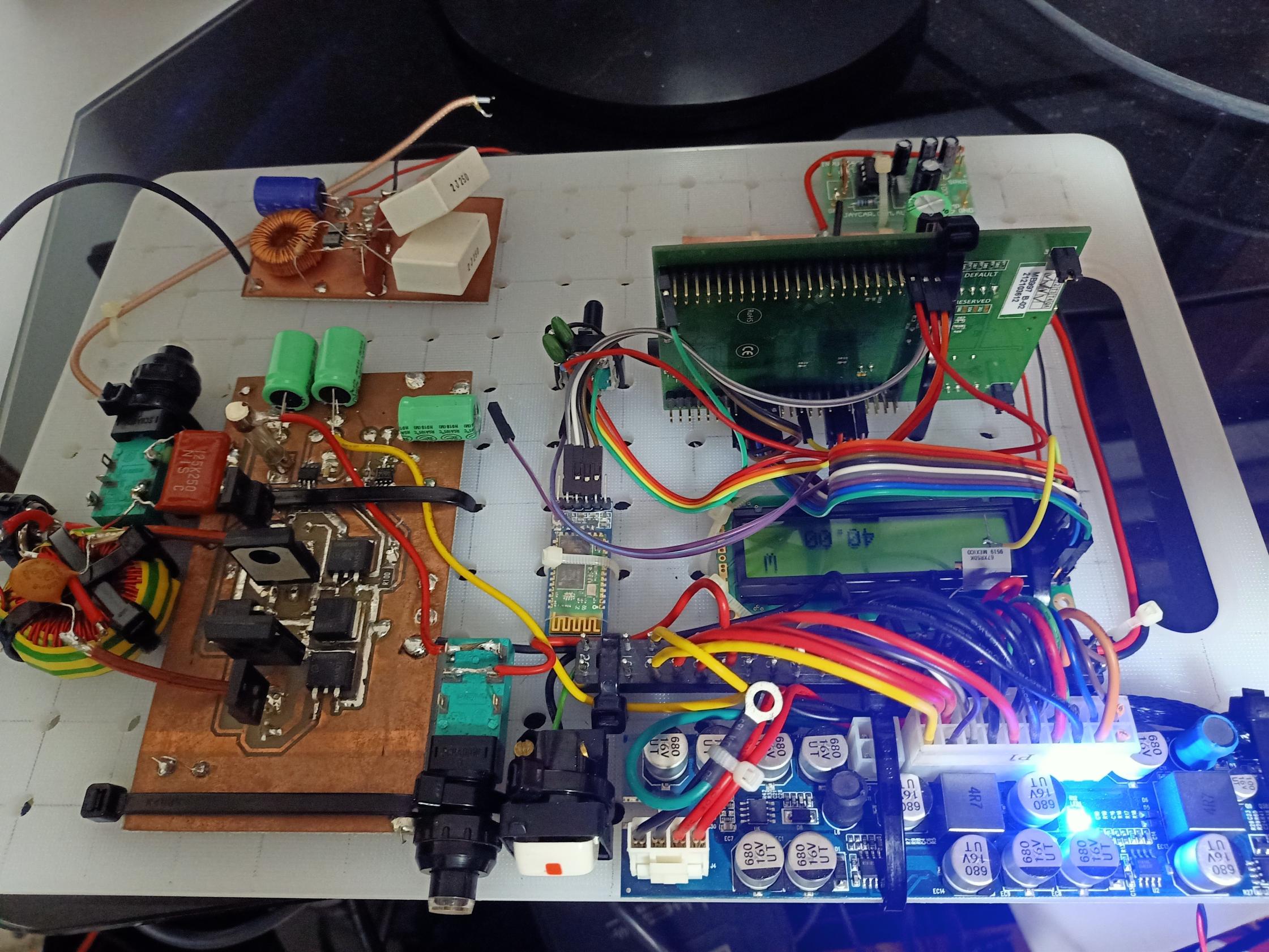

    In the meantime i have bread boarded the ARM board with power supply / blue tooth / rotary encoder / audio amp / LCD / TX board and just about to wire in the RX board.
    So far so good .. no smoke and everything working.
    ​ Click image for larger version  Name:	firstsmoke.jpg Views:	0 Size:	483.7 KB ID:	418676

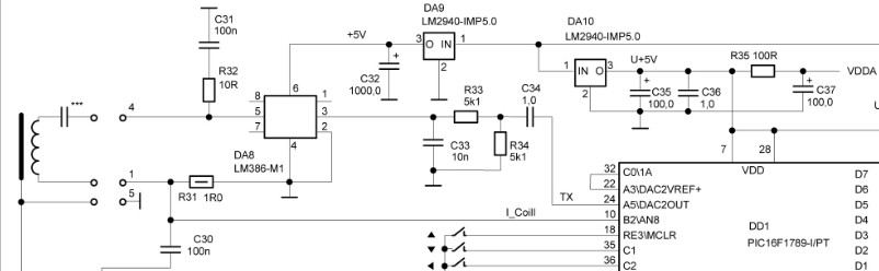

                            However ( BAD ) it only works at one frequency and not easily MCU controlled. The frequency can be changed but adds complexity.
