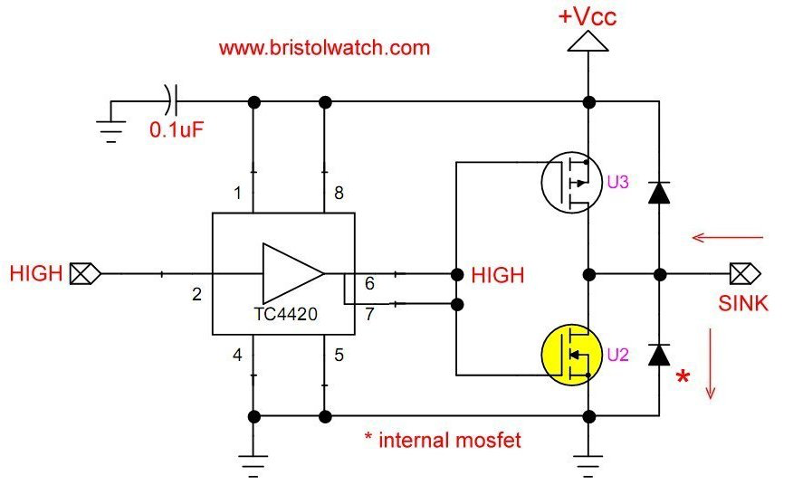

        The output impedance of the TC4420 is too high at 2.5 ohms.
        The mosfets are in the test circuits are a few milliohms and of course they can be in one package. .... they are drawn separately for ltspice modelling.​

          then you use this circuit, for low impedance, and
          2 milliohms​ IPD100N04S402ATMA1

            What you suggest will work no problem but it does not improve the performance ( identical ) and adds an additional part type to the BOM. If the PCB layout is easier it can be considered.

                          From a start I have the problem of obtaining a suitable driver, plus the inability to work with small SMD components.
                          And that is the first and foremost deterrent factor from trying to do anything on this subject.
                          So every now and then I find something interesting on the net and try to think...
                          I used the totem-pole emitter follower often in my works to drive either loudspeakers or piezo transducers directly from MCU.
                          It has perfect isolation to the MCU side, amplifies the current and generally proved to be a good and simple solution with a minimal number of components.
                          This configuration performed very well at/up to 10kHz.
                          Although so far I've only used it up to 1kHz.
                          It would be good to do the analysis for 25kHz.
                          "Shut through" or "dead time" will first depend on the code in the processor. But the on/off delay should also be taken into account.
                          Opinions?

                              You are over analyzing the circuit Ivica .. there is no shoot thru ( or if there its not a problem ).
                              Just use a TC4428A chip to drive both sides of the bridge. Its available in DIP no smd. The worry about your driver is making me ill.
