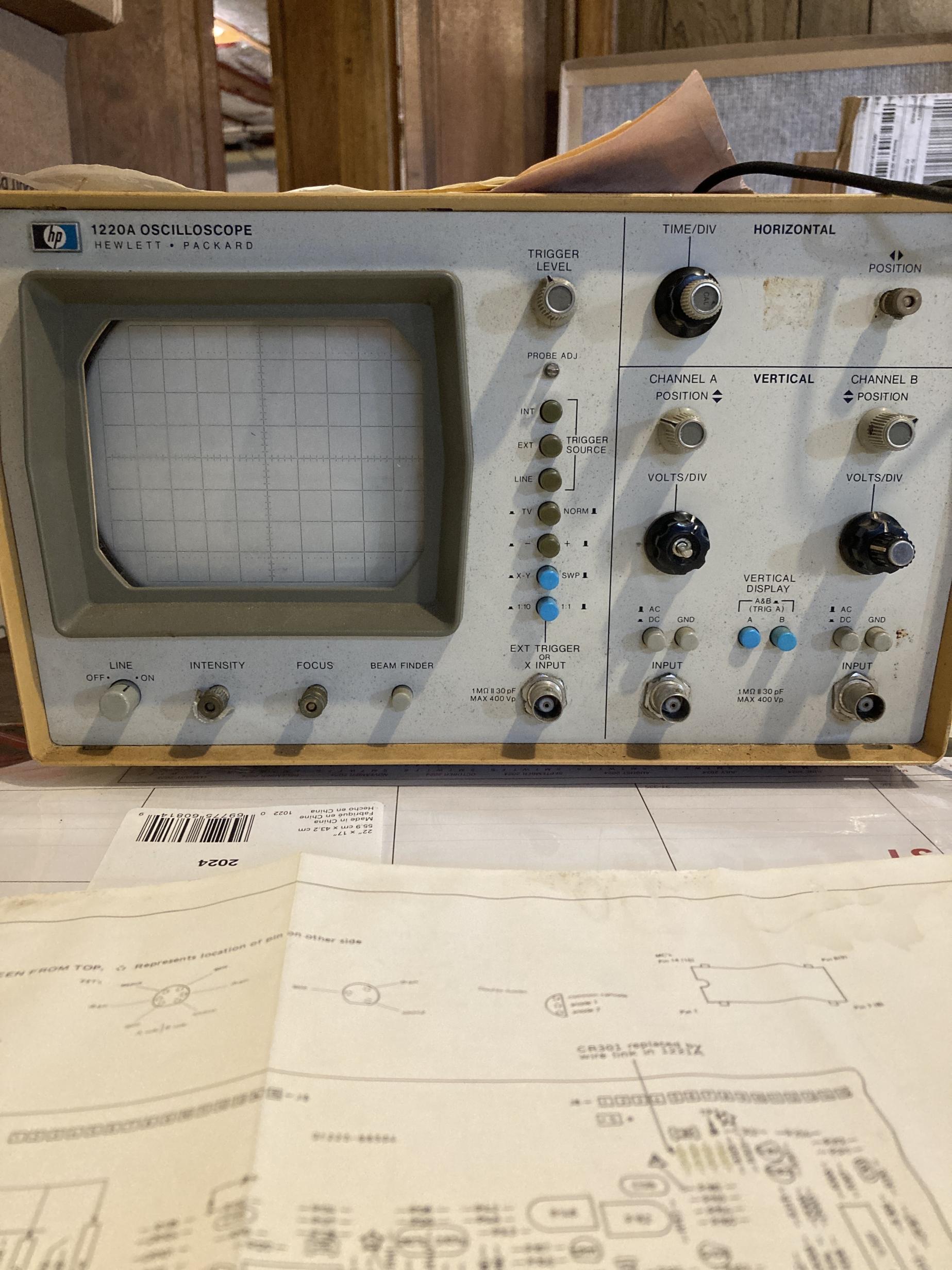

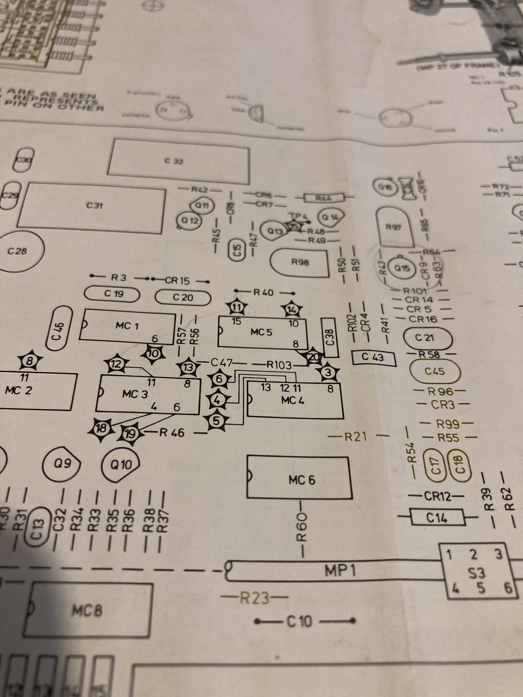

    The original manual has very good diagnostic steps but still I haven't found the problem. Can get a single dot, then 2 dots but they don't move when adjusted. Checked the voltage on the transistors mentioned all okay Click image for larger version  Name:	image_6209779(2).jpg Views:	0 Size:	451.9 KB ID:	422472 but still no good. I've used the built in square wave but it doesn't display either. Checked many components in the area but all seem to be working correctly Click image for larger version  Name:	image_6209779.jpg Views:	0 Size:	352.3 KB ID:	422470 Click image for larger version  Name:	image_6209779(1).jpg Views:	0 Size:	406.4 KB ID:	422471

      Obviously the deflection circuits are not working. But it could be anything from the HV power supplies to the signal source. With the horizontal deflection somewhere there is a sawtooth ramp generator whose frequency is set by the time scale knob. Try to find that and see if it's working. Ironically, you will need an oscilloscope to do that.
        Do you have schematic ?

            I'll recheck Q16, CR10, R68, R67, R105

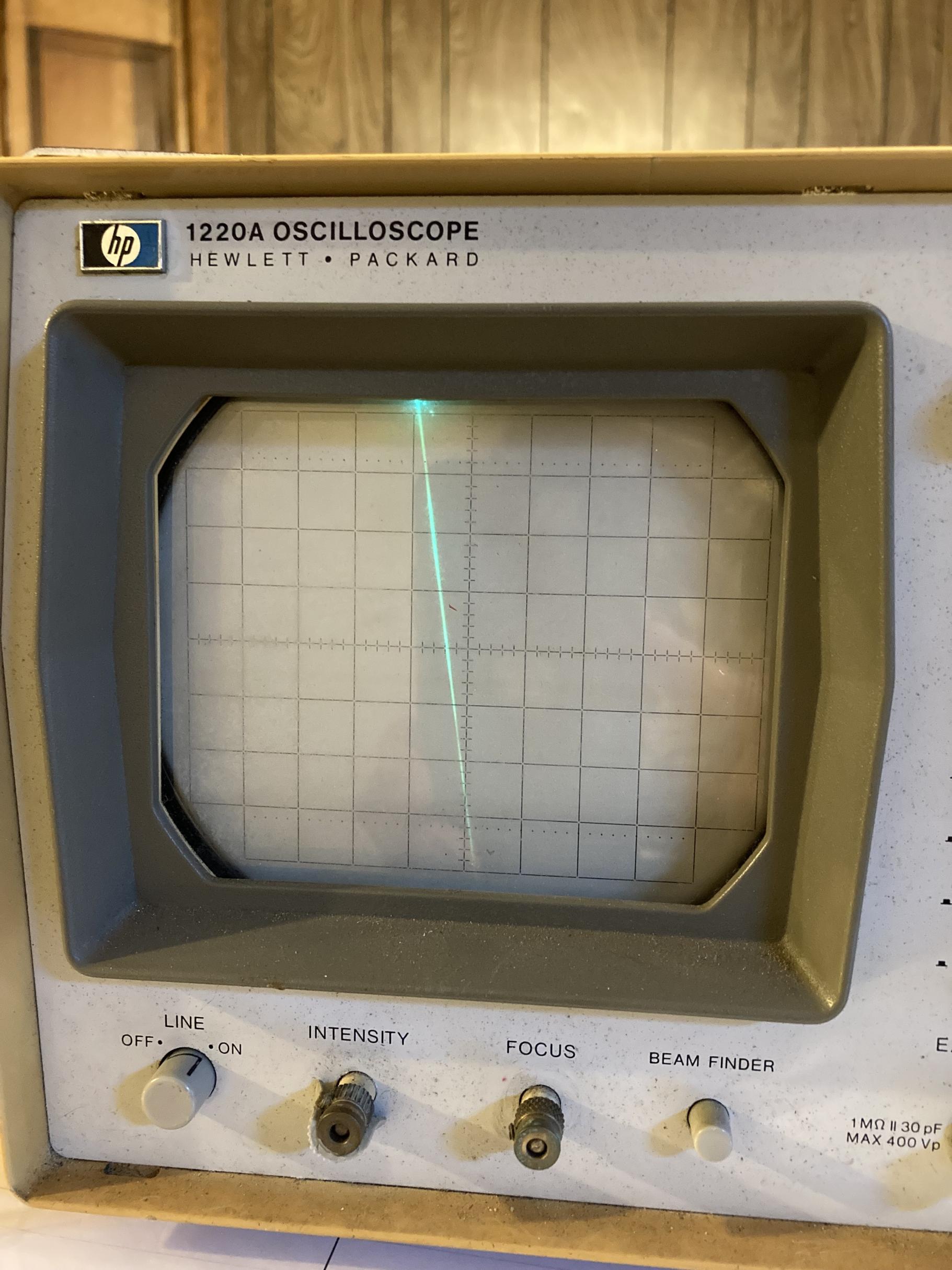

                    I did notice something strange with the dot on the screen. I could adjust the time/div and volts/div and the dot would move up and down about a millimeter or so. Like there was a capacitor charging and discharging in the circuit.
                    Don't know what went wrong with the other attachments but I'll wait until later if need be to upload. One thing about this manual it does have complete schematics of each group of circuits. Very interesting to say the least.
                      put switch in X/Y mode, set volts/div on max sensitivity, touch probe by finger , report results. With schematic you will safe the time to locating the problem.

ID:	422562 First time I tried this the results were pictured. Only worked one time. While holding probe adjusted the volt div and never got the same results.
                          what about y probe , can you move the dot to the center of the screen?
                            Can only move dot up and down. Very little movement left to right
