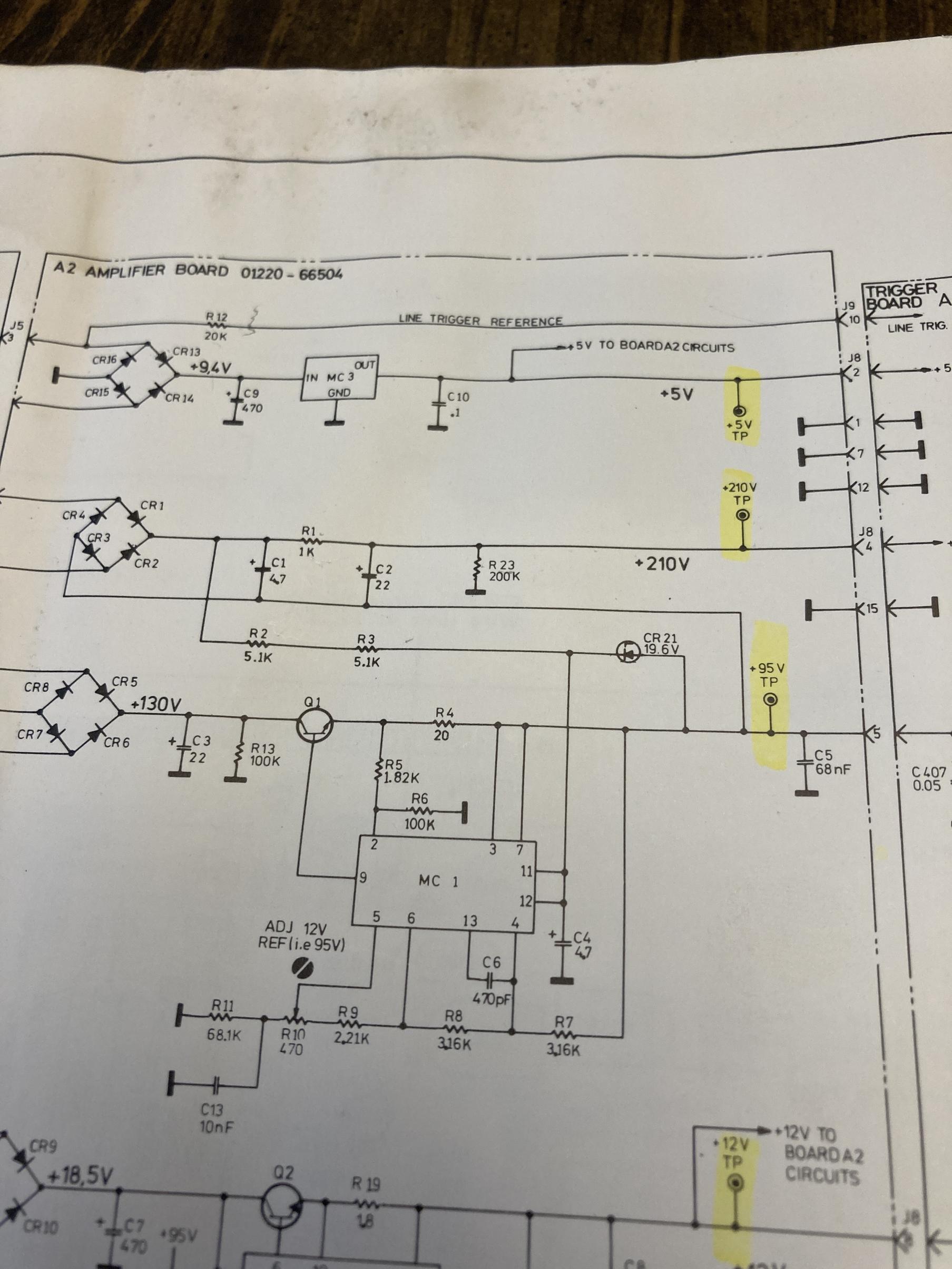

      Click image for larger version  Name:	image.jpg Views:	0 Size:	336.7 KB ID:	422944 Thought I would back up and start with known problems. Reference voltage should be 210 but measured 256. Checked R23 and it was 27k ohms. Replaced with a 200 k but after installing I still get 27k. I missed something, there are a lot of components referencing to ground. But one thing for sure, even if I never repair the scope, I'll have plenty of good parts.
