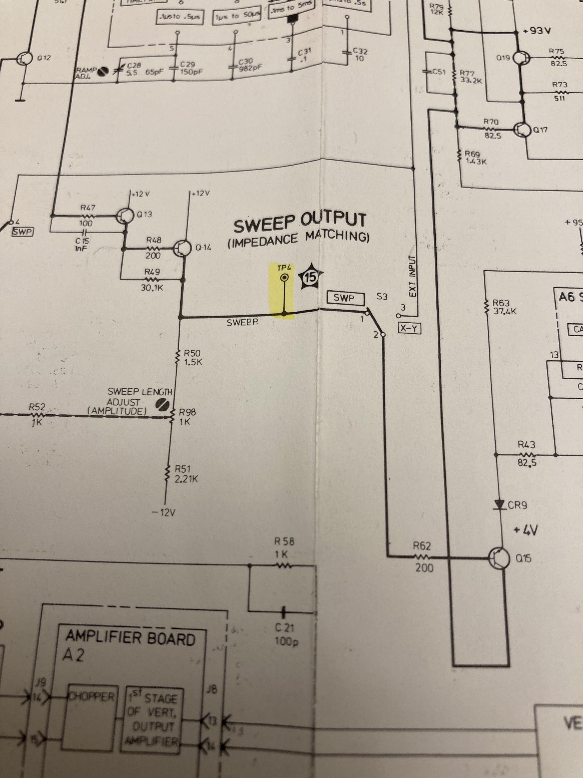

    It seems that X channel is ok. In X Y mode both channels are the same, so you can compare DC voltages in different points of X channel with Y channel.
    I could not get it to scan to kilo HZ. = I am able to observe 15 kHz, another one https://www.zeitnitz.eu/Scope_en
      oops Typing error,
      X should be Y instead, and Y should be X instead

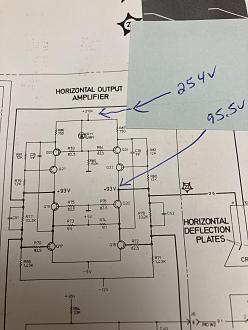

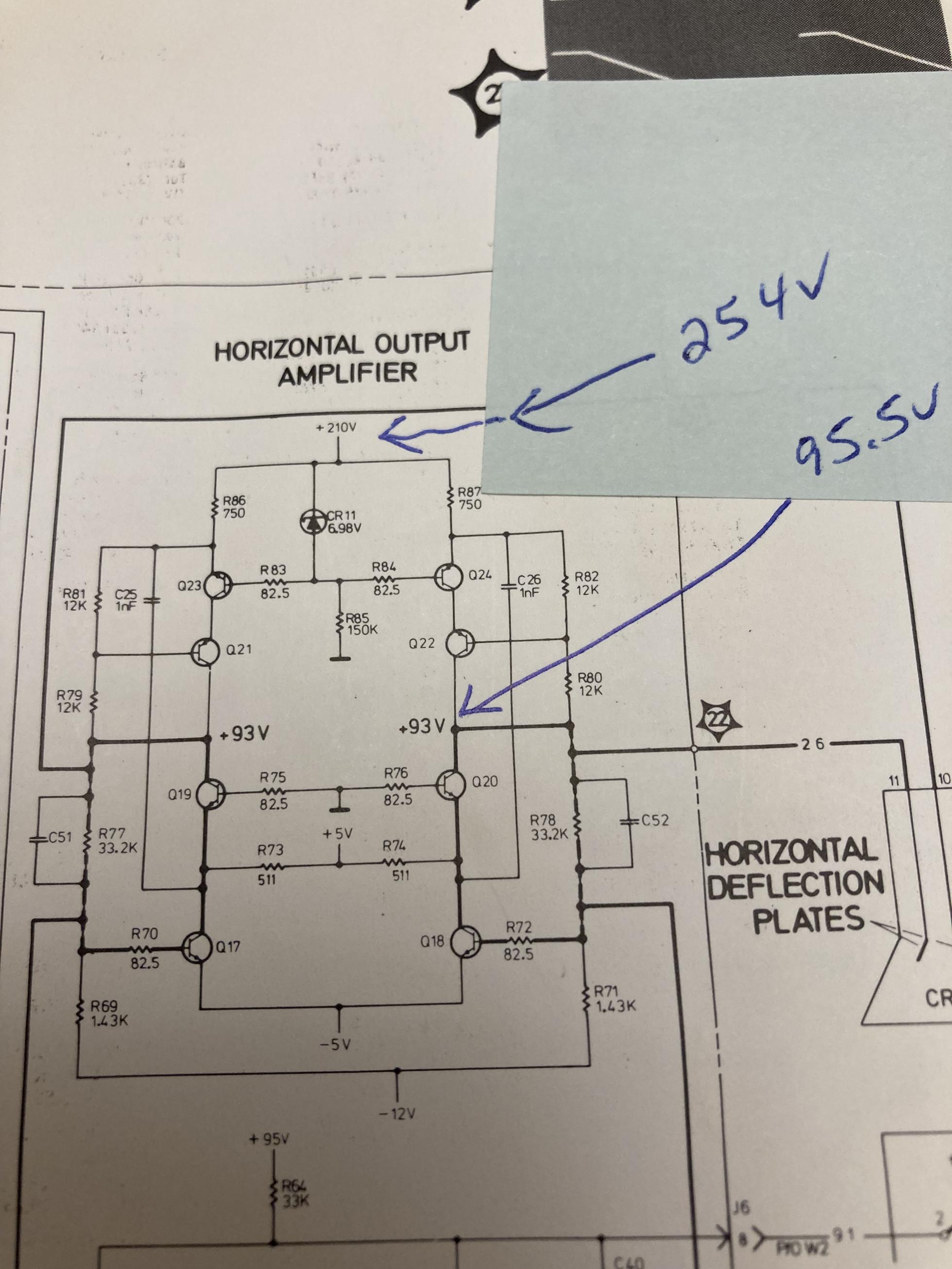

ID:	422720 Voltage readings high
          The schematic is blurry what are the correct printed voltages for the two points? A few volts difference is not a problem. Look for the horizontal sweep generator on the schematic. It will be a ramp generator that feeds or modulates the horizontal Amp.
            210 and 93

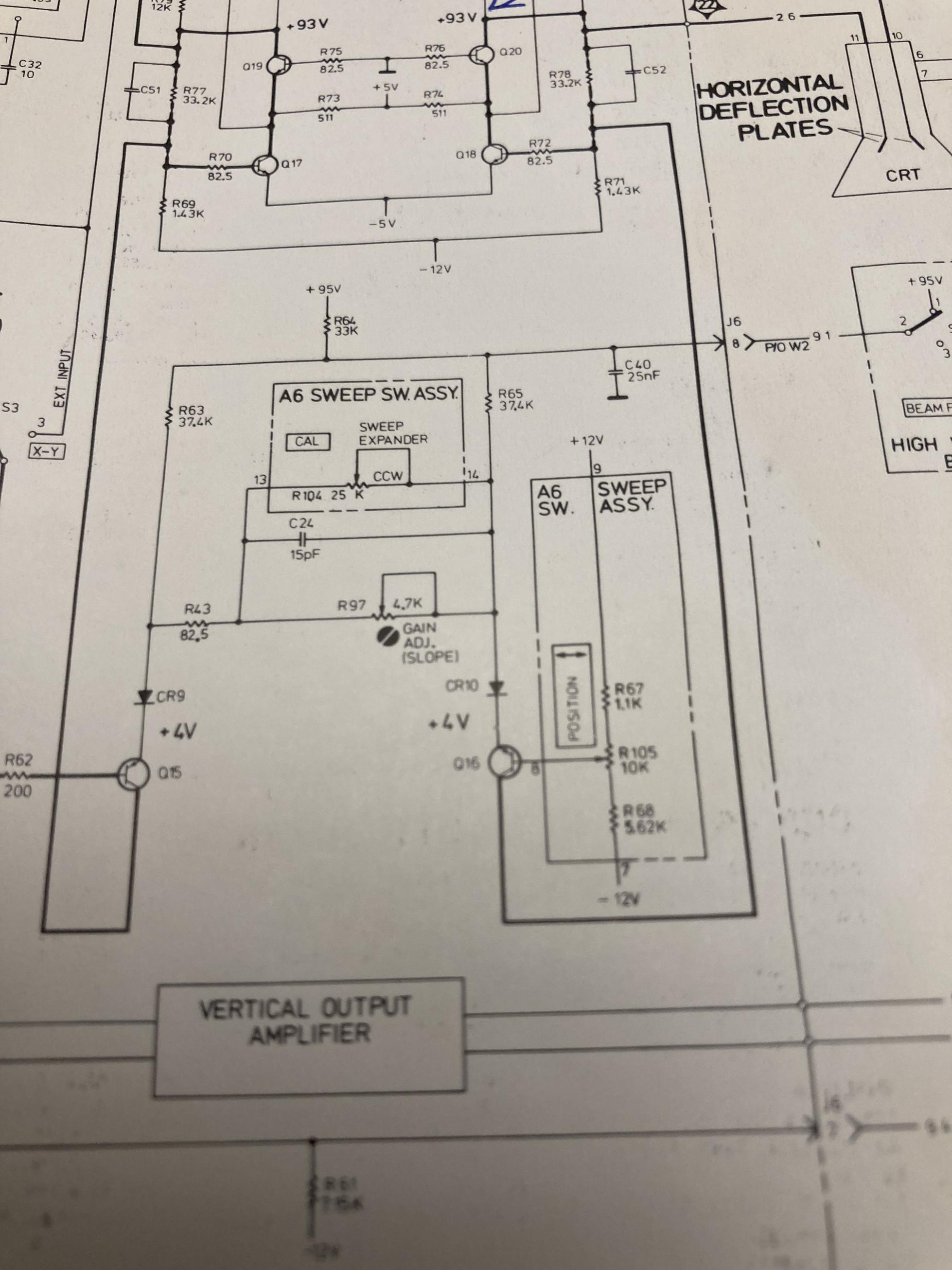

              post #18 = voltages are ok, show lower part of the schematic with horizontal position potentiometer
                  R105, rotating it voltages on wiper and collector Q16 are changing ?
                  where is connected another end of R62 ?

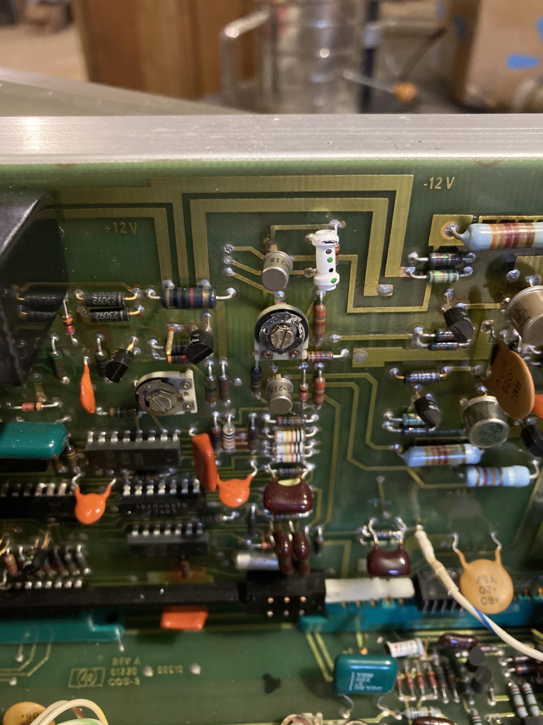

ID:	422736 I’ll report back later

ID:	422743 When rotating R105 these are my readings
                          post # 26 = it is a transistor Q16 ?
                          are you rotating potentiometer on front panel, top right corner ?
                            Yes Q16
                            Yes top right button labeled Horizontal "position"
                              It looks like on emirrer you have -4V instead of +4V
                              and you have SWP switch in position 3 = x-y ?
                                Noticed the -4 so I check the diode coming into the transistor and it's okay.
                                Yes on SWP switch to x-y
                                Tried the switch both ways and still couldn't change the -4v
