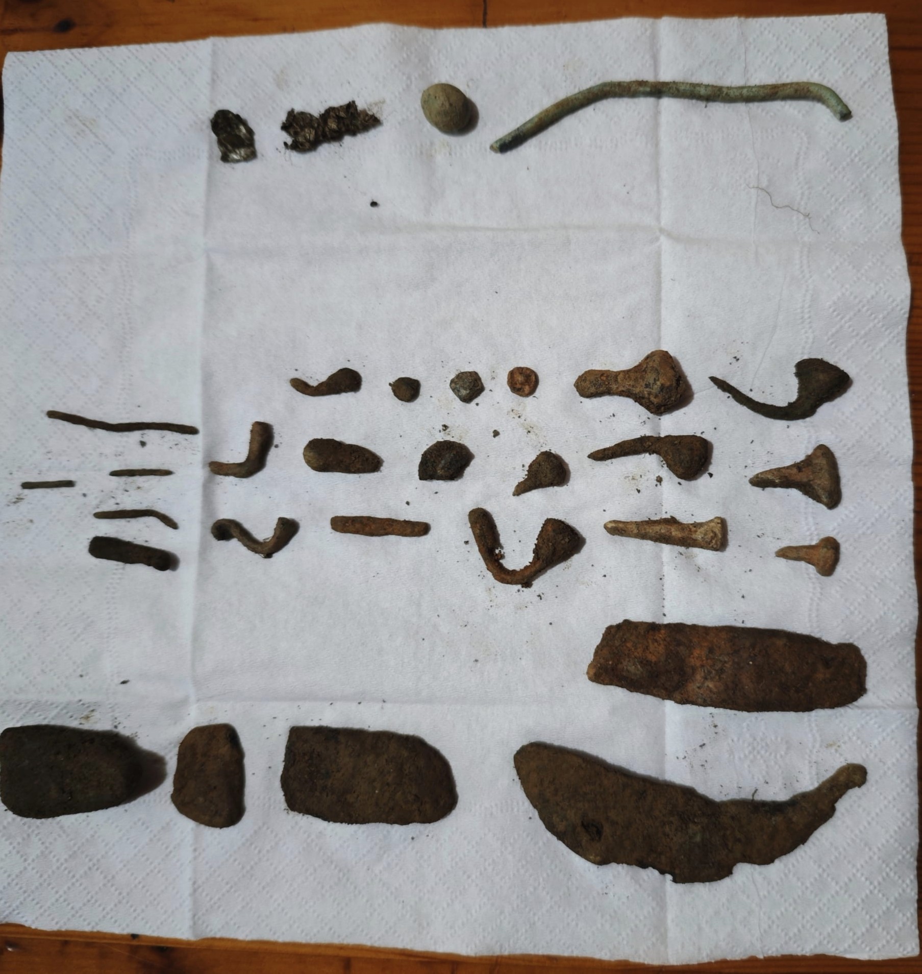

                    Hello Ivconic...in order for modern detectors to detect masked targets...and detect in mineralization...they must use higher frequencies, and they must also be set to the so-called "soft discrimination" of objects..this means that certain types of iron and iron objects will appear as non-ferrous targets...in a significantly larger amount than in detectors with "hard discrimination" of iron..
                    The use of high frequencies also helps to effectively detect deeper buried targets such as aluminum foil, so you end up digging up a larger amount of non-ferrous waste..
                    I have been doing real analysis of excavated targets for a long time..where in each detection with the detector used I compare the ratio of excavated iron and non-ferrous targets in relation to the so-called good targets../"hard targets" like coins, pieces of coins or pieces of lead, and lead shot /
                    Furthermore, I also compare the detector's reaction to various targets, as well as the ease of detection and identification of targets..on the audio side but also according to the ease of obtaining the correct VDI signal of the target..especially for small "fixed targets" such as pieces of coins that I can dig up,,,,or also lead shot,,-which I can then reliably eliminate with my VDI type detection..
                    ​For example, I will show detection with D2 on the Fast program, Disc 6.8..reactivity 3 ,silencer 0, frequencies max 40.. on terrain strongly overdetected by other detectors,, among others ORX and D1.. on various frequencies..
                    This old stone narrow road is very demanding on false response from old iron...but it is my testing ground for testing any detector..in terms of detector settings and its effectiveness ..
                    https://youtube.com/shorts/tasBlwYSq4U?feature=share D2 setting in Test field
                    https://youtube.com/shorts/D-V3RHPBziY?feature=share Iron falsing in terain the Test field
                    https://youtube.com/shorts/AqvcPzdbuRM?feature=share Nonferous target...
                    ratio 28 Iron targets to 4 non-iron targets..​
                    • Good job, you did a good job.
                      I think MultiF (as well as Multi-IQ) technology is now slowly showing its flaws.
                      I don't think it's a flaw in the concept.
                      I think the signal analysis code is not well thought out and written good enough.
                      I don't think there is any need to make any changes to the hardware.
                      But it is necessary to make radical changes to the software.
                      I hope the very overbearing and autistic XP "experts" visit this forum and read this.
                      I have a message for them: guys, you made good hardware but wrote flawed software. I don't doubt your knowledge. But I think you were in too much of a rush to get the product to market.
                      DSP must be done better, more inventively.
                      Deus 1 suffered a similar fate too. It was practically unusable until f/w version v3.2 and then things started to improve.
                      I'm currently running v5.21 on Deus 1 and have no complaints.
                      Deus 2 as it stands now, as it is; is pretty mediocre on actual soils.
                      I don't know how it is outside the borders of Serbia, but in Serbia there are many Deus 2 owners and an unprecedented negative odium has been raised around the disappointed expectations.
                      Because Deus 2 doesn't beat Deus 1 right now on our soils.
                      So in my humble opinion; the developers in XP need to do their best and write a much better DSP.
