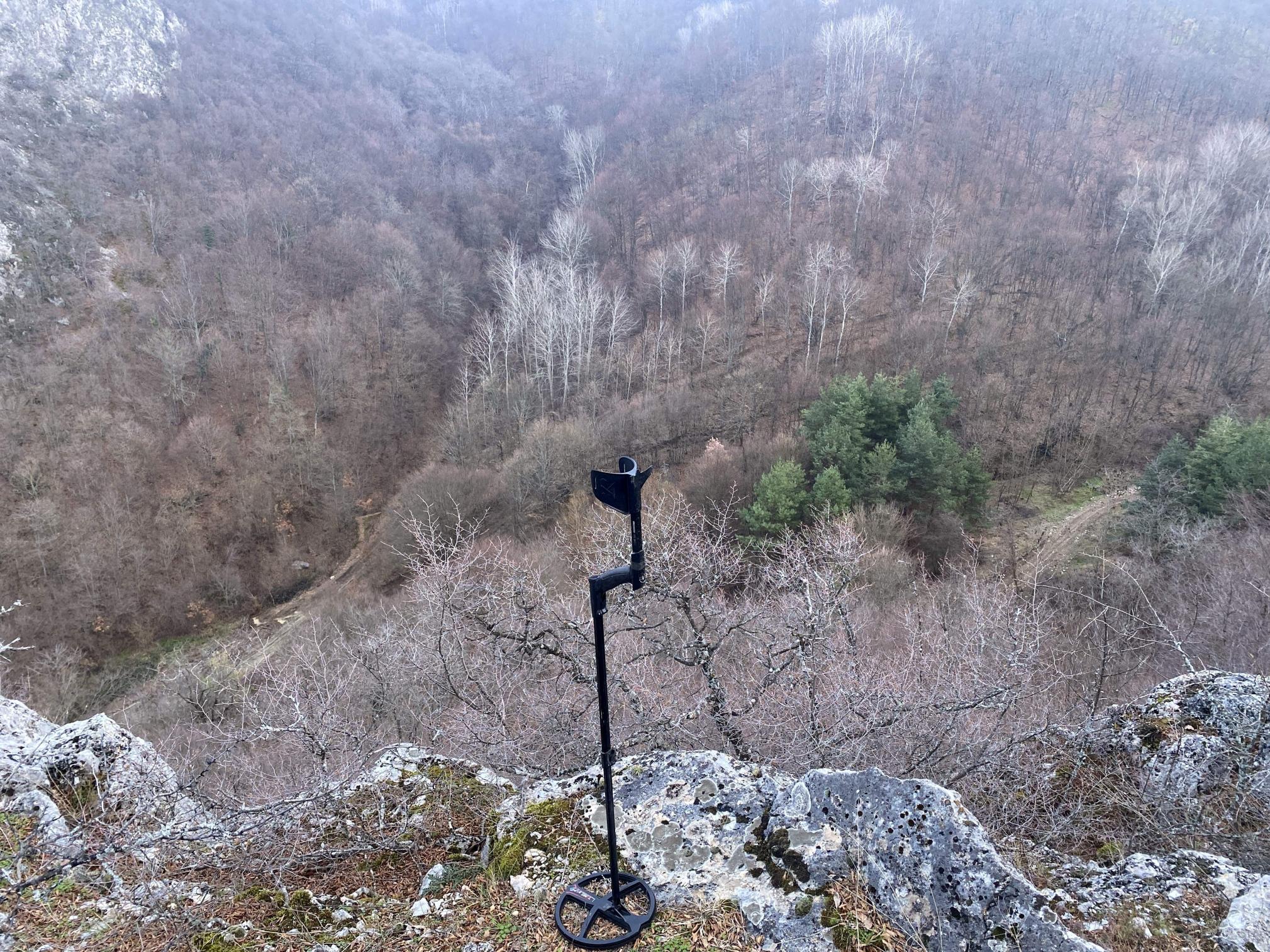

      • Yes, that's how it was 13 years ago with Deus 1.
        I found coins even "where there are none".
        But today the situation is much worse and more difficult.
        Coins do not sprout, because no one plants them!
        Hard times!

                Pretty high..
                And what about the results? ....or observations from the detection?​

                    The good news is that Deus 2 just keeps getting better and better. In other words, my handling with it is getting better and better.
                    I noticed one thing. And this is very important for as many people as possible to read, especially XP Deus 2 owners.
                    Settings in the room and "performance" in the room are one thing, but in nature is quite another.
                    Everything that I preliminarily set up in the room and made in a couple of programs; proved to be incredibly bad on the field!
                    Then, on that terrain from the photos, I dedicated an hour to setting it up on real soil and on real targets, both wanted and unwanted... and Deus 2 shined!
                    Only then did it show all it's quality! I'm overjoyed!
                    On that hill I found with it 17 very deep coins. I'm sure Deus 1 wouldn't be able to locate even a third of that.
                    • Ivconic ...That's a very good result.... in my opinion, multifrequency..does what it's supposed to do...correctly..

                        ​In my opinion, room settings/laboratory tests/..would only work in clean sand, or in non-mineralized terrain...where the influence of mineralization and terrain conductivity would be eliminated,,which is not our case...
                        But laboratory tests are also important -mainly for assessing the theoretically maximum technical possibilities of the detector..which we can achieve with a given program and detector settings..and which can be practically achieved -in a similarly ideal terrain...
                        This also shows how in Real and old terrain...we have to adjust the laboratory settings to set the detector that best adapts to the given detected terrain...
                        A certain help in finding the right setting for such terrain,,can be.. .for example, a reasonably large box with a sample of the terrain on which we are detecting..
                        I quite often do the so-called reverse simulation of a detection situation that I experienced...in a given terrain ..which I will convert into a synthetic test...​
