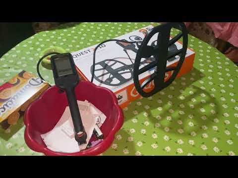

      • The "collateral damage" of the Deus 2 sales story is the windfall of this detector.
        What to say?
        Quest still maintains a very good quality of its machines and each new series brings some nice and good innovations.
        This time there are more good things.
        It's hard for me to evaluate this machine and put it on a list; because I didn't have the opportunity to go out on the real field with it.
        But first the superficial impressions are extraordinary.
        For that money, how much does it cost; offers a lot indeed!
