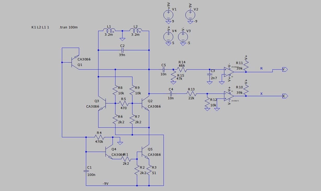

      I put together this circuit in the sim. It seems good.
Name:	Phase shift.jpg

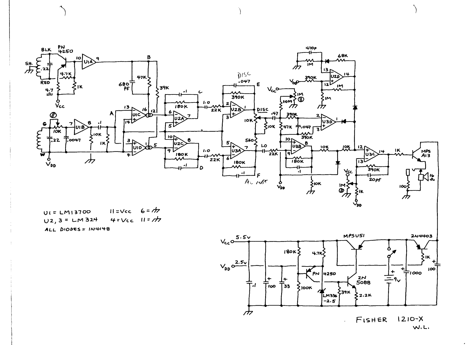

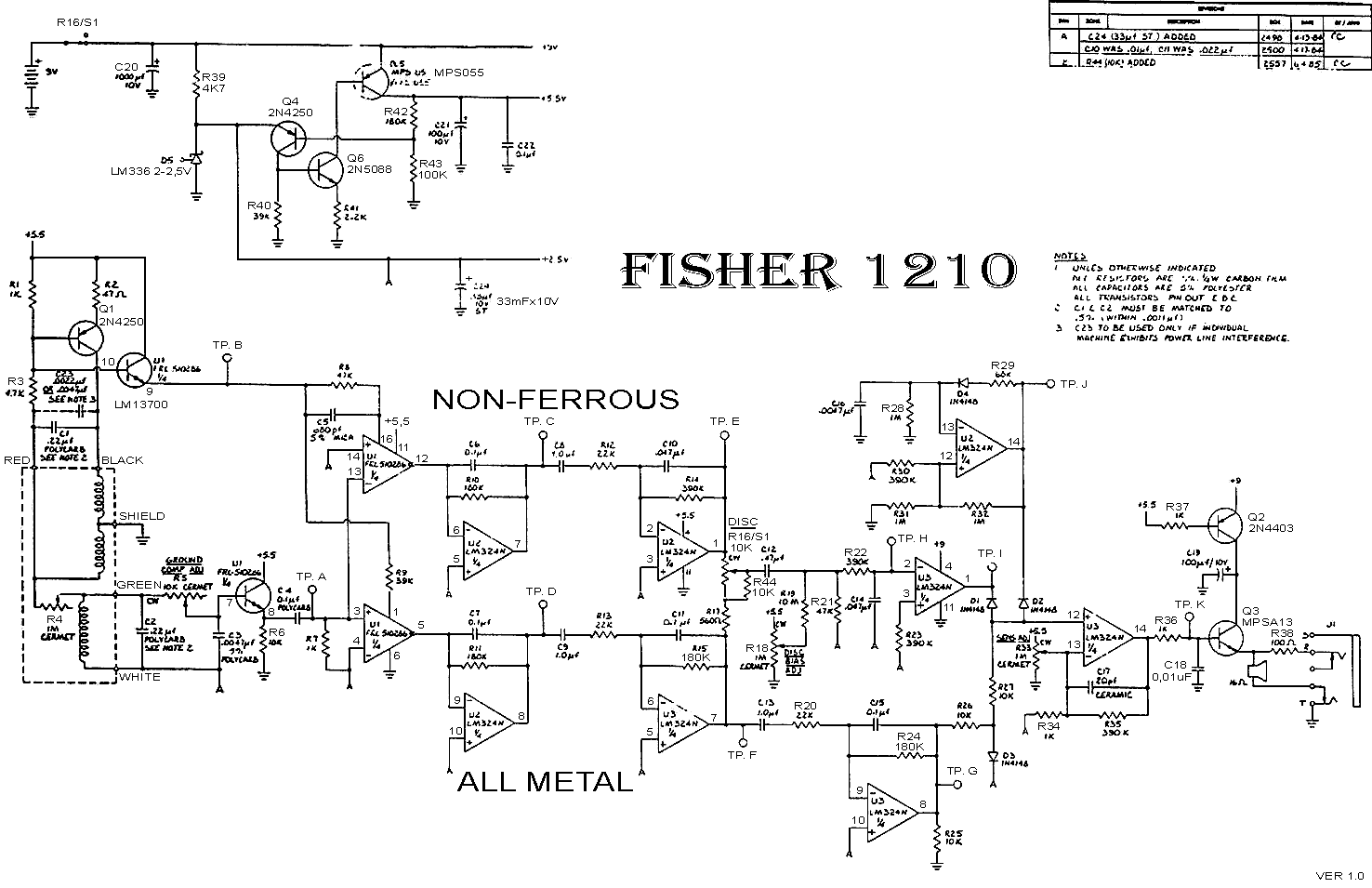

                Some years ago, I did weld up a 1210x circuit, but I never got it to work properly. It detected metal sure enough, but try as I would have, I could not get it to discriminate. I made it according to these diagrams which do not show a grounded centre-tap on the Rx coil. Was the centre tap grounded?
                Click image for larger version  Name:	fisher 1210_sch.gif Views:	0 Size:	43.9 KB ID:	428296
                Click image for larger version  Name:	Fisher_1210-X_sch.gif Views:	0 Size:	123.3 KB ID:	428297
                  No the center tap was a short loop twisted and tinned taped to the plastic. The 1210x was a quirky circuit. It did not have a all metal or pin point mode. It was not a sensitive detector. So maybe that's how it got away without shielding? The winding's were contained in a vacuum formed insert that fit inside the standard coil housing and were potted with clear epoxy. You could see the rx center tap. Unfortunately there were no digital cameras in the early 1990's that were affordable.
