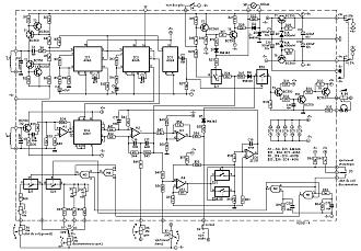

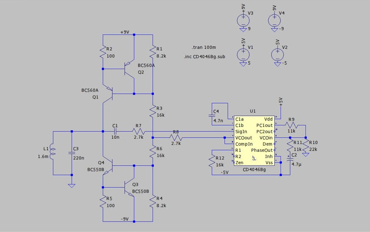

    Why no oscillation. I can't seem to make it work as drawn. I include everything required to run simulation in zip file.

    4046's are trouble in real life, so probably are in simulations, too.
    Does R10 go to ground , or -5V ? Just a thought...
    Does SigIn need protection, like two diodes clamping it to +5V / -5V ? Seems you may be feeding it with more volts.
    It may be an idea to split the circuit up. Get Spice to feed in a sine-wave sweep directly into the coil drive circuitry, and see that it actually drives the coil, showing the resonance on the LC circuit. About 3.5 V rms into R8 would be about right.
    Then force the 4046 VCO to mid-range ( input to 0V ) and get it to produce whatever the LC circuit tuned to . Then try closing the loop.
      I don't see how this circuit will work. The overdrive clamps (Q2,Q3) can never turn off.

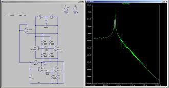

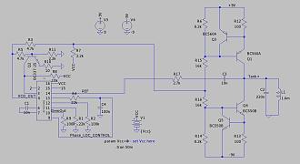

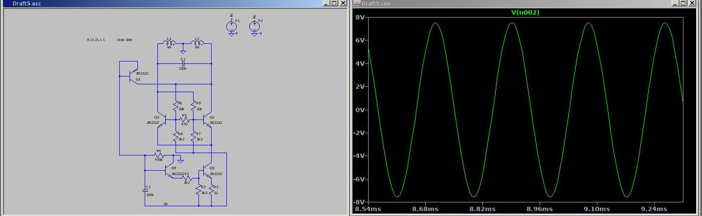

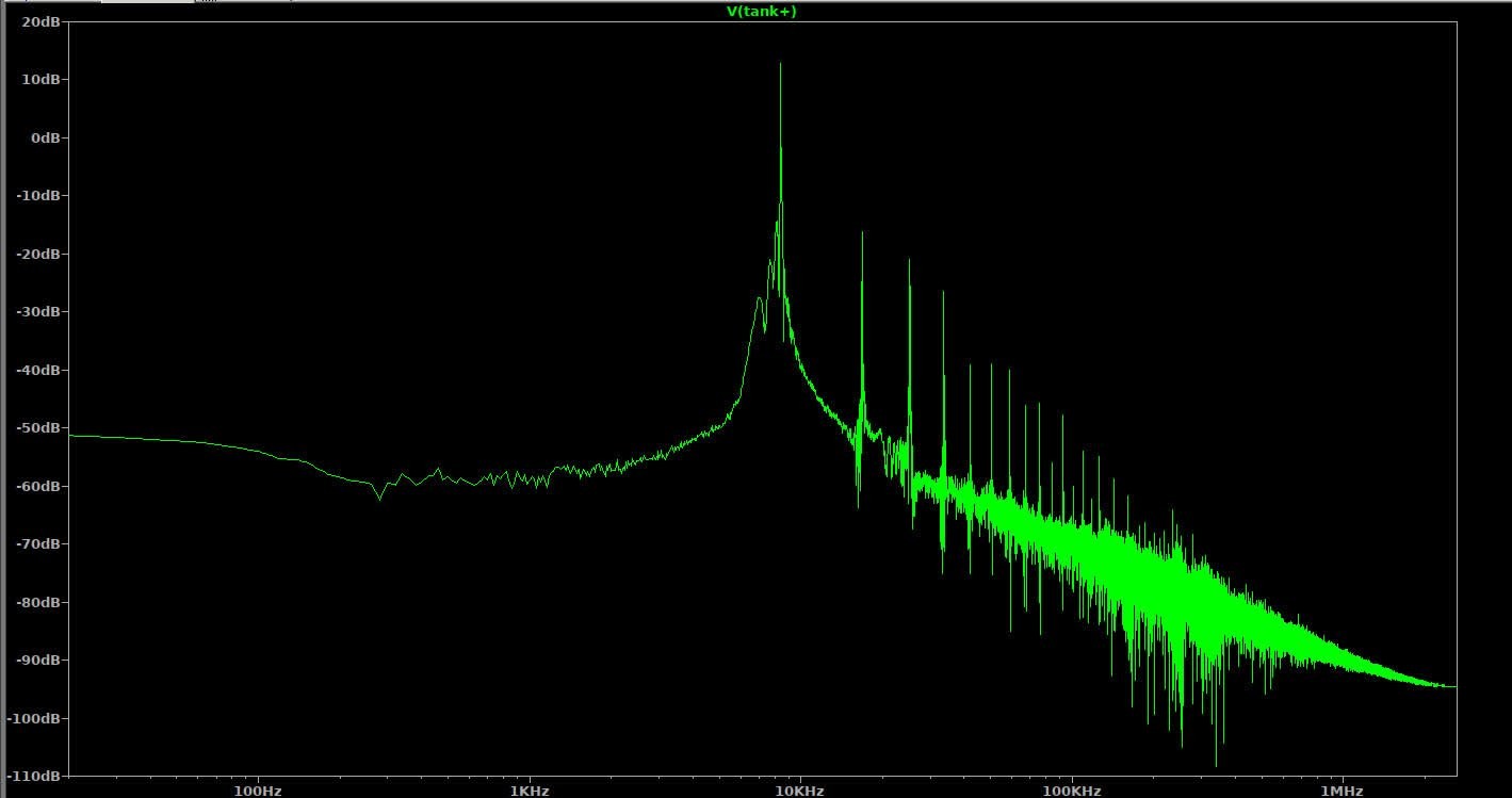

        It appears to work. I found a simulation and took a part of it.

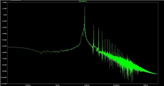

            It Is working with or without Q2 and Q3.
              Perhaps now to add flip flop quadrature.

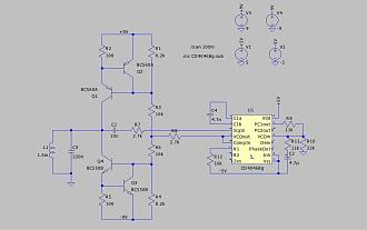

                Are you running this with a CD4046 ( regular 4000 series ) or a 74HC4046 ? ( 5V TTL type ) ?
                They aren't the same, and clearly the PSU requirements are different.

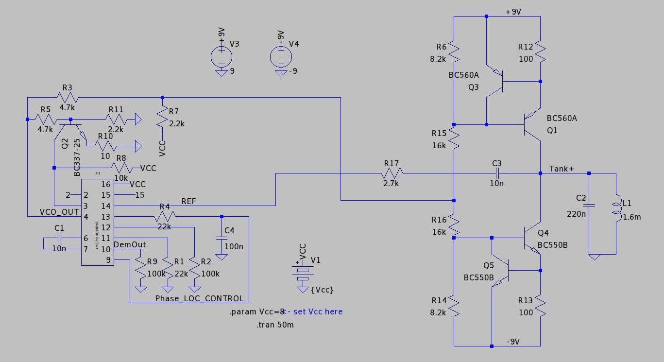

                Gotta be suspicious about the original schematic, with the resistor value of 100R incorrectly shown on the TX drive ( R6 ). What else is wrong??
                      Click image for larger version  Name:	Elektor_SHT1.jpg Views:	178 Size:	178.4 KB ID:	428241

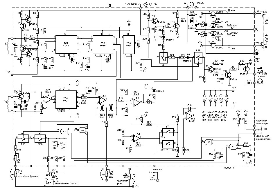

                      I made the Elektor metal detector circuit more than 30 years ago. It was one of the best circuits in its time.
                        Yes, I did not see that. The 100R is obviously wrong. The original magazine article shows correct values as far as I know. But that's beside the point. Recently while digging through pile of scrap, I found some PLL chips on an old junk board and Elektor's circuit came to mind.

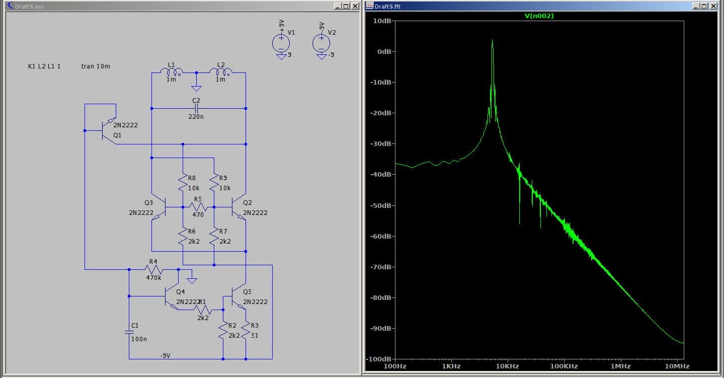

                          This Tx oscillator from Fisher is very good. The second harmonic is way down.
                          Click image for larger version  Name:	Fisher 440.jpg Views:	0 Size:	109.7 KB ID:	428279
                          Click image for larger version  Name:	Fisher Tx oscillator.jpg Views:	0 Size:	83.6 KB ID:	428280
                            I just happen to have a CA3086 in my parts bin. The coil looks to be bi-filar wound.
                              I forgot to include coil resistance in my sim.
                              I found some data on the fisher 440 11inch widescan coil.
                              440 Coil
                              12.6 mh total
                              3.2mh 14.3 ohms per side
