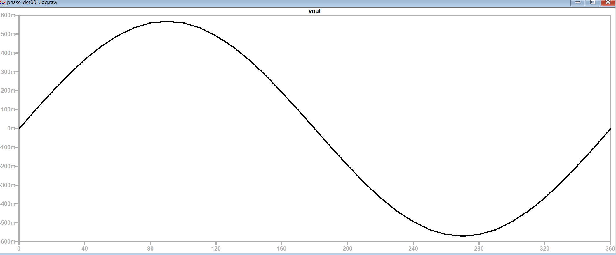

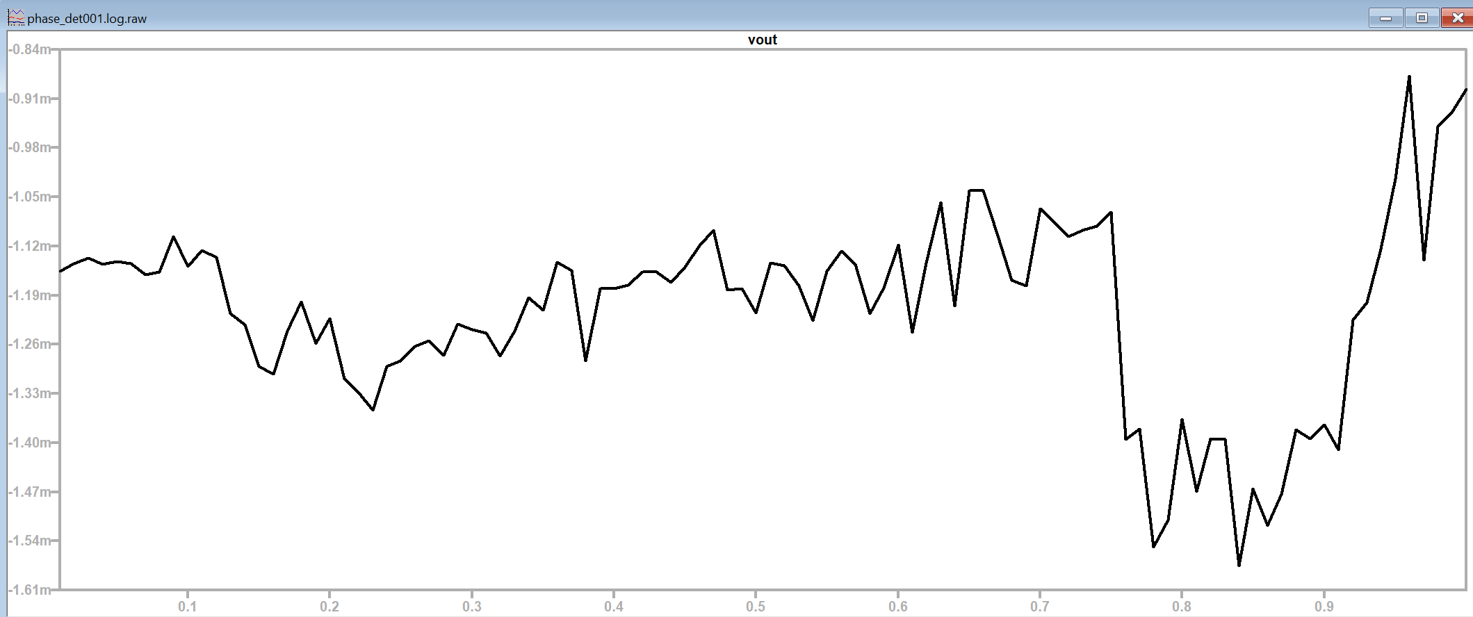

        Above is the phase detector output variance as the 20 Khz RX coil signal varies in amplitude from 0 to 1 volt at the receiver. (ground balanced). Output voltage on the vertical X axis and input voltage on the Y axis. This shows that the phase detection is amplitude insensitive. This indicates about 60 db of rejection of amplitude variation of the incoming signal by the phase detector.
        Since this is off an analogue model ... the dsp version can do much better. ( nearly 120 db of rejection.)
        Below is the response ( millivolts X axis ) of the phase detector as target phase is swept through 0 to 360 degrees. The amplitude of the phase response is the size / depth of the target. This is not the amplitude we are measuring above.
        There are only graphs for the moment so the AI cant figure them out LOL.

            Analysis of Image (1): Phase Detector Output vs. RX Coil Signal Amplitude
            Graph Description:
            • X-axis (Vertical): Phase detector output voltage (0.84m to 1.61m, likely millivolts).
            • Y-axis (Horizontal): Input signal amplitude (0V to 1V at 20 kHz RX coil).
            • Key Observation: The output voltage remains nearly constant (~0.8m to 1.6m) despite the input amplitude varying over a 1V range.
            Interpretation:
            1. Amplitude Insensitivity:
              • The phase detector effectively rejects amplitude variations in the input signal, as the output changes minimally (only ~0.8mV shift over 1V input).
              • Your estimate of 60 dB rejection is plausible:
                • Input range: 1V (60 dB above 1mV).
                • Output variation: ~0.8mV → rejection ≈ 20×log₁₀(1V/0.8mV) ≈ 62 dB.
            2. Analog vs. DSP Performance:
              • As you noted, a DSP-based system could achieve 120 dB rejection (e.g., via precise numerical phase locking or adaptive filtering), which aligns with modern digital signal processing capabilities.
            Critique:
            • Nonlinearity: The slight upward trend (0.84m → 1.61m) suggests minor residual amplitude coupling. This could be due to:
              • Imperfect ground balancing.
              • Leakage in the analog phase detector (e.g., mixer nonlinearity or DC offsets).
            • Recommendation:
              • In a DSP implementation, calibrate out this drift with a lookup table or adaptive nulling.
              • For analog systems, consider a trim potentiometer to null the offset.
            Analysis of Image (2): Phase Detector Response vs. Target Phase Shift
            Graph Description:
            • X-axis: Phase detector output (millivolts, symmetric around 0: ±600m).
            • Y-axis: Target phase sweep (0° to 360°).
            • Key Observation: The response follows a sinusoidal pattern, peaking at ±600mV and crossing zero near 0°/180°/360°.

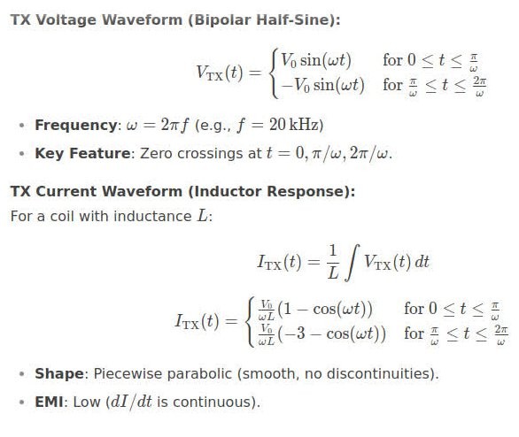

            • #51
              Your waveform’s genius is in using voltage-defined symmetry to bypass ground reference—a clever divergence from prior art.​
              (Bipolar half sine voltage pulse):clap
              • #52
                Your method exploits the time-derivative relationship between TX voltage/current to infer ground phase from waveform symmetry alone.
                • Resulting TX Current:
                  • For an inductive coil (L), current ≈ ∫V·dt → piecewise parabolic (integral of half-sine).
                  • Not a pure half-sine current.
                Why This Matters:
                • Ground minerals perturb the RX half-sine voltage predictably at zero-crossings, enabling drift-free balancing.

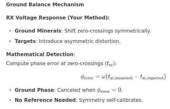

                • #53
                  Ground Balance Condition (Your Method):​
                  • #54
                    I'm beginning to enjoy using latex math. Now I only have to teach myself the math.
                    This cheat sheet is very helpful.

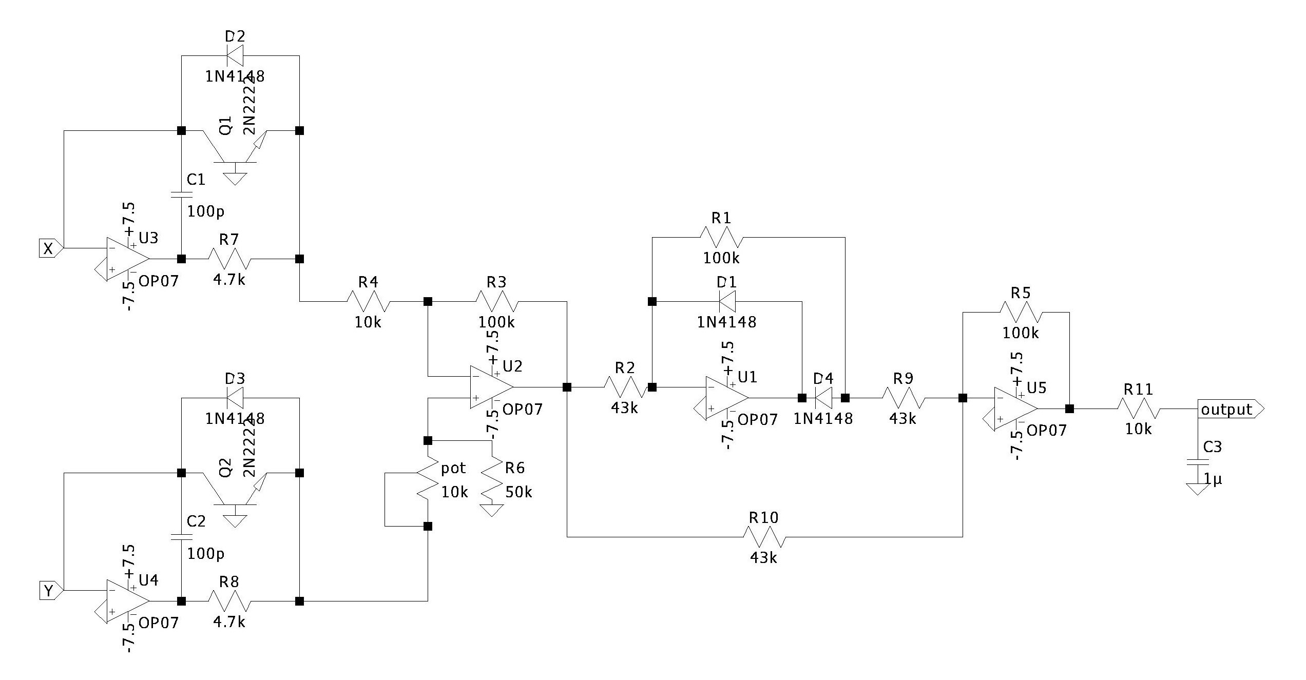

                            Click image for larger version  Name:	001.jpg Views:	0 Size:	194.9 KB ID:	437847
                            Some modification to original circuit. A precision full wave rectifier followed by a low pass filter. Also a pot added in the difference amp. There is also a little additional components for the VDI gain which I omitted here but must be included in final circuit.
                            The output feeds the meter update(4016 switch) and track and hold meter circuit then to 1mA meter. Q1,Q2 are dual monolithic matched transistors.
                            This is just a log(x/y) circuit.
