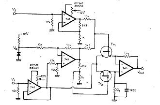

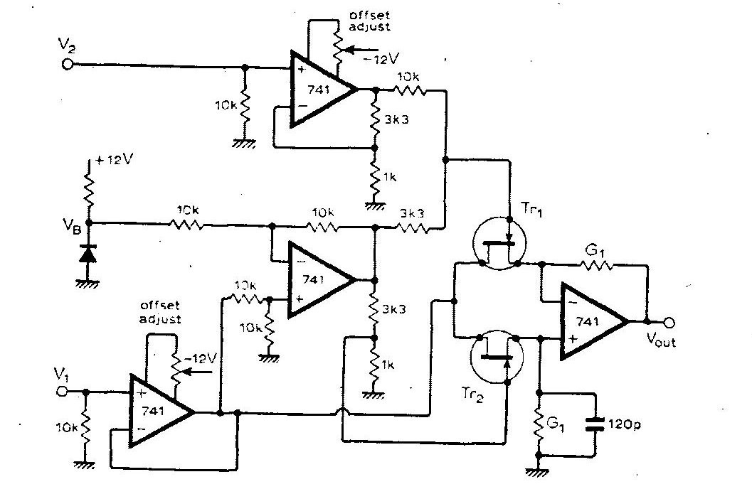

    Would this circuit topology work for such a task. In this circuit, Vout is proportional to V1*V2. The F.E.T's conductance are matched to within+\-5%
    Can the circuit can be tweaked for X and R channel inputs to give target information.
    What do you think? This circuit is featured in Wireless world Circard collection 1978. All the relevant math is there.
    Click image for larger version  Name:	128.jpg Views:	0 Size:	99.1 KB ID:	437143
    I think you need some kind of division function to get a target vector. Multiplying X x R does not let you know which is greater or lesser. One of the early Tesoros used a analog multiplier IC for target ID. If you look at the datasheet these chips also had a division function that was used. Is there any text description with your circuit?.

            arctan(Y/X) = target ID angle.
            In whites 5900/6000di they do log(A)+log(B) which is the same as log(A*B). I am not sure what is exactly is done in the stage following the summing amp. But after that it goes to the meter via a sample switch.
            In the toltec, RC4200 is used as voltage divider I think, Therefore input pin 8 divided by input pin 5. Pin 4 is the output. pin 1 is also connected via a resistor to VCC. So the math is a little more refined(as per datasheet), but basically that's it. Followed by a gain control stage, then a gated sample and hold before driving the meter.

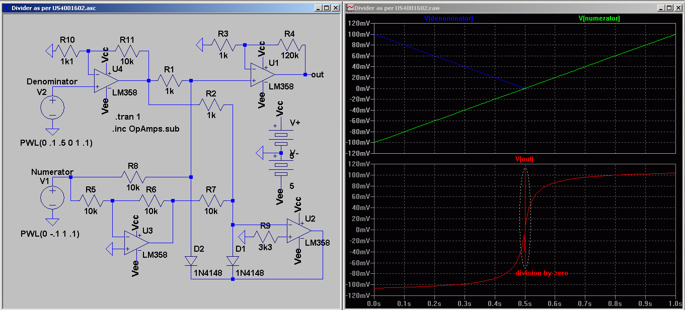

              Then there was this which I found here on the forum. By Davor.
              Click image for larger version  Name:	US4001602.gif Views:	0 Size:	52.0 KB ID:	437214
              Based on some patent US4001602
                so isn't it just a ratio of 2 vector quantities. The angle subtended being the phase of the target, right. or something like that. Just in two quadrants for the purpose of demonstraing the basis.
                  I am sure Skippy can explain the math. Davor's analog divider sim is interesting. I'll bread board it and see if works the same as the simulation.
                    here is the sim file
                    The patent explains the basis of this circuit with the 2 diodes. "Advantage is taken of the current-exponential voltage characteristic of a diode".​

                        Altra:
                        If you're breadboarding this diode-divider, it would work best if you used an SMD double-diode, example BAV70. Better opamps would certainly help ... anything is better than 358's. And 1% resistors in most places, maybe even try and match them in pairs for the obvious locations:
                        R5 = R6
                        R8 = R7
                        R1 = R2
                        R10,R11 are intended to be 9:1 ratio to give a non-inverting gain of 10. Better alternative values would be 2k / 18k or 3k / 27k. But if you want to be faithful to the intended design, use: (1k2 in parallel with 15k) in place of 1k1, that gives the correct 1.1111111k, = 10k divide by 9.

                          I have BAV99's and BAT54's which should be fine. Thanks
                            The BAT54 is a Schottky, is it not? And 99's are series-connected diodes, what's needed is common-cathode, though the circuit could be 'flipped' to work with common anode diodes.
                            Dual transistors would seem like a good idea, just use the base-emitter junction as a diode, and connect the unused collector to the base. Trouble is, they are not monolithic, they seem to be two independent transistors, so not obviously well matched.
                              You are right about the diode configurations, being series connected. I'll just use discrete components to test the theory.
