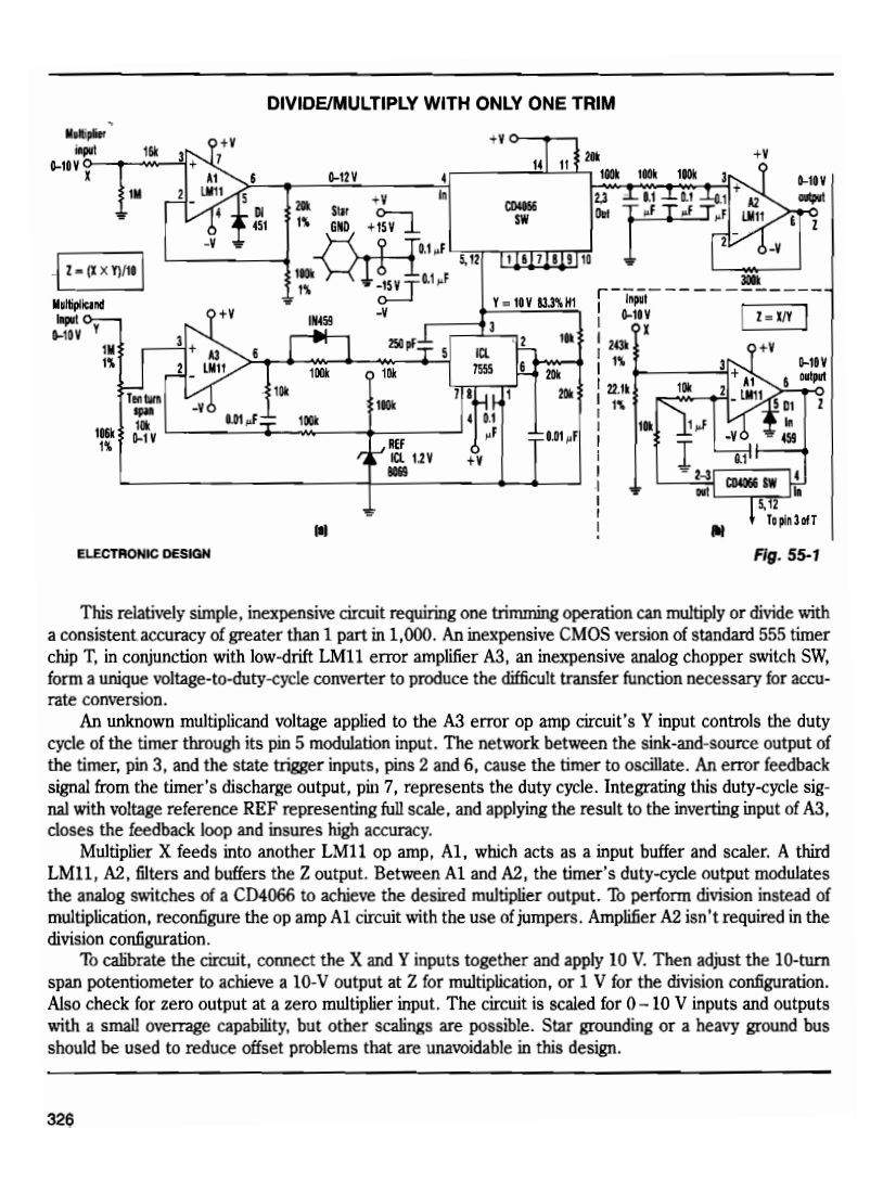

      I've seen what I think is a fancier variant of that 555 circuit elsewhere ... probably in one of those massive Sheets/Graf 'Encyclopedia of electronic circuits' books. I'll try and find it, for interest....
      Here is , pulled from Volume 3 of Graf:
      I think the issue with these oscillator-based circuits is they are generally slow-responding. Good for DC work, but they all have plenty of low-pass filtering on the output to remove the AC component.

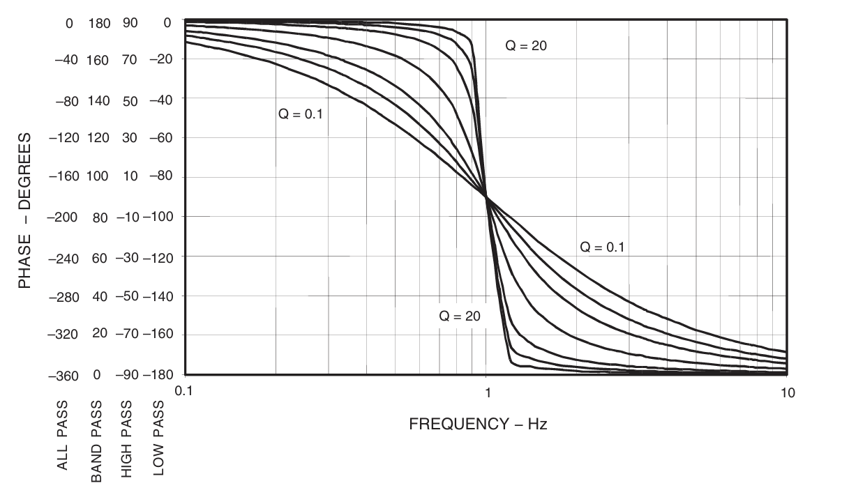

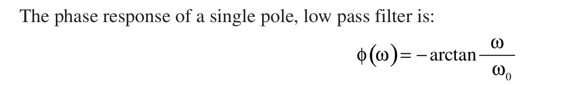

          ... you guys do realise that the phase response of a low pass filter is :
          ... so a simple phase detector ( AKA mixer ) and low pass filter
          properly implemented calculates the arctan without all this falaffel about multipliers and dividers.

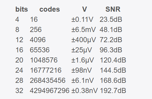

                        ...you dont need log amps or rocket scientists or herb gardens.
                        Years ago log amps were essential items in things like spectrum analysers etc.
                        However since the advent of high resolution ADCs ... log amps are no longer used as the dynamic range of even mediocre ADCs exceeds the best log amps. ( except maybe at GHZ frequencies )
                        Eg a common as dirt 12 bit ADC can resolve better than 70 dB of dynamic range in a 3.3 volt span input signal.
                        However the real meaning of post #19 is that the so called "state of the art" use of IQ demodulators in metal detectors is actually wrong and a misapplication and actually renders the VLF detector to be less sensitive than it could be.
