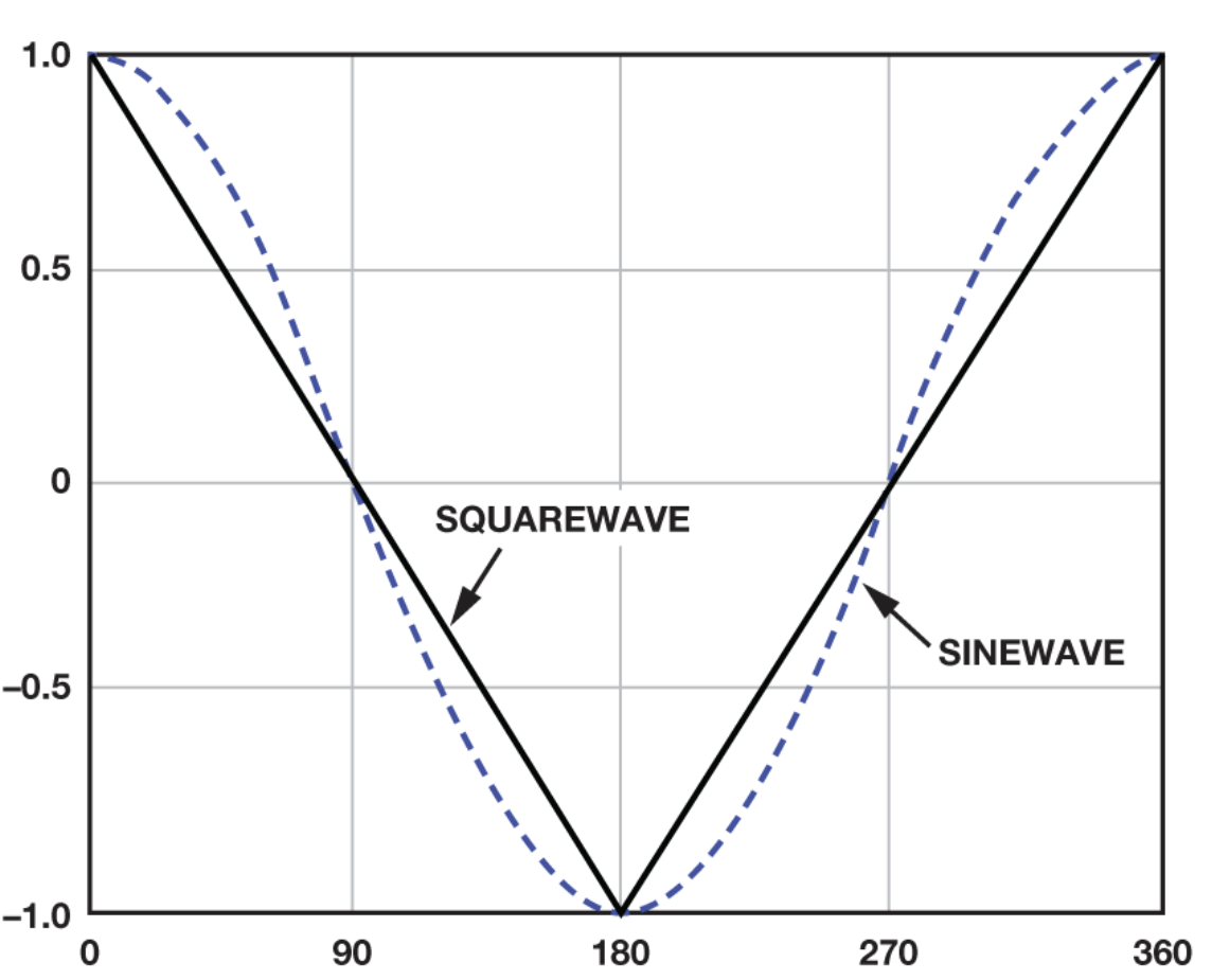

              The fundamental reason ( in addition to other issues ) .. with IQ demods is this.
              Below is the phase response of a phase sensitive detector at a single frequency. In an IQ demod you are combining two of these. The IQ detector quadrature signal is to ensure a "zero beat" or cancellation cant occur on the incoming signal. However cancellation is exactly what we want .. we dont want the IB leakage.
              The lack of sensitivity / depth in IQ detectors is due largely because the IQ demod is demodding the IB leakage carrier which is swamping small target signals. ( having a different phase but the same frequency as the IB leakage ).
              When you use only a single synchronous detector ( homodyne LOL ) ... then you can zero beat the IB leakage carrier thus effectively cancelling it near the dv/dt=0 point and now any phase disturbances will be due to weak targets that would be masked / swamped in an IQ demod.
              So only a single mixer ( aka phase detector ) is required to cancell the IB leakage carrier since we have the transmit carrier reference.
              At zero beat when there is no target dv/dt = 0 ie 180 phase shift degrees as per graph below. .... when there is a signal dv/dt will be something dependant on target phase shift ...but not due to IB leakage.
              This enables a detector which is more sensitive than a PI simply because it has a much better SNR. ( ie the TX never turns off )

                          I think it will come down to this ... you have not been able to explain to me why an IQ demod is better than a single demod since the magnitude and phase of a signal can be perfectly determined using a single dmod when the transmit reference frequency and phase is also known. Its called synchronous demodulation.
                          If you have a composite phase vector made up of say ground and residual carrier you can do some calculations to determine a solution for the constituent phase vectors.
                          When a new target vector phase comes along you recalculate to determine the new vector constituent. If you can cancel one or more of the "constant" vectors using zero beat then the calculation is simplified.

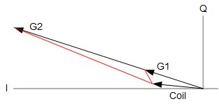

                            In order to use a single demod to determine phase you need to rotate the LO phase until the signal is nulled. This is how the old TR discriminators worked. But when the signal is nulled for phase, you lose the amplitude information and you have to then rotate the LO by 90° to determine amplitude. IQ demods give you both answers at the same time, without the need to rotate the LO. However, you are correct that IQ demods with fixed-phase LOs are not as precise at determining target phase (worst at the 45° points) than if you actually find the null response by rotating the LO.
                            So it seems a best solution is to rotate IQ demods until the Q in nulled; this gives you the phase and the I channel gives you the amplitude. But when you rotate the LO to find the target null, you lose the null on the ground. So you could then run a third demod that always maintains a null to ground (or, more precisely, ground+coil imbalance) and use that signal as the "all-metal" targeting signal. And this is exactly what many VLFs do.
                            Yes, a good phase detector is insensitive to amplitude changes, but it's common for a signal phases to vary with amplitude. Take the case of the coil null combined with ground. The coil null is typically very close to 0° and its amplitude is constant. The ground response is typically at a higher loss angle and its amplitude varies considerably with coil height. The combined responses will therefore vary in both amplitude and phase as you bob the coil over the ground:
                            This is an exaggeration because the coil error is usually tiny compared to ground, and the angles are not so large. But it illustrates that the incoming phase can change with amplitude and even a perfect phase detector can't fix this. It also illustrates why a good coil null is needed.
                            Another problem is that the target phase varies with depth in mineralized ground. The loss angle of the ground alters the phase of the TX signal with depth and then does the same thing with the target return signal. So as targets get deeper the amplitude drops and you also get more apparent phase error. This has nothing to do with the accuracy of the demod.
