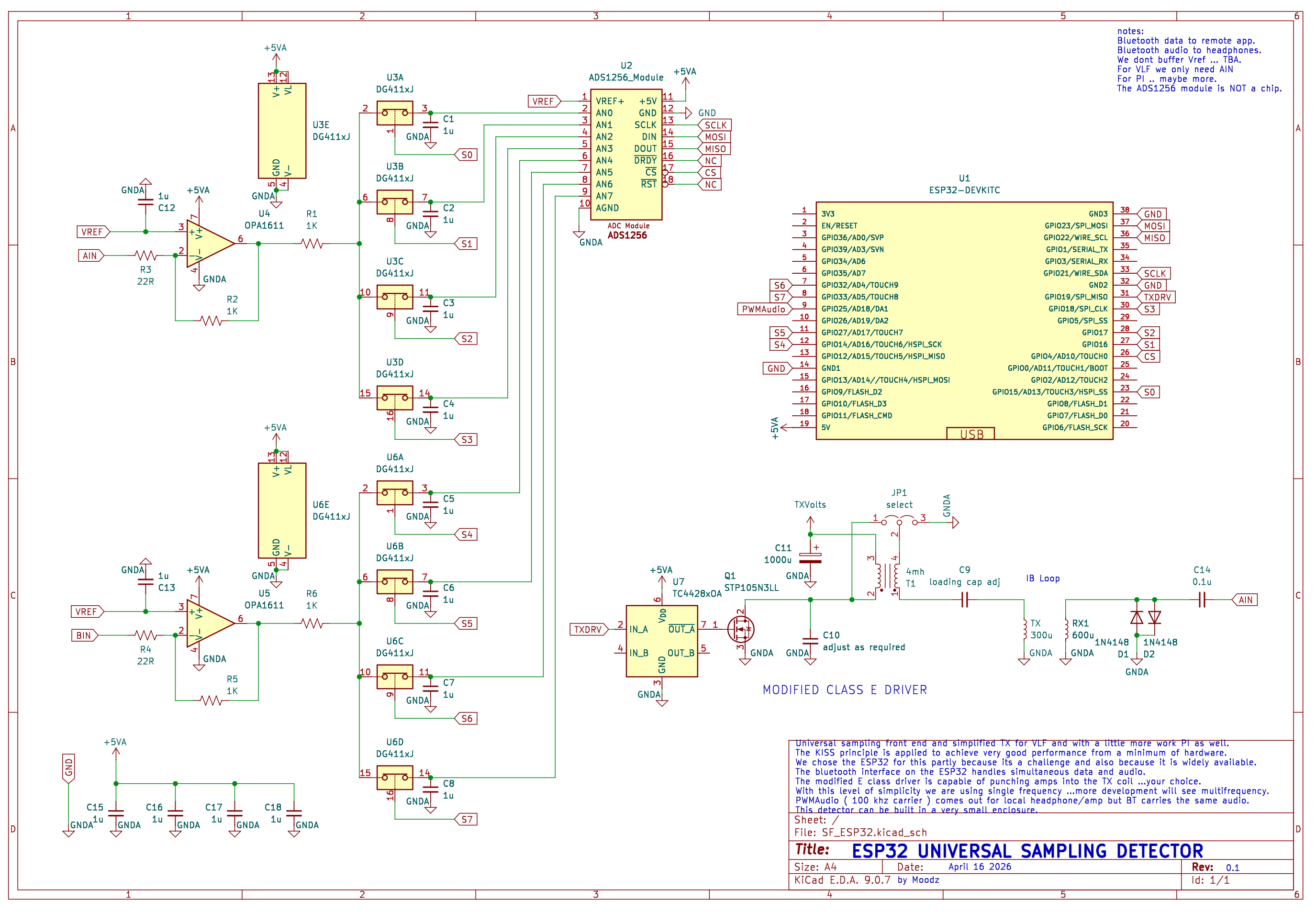

  • Here is the intial ESP32 based schema ...we use an external "best bang for buck" ADC and a tricksy way of getting the IQ for VLF.
    The sampling method can be used for PI or VLF ... just changeout the TX.
    This will also be the basis of MAGPI V4.

    • Ivica to answer your question T1 is found in just about every electronic appliance :rotfl
      • clue 2 ... LOL

        • The ADS1256 ... is very cheap for what it is. It can easily achieve 19.9 ENOB ( thats 20 bits error free ) at 1000 SPS with the software I have developed.
          Modules are available on PCB for around $10 au ... easier than falling off a log.
          Using a switch like the DG411 as the demod 1000 SPS is way above what we actually need to fully extract the I and Q.
          You can power the DG411 class switches upto +/- 22 volts or 44 volts single ended so its rugged.

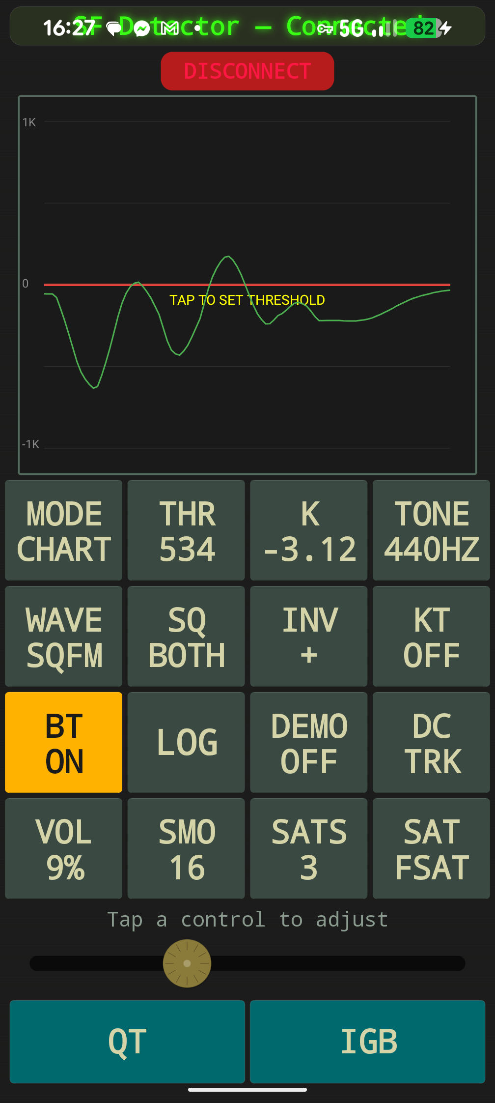

          • Yet another rebuild of the interface ... there are alot of controls on this detector (16+ ) but now focussed on simple military style utility.
            No gimmick screens or wackydoo multiple page ..where is that control gone.
            One screen, one glance, one control ( slider ). Push a button and adjust with slider.
            Big buttons for gloved hands and the current value of that control is written on the button.
            Velcro the display to your sleeve or mount on the control stick. Totally simple.

              I like it Paul!
              Except that I don't understand the "T1"?
              What is its role there?
              :rotfl
                :rotfl
                It broadbands the output .. the load is still tuned but if you go off frequency its not as sensitive as a "standard" E class amp to detuning which causes power loss.
                So you just change one cap to change frequency ...use relays or similiar.

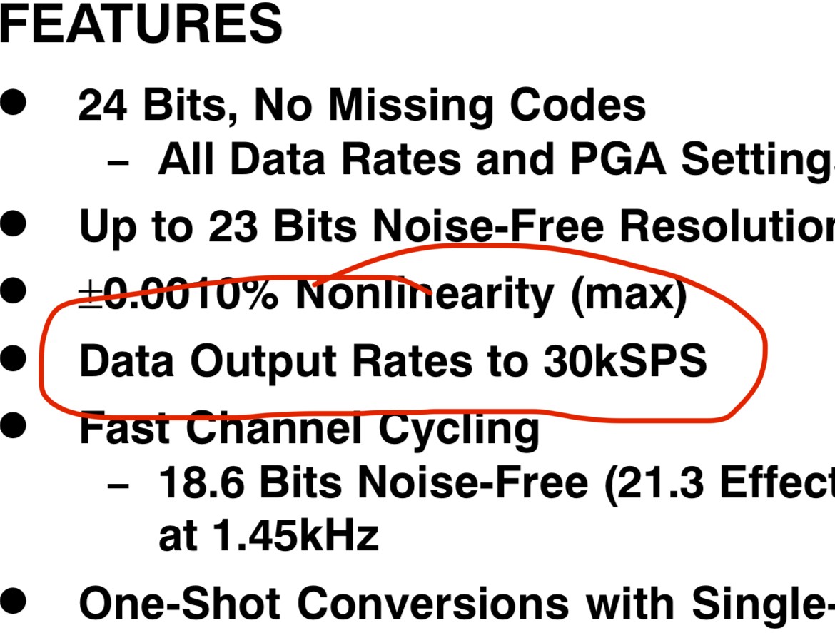

                  Ad1256 It's a very slow chip)))
                  • Originally posted by JoyJo View Post
                    I am using the DG411 switch to demodulate to baseband.
                    Baseband for a metal detector is about 1 hz to 15 hz
                    30 ksps is actually way faster than you need to sample 15 hz.

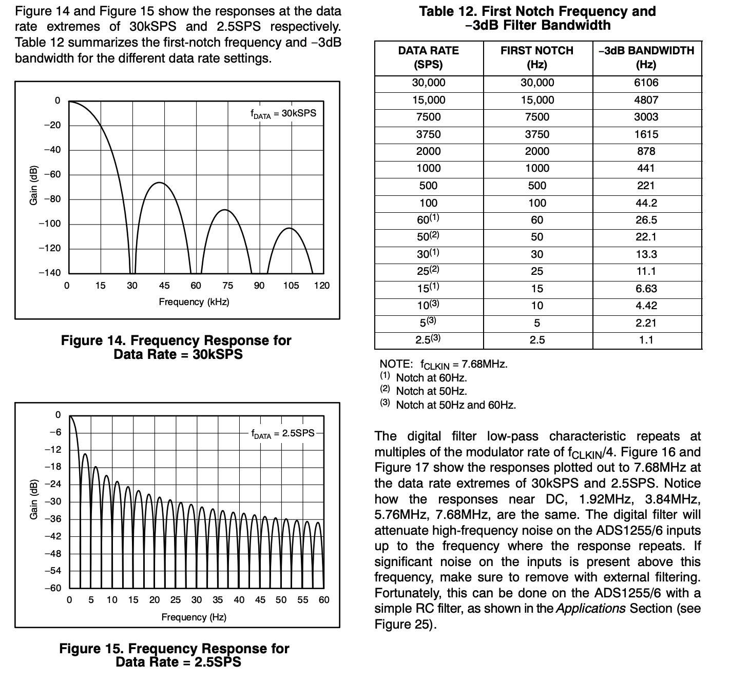

                        Here is the optimal sample rates from the datasheet.
                          By sampling at the optimised rate 4ms (250Hz) or 5ms (200Hz) we can do amaizing things like eliminate mains interference in Rx Coil amplified and demodulated signal for instance.
                          Here in OZ we use 50 Hz mains so my default sample rate is base on that
                          60 Hz is solved also.
                          How

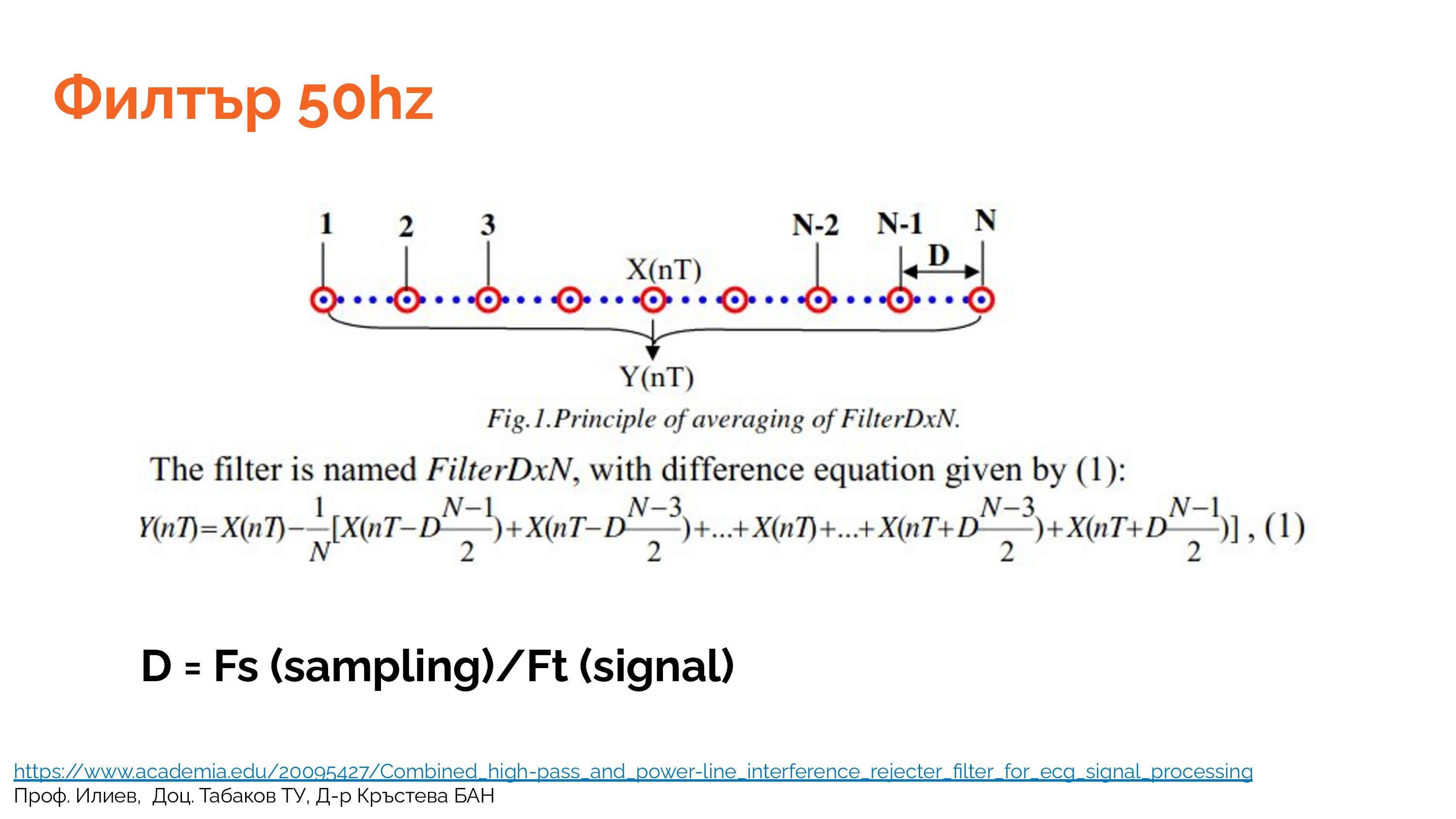

                          The digital filters with integer coefficients are preferable for real-time applications but it is difficult to achieve desired frequency characteristics. In this work we will present one alternative solution of integer-coefficients filter, which provides an adequate high-pass and power-line filtering.​
                          For the effective rejection of the power-line interference based on the simple principle for averaging of samples N with a predefined distance between them D. 50Hz Rejection FilterDxN has a comb frequency characteristic with high-pass cut-off defined by the number of samples N and zeros at the integer ratio of the sampling frequency fs divided by the number of samples D. For a predefined fs, FilterDxN is easily adjusted to different cut-off and zero frequencies only by changing D and N. In this work, we present the mathematical background for deriving the frequency response of FilterDxN, as well as one particular application of the filter, i.e. Filter10x19 designed for fs=250 Hz, high-pass at 1 Hz, zero at 50 Hz. Tests with both standardized and real signals proved that Filter10x19 is capable to remove very intensive baseline wanderings, and to fully suppress 50 Hz interferences with minimal affect on the waveform. FilterDxN would be preferable in systems operating in real time because of its linear filter equation with integer coefficients that hasten the speed of computations.​
                          https://www.academia.edu/20095427/Co...terference_rejecter_filter_for_ecg_signal_pro cessing

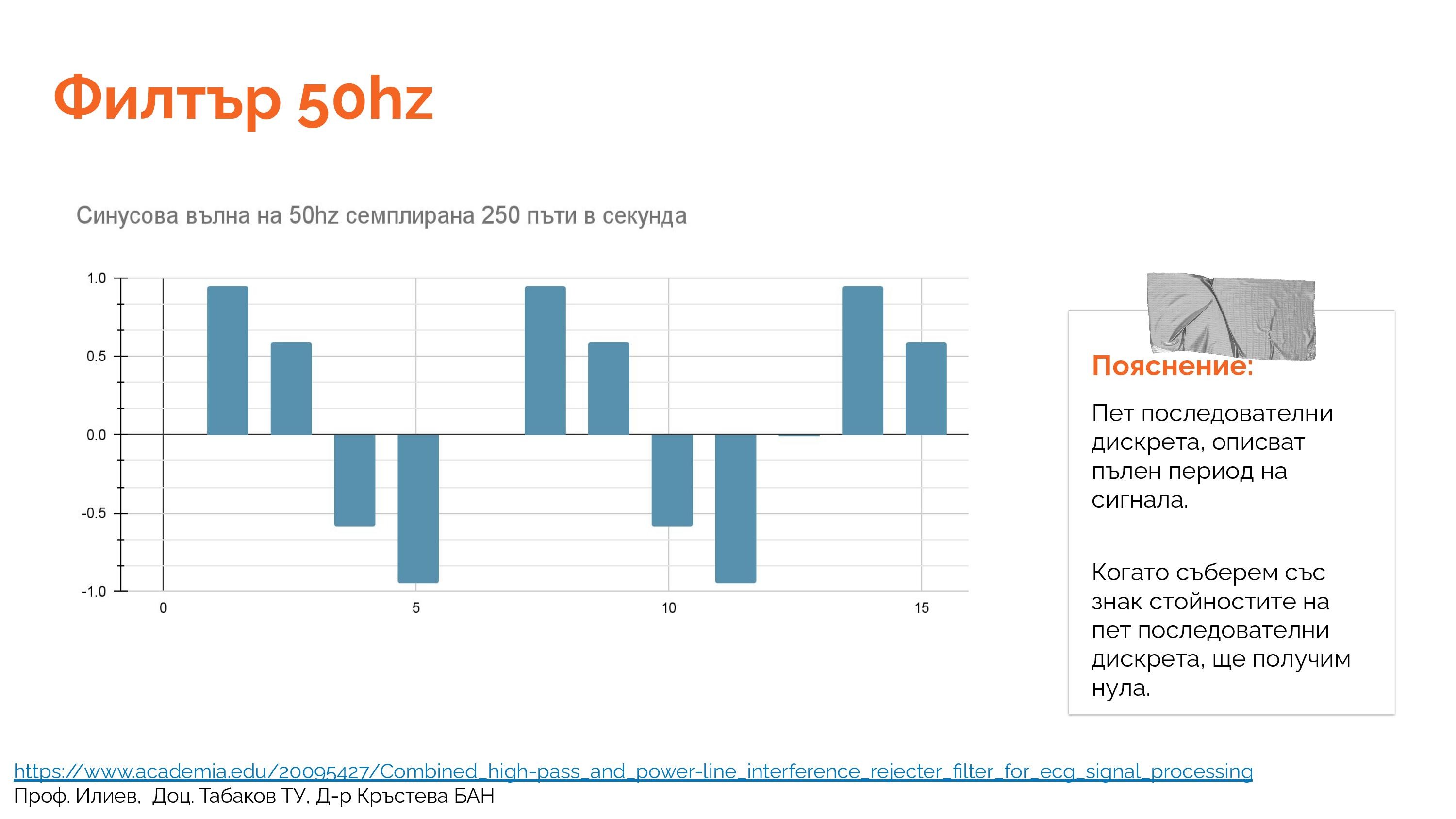

                          250/50=5 Sum(A+B+C+D+E)/5
                          Digital filter design A digital filter with integer coefficients was designed implementing the simple principle of moving averaging of N signal samples distanced each other by 4ms D as shown in Fig. 1. In order to avoid the phase shifting of the filtered signal versus the input signal, the number of the averaged samples N must be odd!
                          N Fig.1.Principle of averaging of FilterDxN. The filter is named FilterDxN, with difference equation given by where X(nT) is the input sample with index n, Y(nT) is the respective output sample. The equivalent z-transform domain equation of FilterDxN is presented in The derived transfer function in the z-domain for FilterDxN is The equivalent transfer function in the frequency domain is By applying the known relationship: , we derive from Equation is the general description of FilterDxN frequency response. From here, we can find the cut-off frequency, the slope, as well as the zeros of the filter. The analysis of the zeros of the filter H(ω 0 T)=0, yielded the equation Since is a periodical function with a period of 2π, we could simplify equation, so that . Therefore, FilterDxN is a comb filter with periodically distributed zeros at each frequency f 0 , which is an integer ratio of the sampling frequency fs to the number of samples D. The analysis of equation shows that for a fixed sampling period T, the frequency response could be easily adjusted by varying both D and N. One example of FilterDxN frequency response for fixed D and different N is presented in Fig.2.​
                          RESULTS The signal processing is implemented in the software package MATLAB 7.0. We focus our analysis on a particular application of FilterDxN for signals sampled at 250 Hz. This is an ordinary sampling frequency preferred in fast and low- power resource systems. Aiming at a zero at 50 Hz, we have 2 possible solutions for FilterDxN, i.e. D=5 (1 st zero at 50 Hz) and D=10 (1 st zero at 25 Hz, 2 nd zero at 50 Hz – Fig.2). For D=5 and D=10 we estimate the low cut-off frequency of the filter and the time for averaging in dependence on the sample number N (Fig.3).​

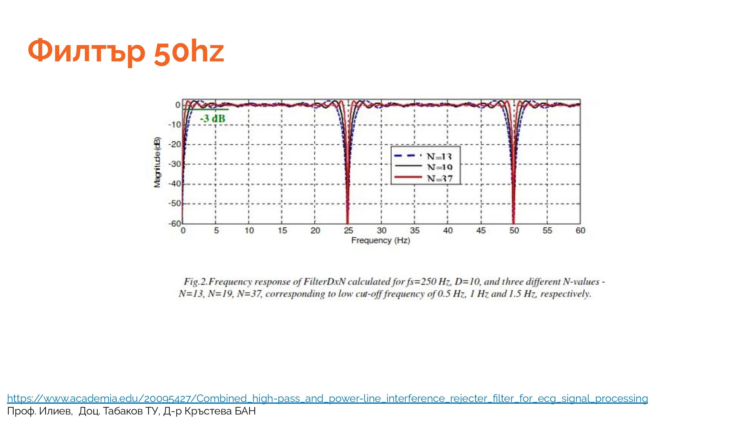

                              I just want to say Just DIY like Carl Say with ADC 250Hz or 4ms delay between sample of the demodulated and amplified signal This is a correct way the Digital Rejecting Mains Filter 50Hz(60Hz) is just a DSP algoritham in MCU.
                              And if You Want to KNow-How or Why You Just Must a learn an Academic Study https://www.academia.edu/20095427/Co...nal_processing with the Bulgarian Scientist of Mathematics who published it on English language.
                              ELECTRONICS’ 2008 24 – 26 September, Sozopol, BULGARIA COMBINED HIGH-PASS AND POWER-LINE INTERFERENCE REJECTER FILTER FOR ECG SIGNAL PROCESSING
                              Ivo Tsvetanov Iliev and Serafim Dimitrov Tabakov - Department of Electronics - Technical University of Sofia 8 Kl. Ohridski str, 1000, Sofia, Bulgaria, e-mail: [email protected]​
                              Vessela Tzvetanova Krasteva - Centre of Biomedical Engineering “Prof. Ivan Daskalov” - Bulgarian Academy of Sciences, Acad.G.Bonchev str. Bl.105, 1113, Sofia, Bulgaria, e-mail: [email protected]​
                              A 50Hz sine wave sampled 250 times per second.
                              Explanation: four or five consecutive discretes describe a full period of the signal. When we add up the arithmetic mean of the values ​​of these five consecutive discretes, we will get zero.
                              If You want the Naked Try this Mains 50Hz DSP Rejecting 'Notch' filter is personaly my idea and we deweloped it in hardware with my homble leading scientist assitent back then in Technical University Varna laboratory togheter but in Bulgaria is a old Comunist Time 1945-1989 long tradition someone other with proper credits they say it "Our Man" to have get Authors Right and Published it in Academic World. And Get ALL IP and Credits for yourself.
