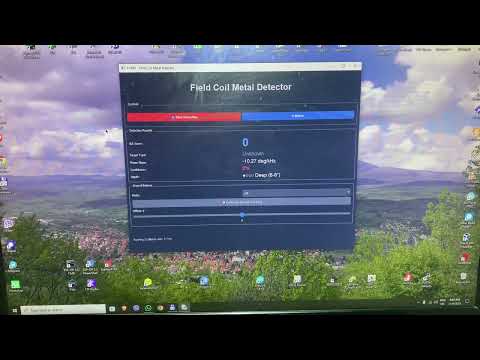

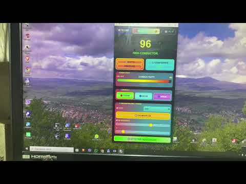

                        Trying to port it... some functionalities are subject to add soon:
                          Speaking of UI... you'll probably disagree Paul, but a twisted mind like me has the idea to adapt the UI to the XP Deus look!
                          :rotfl
                          Part of the functionality to move to ESP32 and make the coil "wireless"!
                          I don't know if I will succeed, there are too many obligations and too little time, the winter days are short, there is too much on my shoulders.
                          But... a port to Python opens up possibilities for further development and experimentation on multiple platforms.
                          I personally don't like Python, I consider it a bad and weak derivative of C++ language.
                          But it is the fastest and easiest for jobs when you don't have a lot of time.
                          I have a couple of older smartphones that have a CTIA (AHJ) jack and it won't be a problem to try your original code.
                          All that remains is to assemble the small TX drive. I have some stock coils, worth testing them.

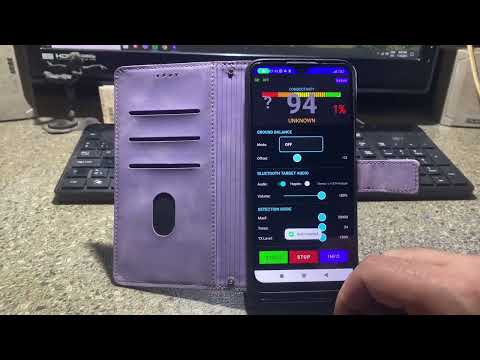

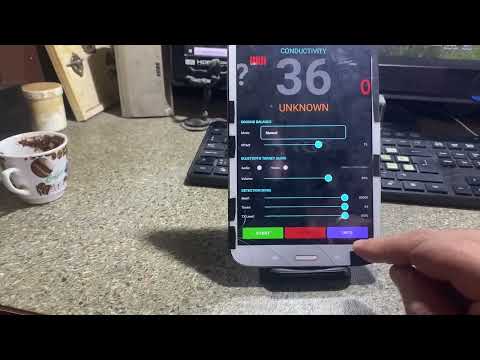

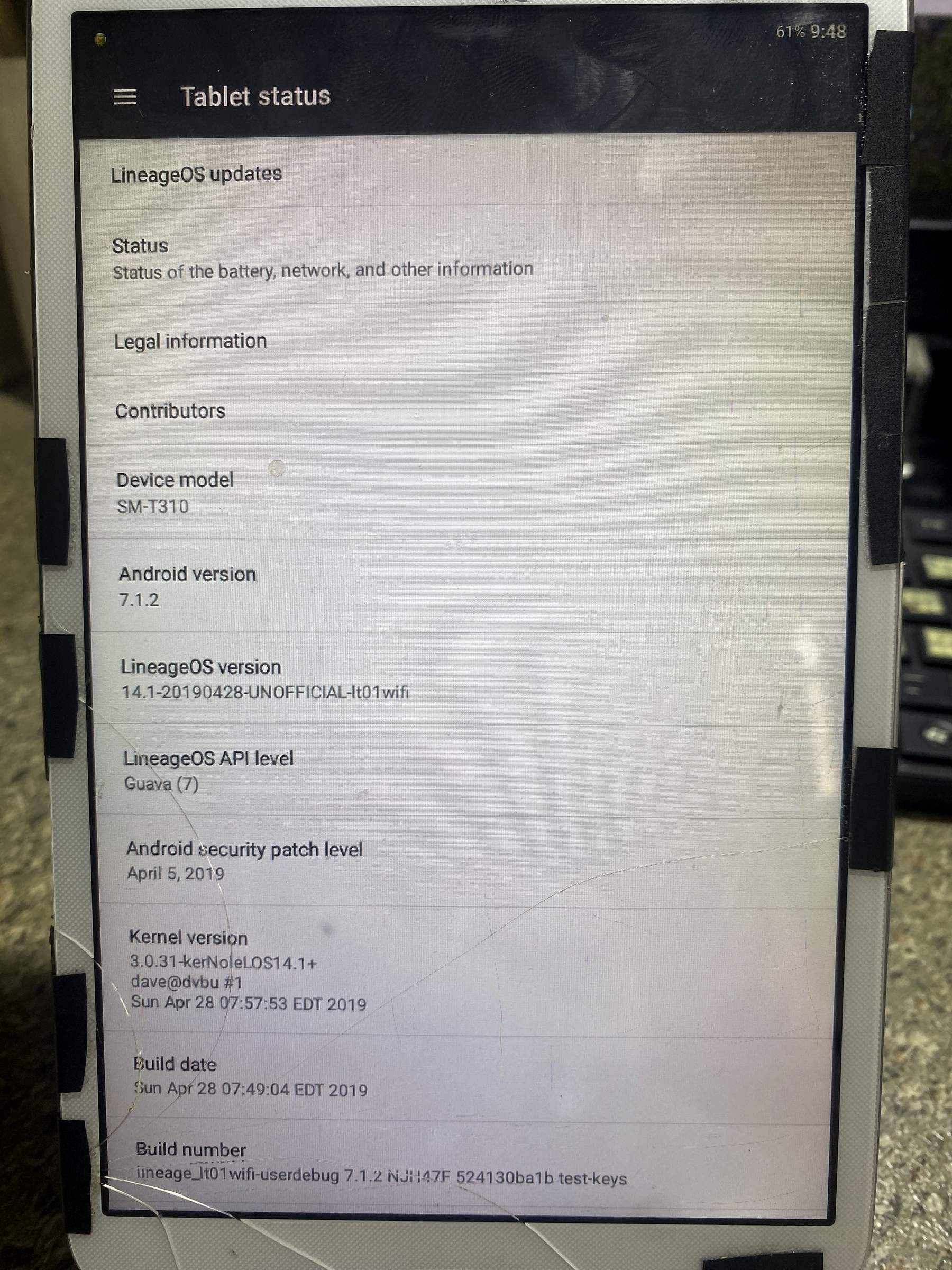

                            That's why I put off making the TX drive and decided to test the APK on some oldies I still have!
                            Never throw away old devices!
                            This Samsung Galaxy Tab 3 was once used by Jesus... and now by me!
                            I installed LineageOS to extend its life.
                            And it's really crazy interesting to test a new apk on a very old device.
                            And ... it WORKS!
                            My congratulations to the author!
                            This is immediate proof of excellent programming (I had no doubts)!
