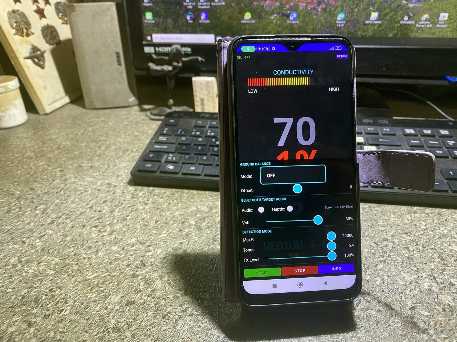

Android Phone Based Metal Detector - FCMD

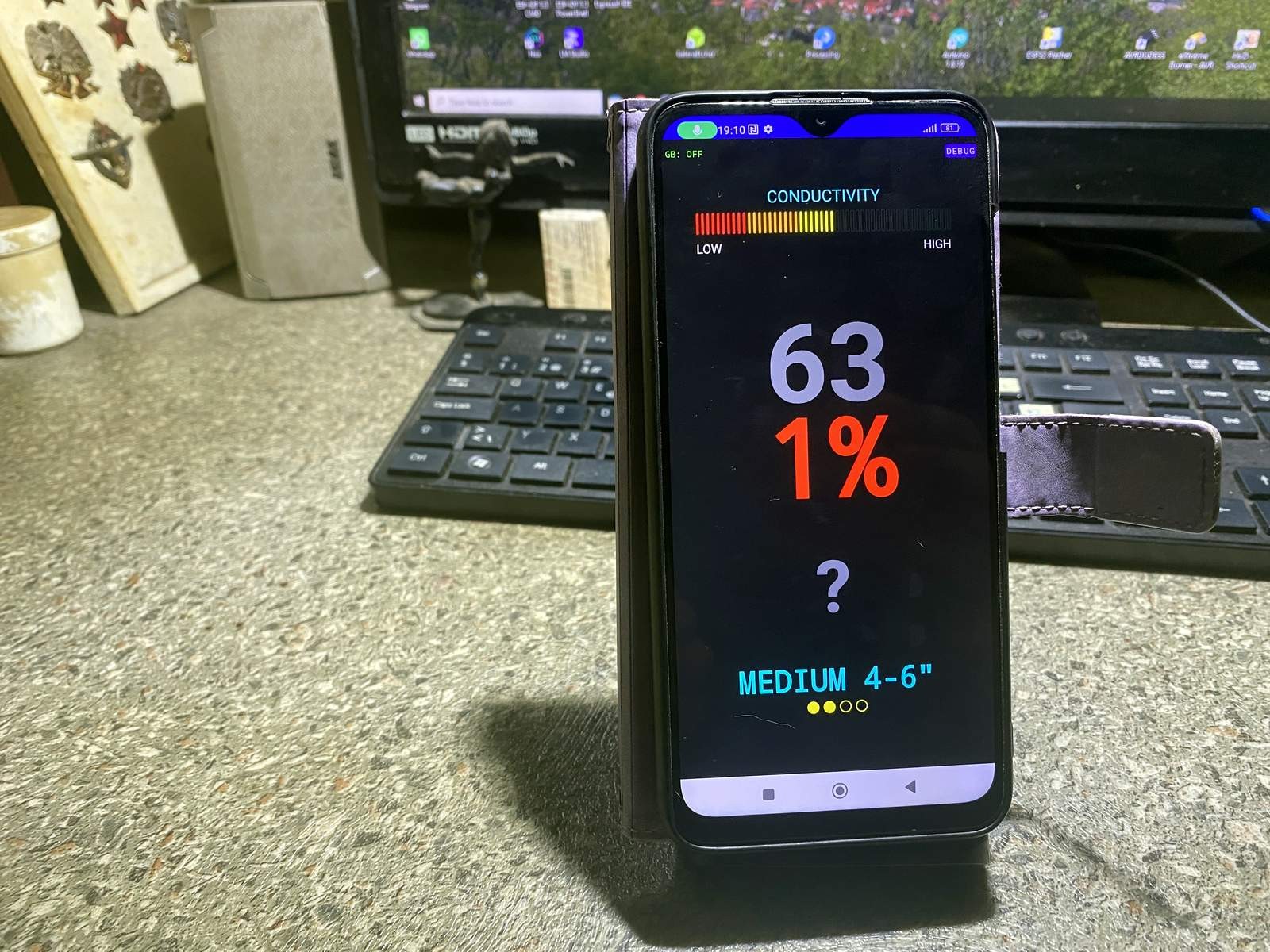

                    Click image for larger version  Name:	IMG_0891.jpg Views:	0 Size:	422.9 KB ID:	442410Click image for larger version  Name:	IMG_0892.jpg Views:	0 Size:	412.0 KB ID:	442411
                    Not that I'm too happy with this solution... but it's certainly more acceptable.

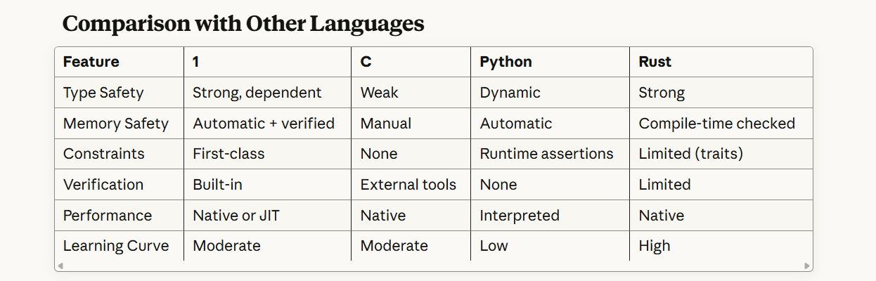

                        Further to the kind of unstated purpose of this project ( developing metal detector code with AI ).
                        I asked the AI what language it would use if two AIs were working together. Somewhat surprisingly it came up with a complete specification for a language simply called 1 ( ie the number "1" )
                        It also told me that because computer languages were written for humans they are somewhat confusing :
                        So the "1" language has implicit defined blocks ( input, output, requirements, implementation ) and all of the syntax code can be treated as program variables ( that means the code can modify itself ... if it wants to )
                        In about 1 hour it developed the complete toolset :
                        Theres a python bootstrap compiler, native compiler, VM, documentation and examples on my github site :
                        Contribute to haxidermist/1lang development by creating an account on GitHub.

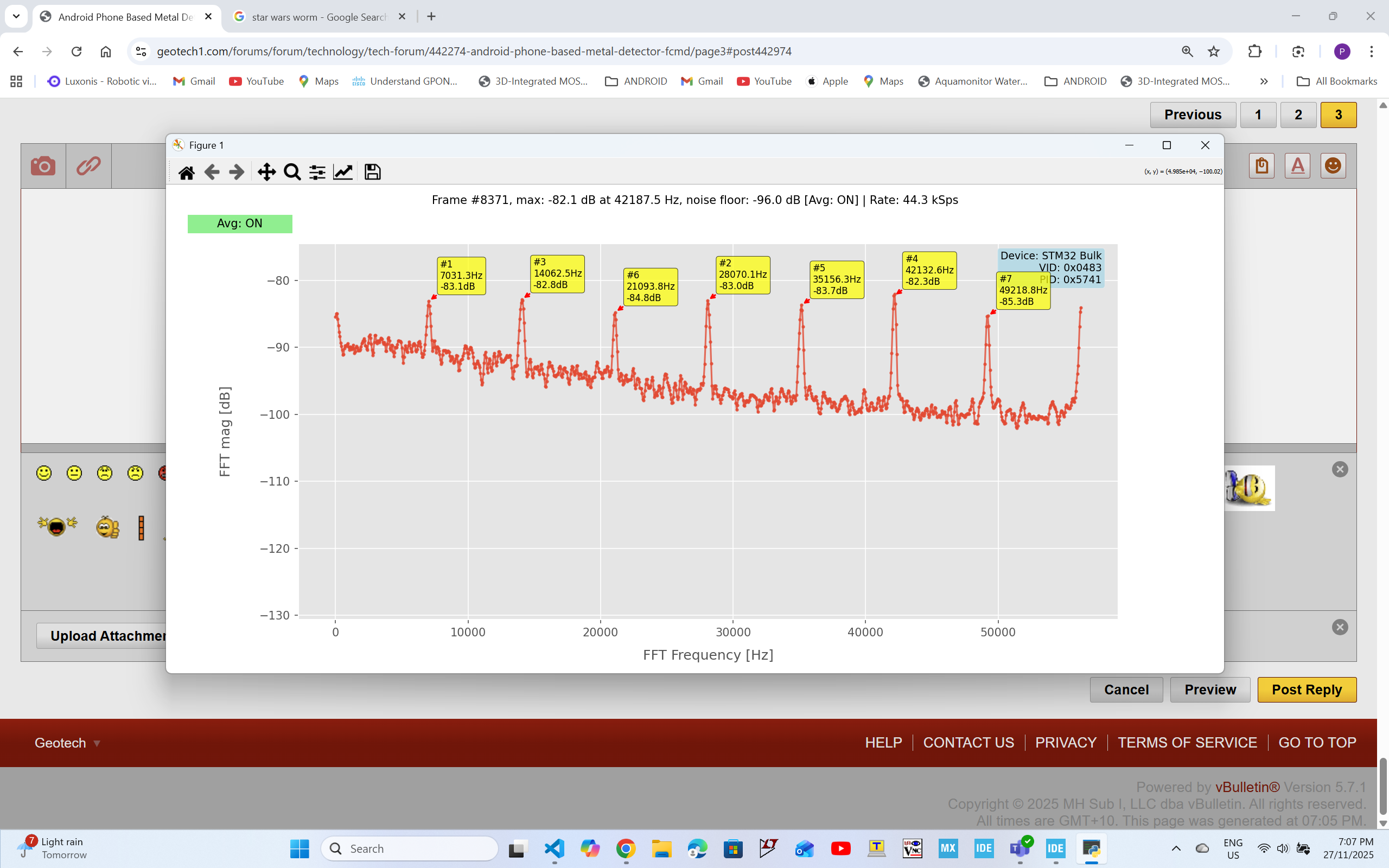

                          ....getting somewhere .. porting the FCMD into a STM32H750 chip with onboard 16 bit ADCs operating in oversampling mode.
                          Here is a pic of the ADC performance at ( 3.6 Mhz smps at 16x oversample ).
                          The DAC is outputting frequency tones.
                          The tones shown are 14 Khz 28 Khz and 42 Khz ... everthing is synchronous.
                          The noise floor is -96 db ... I can live with that.
                          The chip is connected via its USB port to a PC running a python script to show the FFT. Python is not fast so it is giving the wrong SPS rate ( its much faster ).
                          AI wrote all the code .. I just told it what to do.

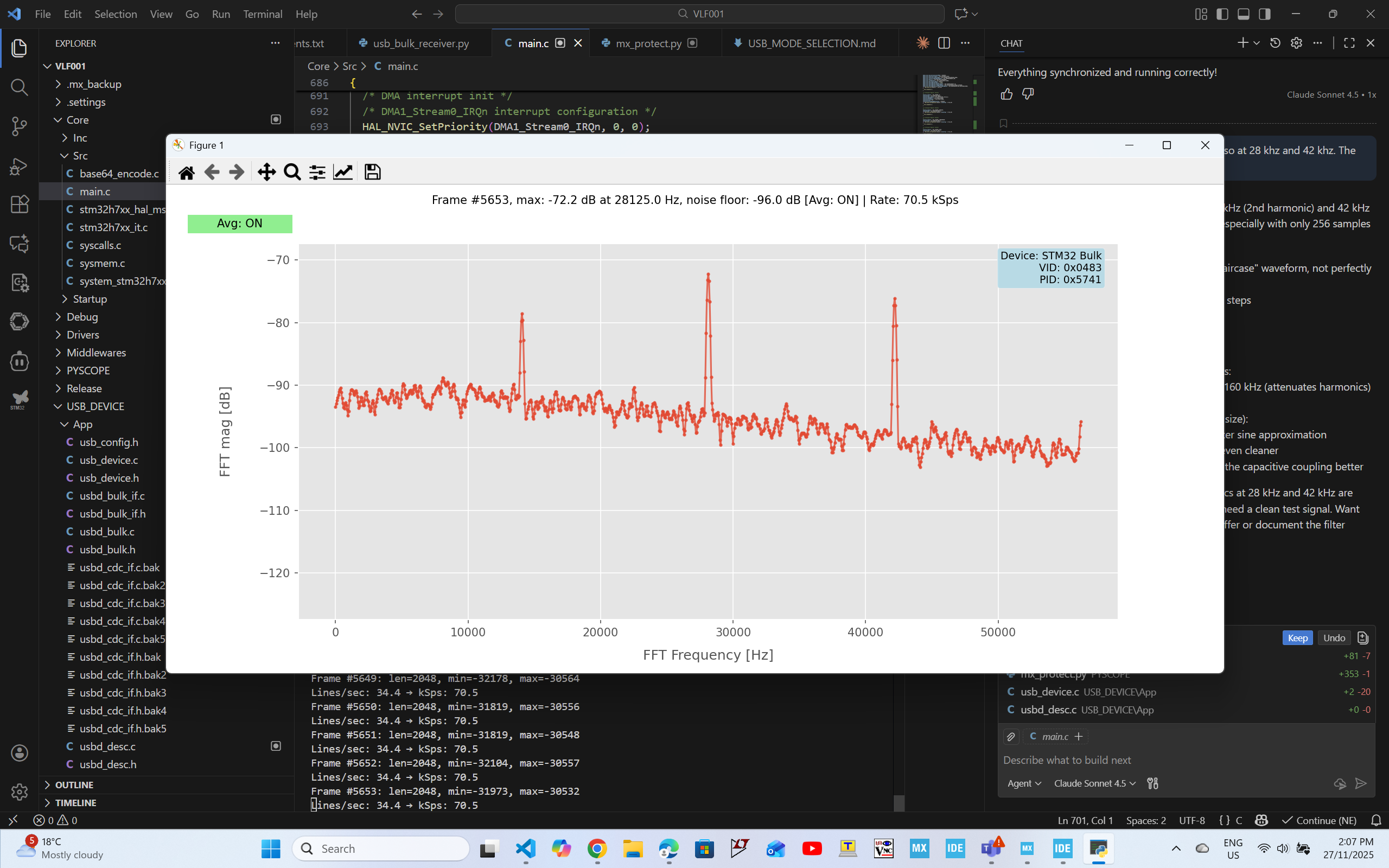

                                multitone quadrature waveforms implemented ...
