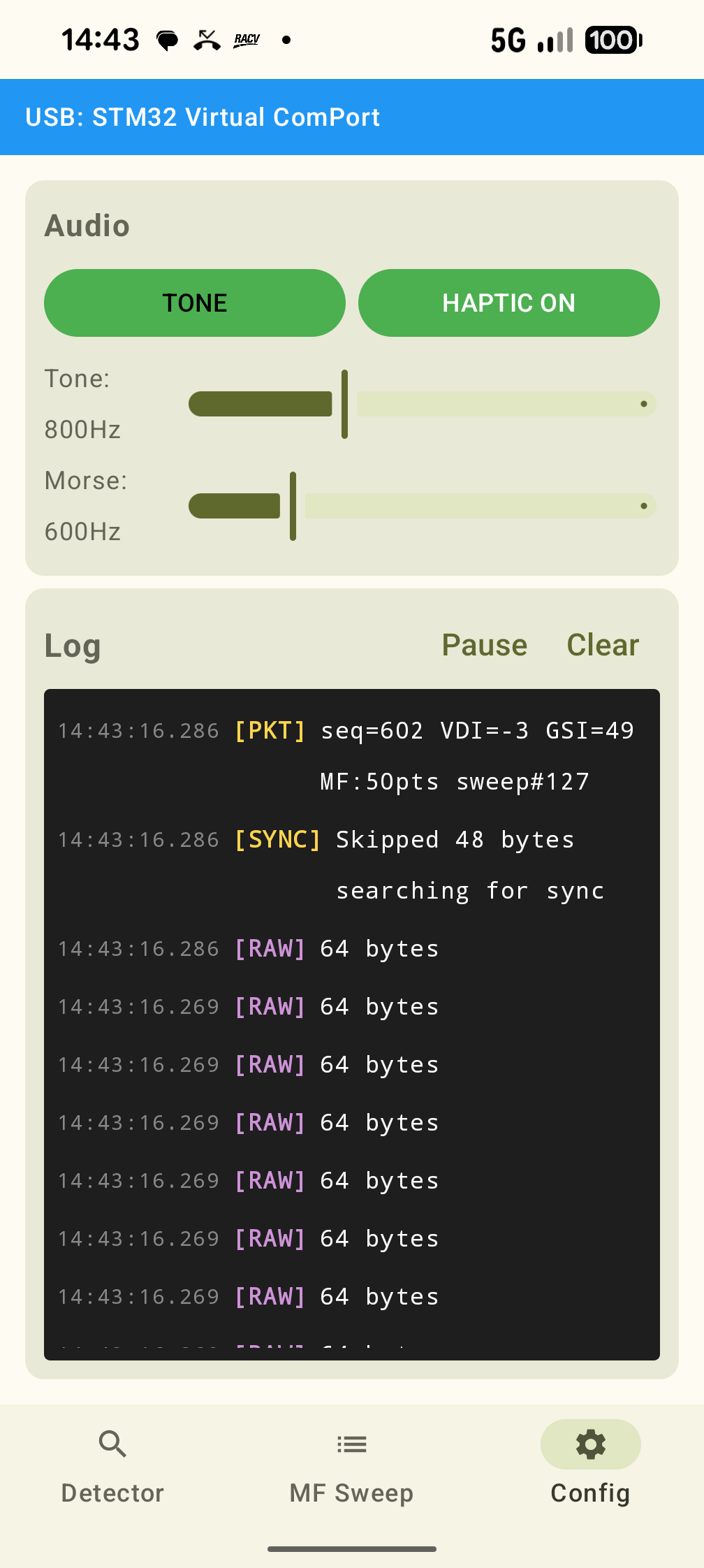

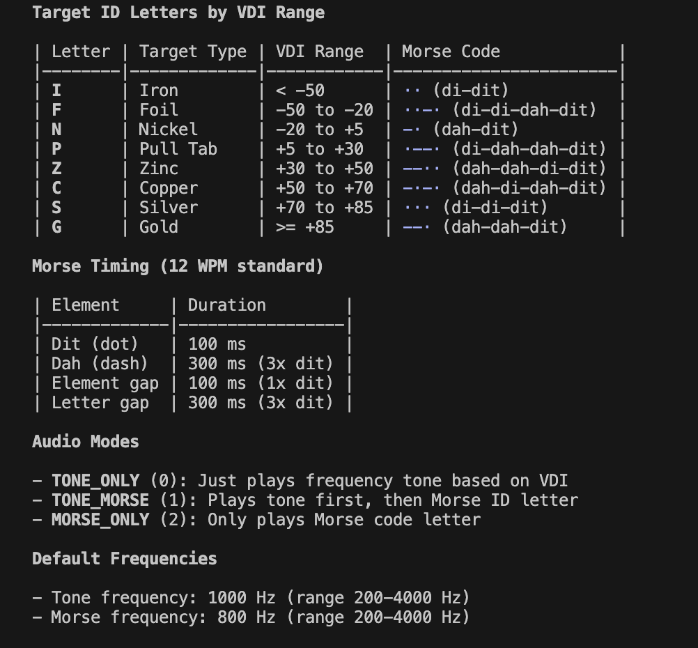

    Added more sophisticated audio with selectable tone and morse code target ID. The morse code is the first letter of the target type ... eg "I" or "dit dit" for Iron etc. Its surprising but you can recognise the tones much faster than looking at display and reading a moving VDI.
    Some people can read morse at 100 wpm ... not me . I ( and me AI mate ) also added haptic output ... to drive a vibrating target indicator with selectable threshold. Finally added a rotary encoder also for controlling stuff manually for those who like playing with knobs.

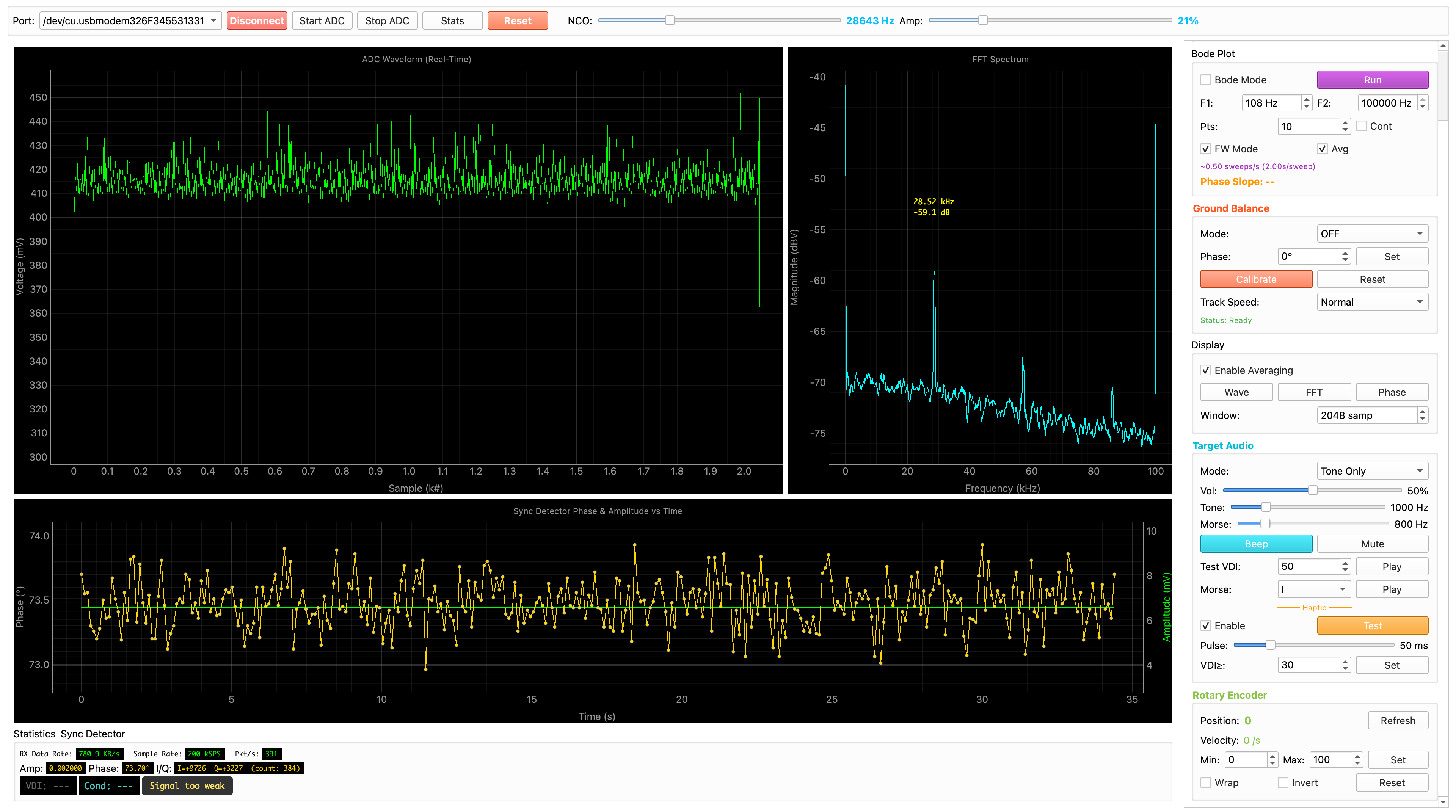

    • #62

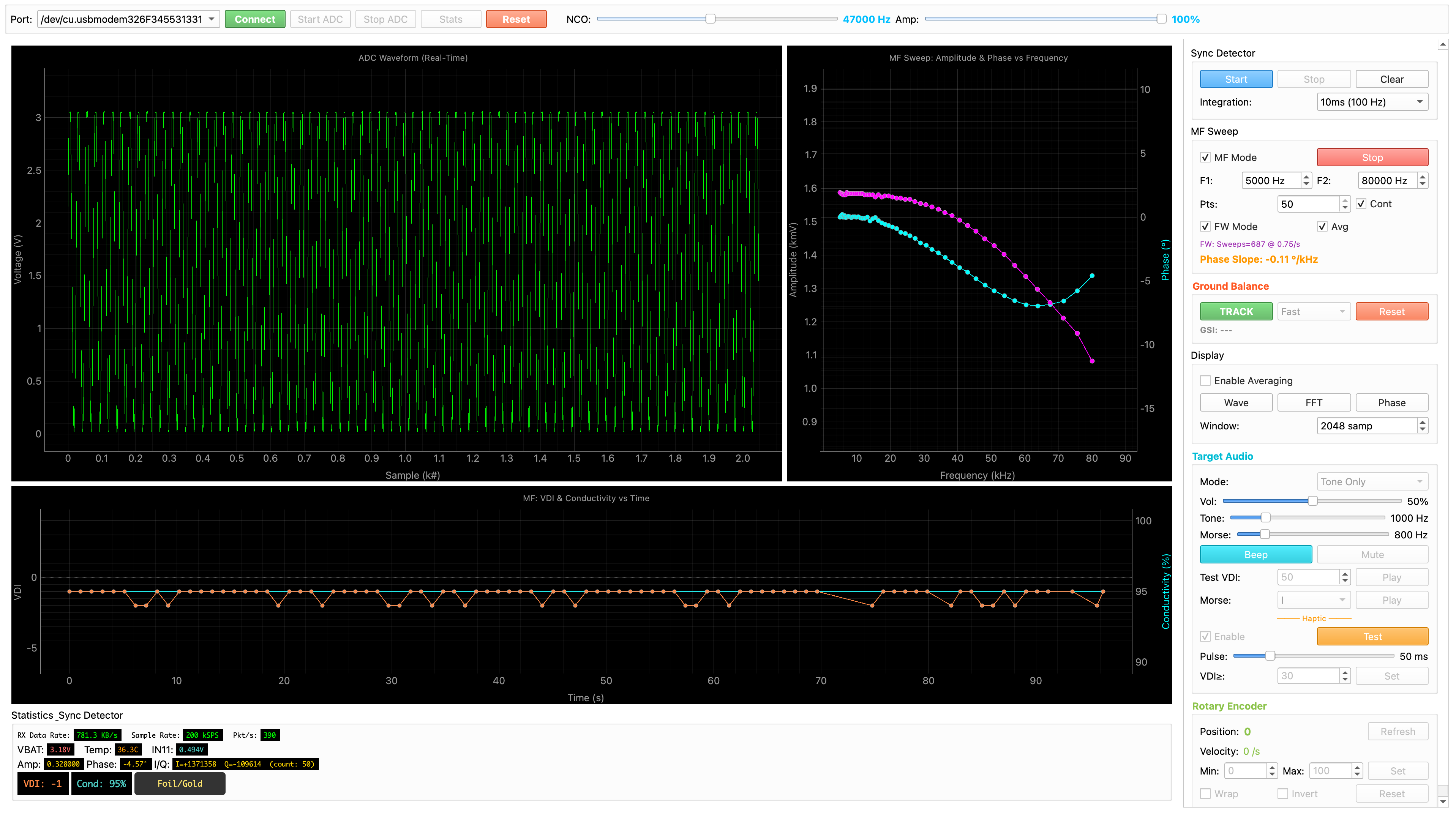

      Came to realise that in a multifrequency VLF detector GB has to be done at each frequency. So that means if you say have 10 frequencies then you need 10 tracking GB values.
      The code now supports tracking on 2 - 50 frequencies. The GB is greatly control simplified now ... its either on ( tracking ) or paused ( fixed ). To GB you just pump the coil over the ground and hit the GB reset button and it will track the ground. For fine target resolution the GB is paused. The code also provides a GSI ... ground signal intensity signal from the GB code that tells you what the ground is like. On the waveform display you can see a frequency switch occurring as we use stepped frequency sweep to maintain s/n ratio.

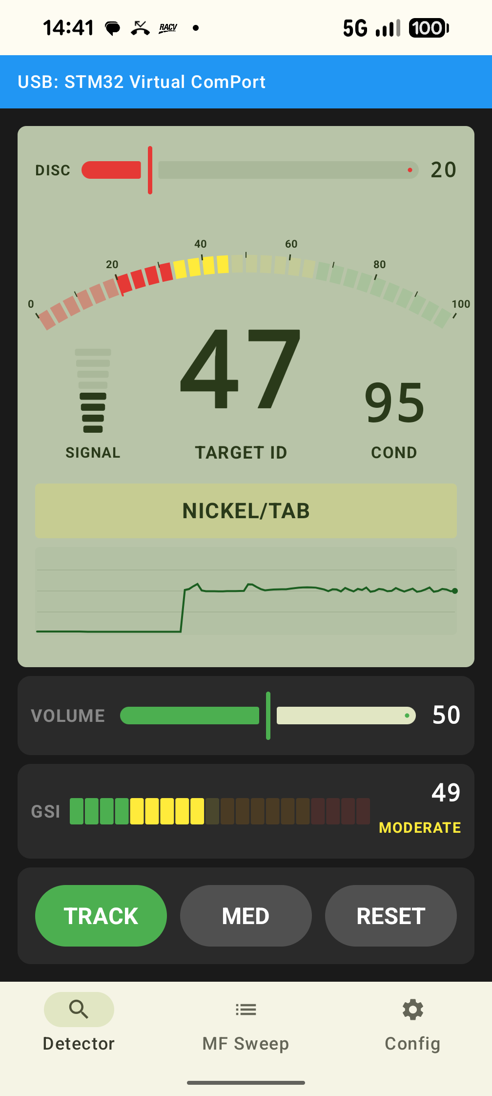

              This is the app ( not fully working yet ).

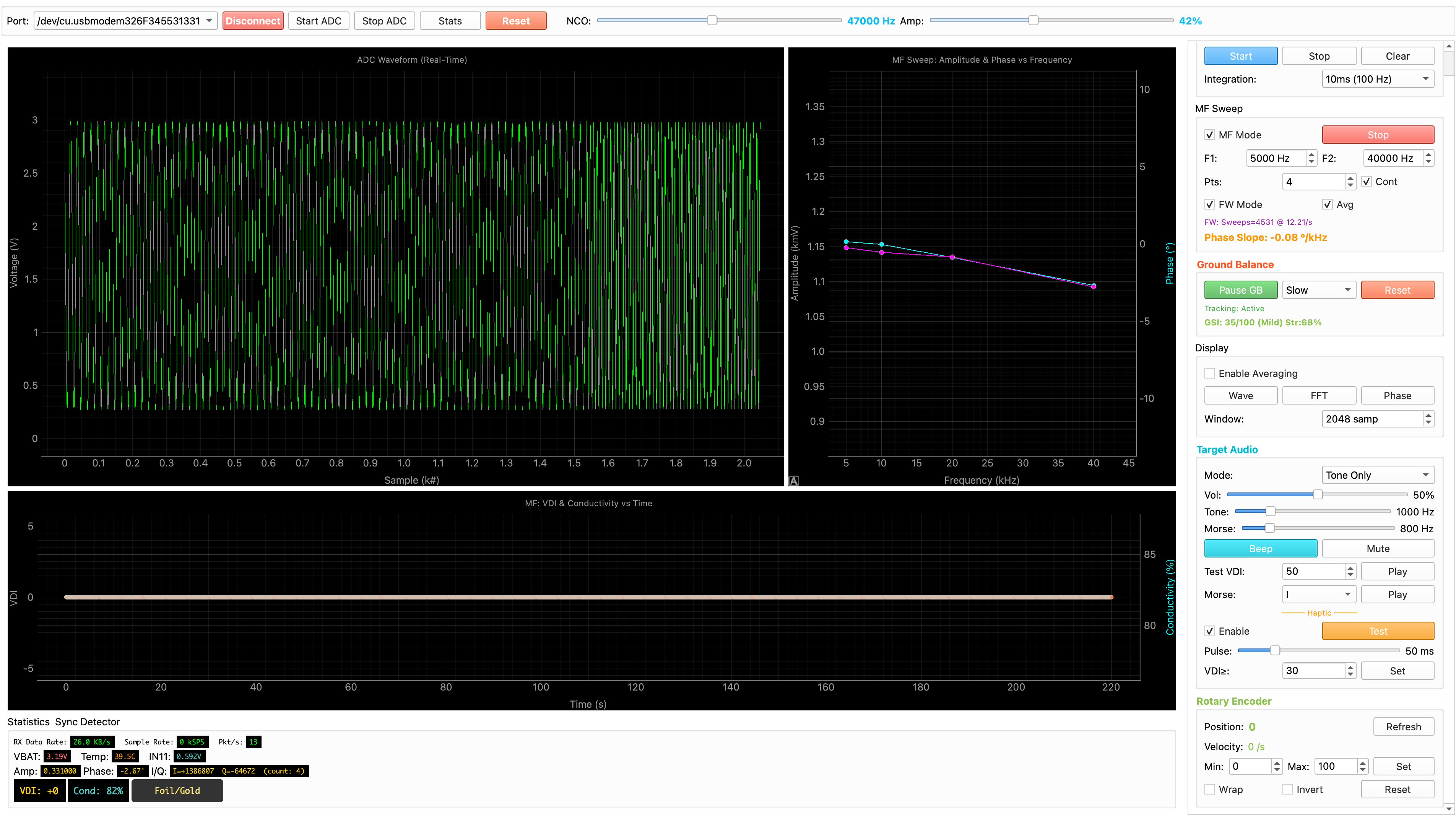

              • #67

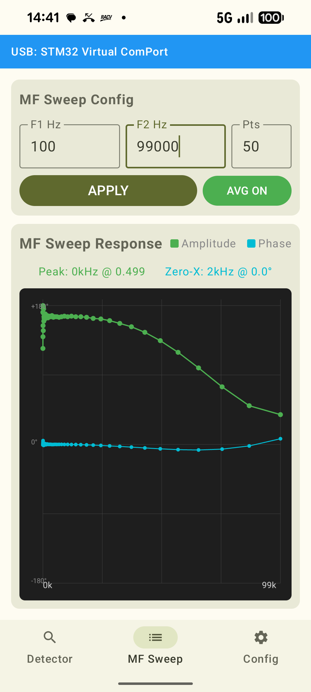

                ..well I hit the limitations of the AI. You cant develop a serial port and a USB port using serial over USB aka "CDC" at the same time ... it was just too hard for its conceptual machinery to split the concept of the requirements for a relatively low speed uart and a high speed USB interface using packetised data transfer. Anyway the realtime data needs the speed of the USB port so why compromise ?
                I was interested to see if the ground balance would actually work across 50 frequencies ( it has to GB each separately ) ...it does seem to be working. If it was not I would not get the nice smooth phase curves below.
                Its been said that so many frequencies is overkill but this is as much an experiment as a project. Besides you can use it to do bode plots to test coils etc for resonances or impedance changes.
                The sweep repetition rate is 0.5 hz .... useable for fine descrimination. The fastest sweep rate with two frequency points is 25 sweeps/sec. The default ( bootup ) is 4 frequency points at 12.5 sweeps / sec.
                ... and what is truly amazing is I got to this point without writing / editing a single line of code using a 3 step process.
                1. request
                2. test
                3. goto step 1.

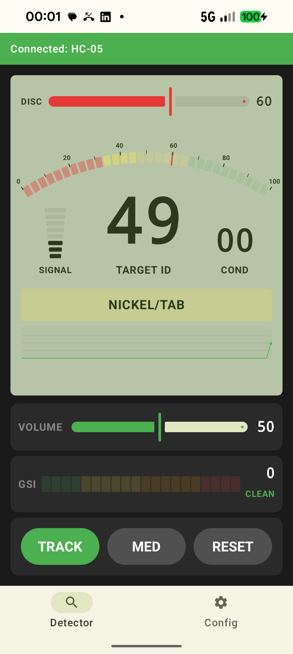

                • #68
                  Android USB v1.0 app completed!
                  3 screens main ( detector ) , sweep for profiling and testing, configuration.
                  The stm32 board is powered by the phone over usb.
                  I did a 50 point sweep from 100 Hz to 99Khz with GB on ... seems to be working like a charm.
                  Very little cpu usage on the phone as all the DSP is done in the STM32.

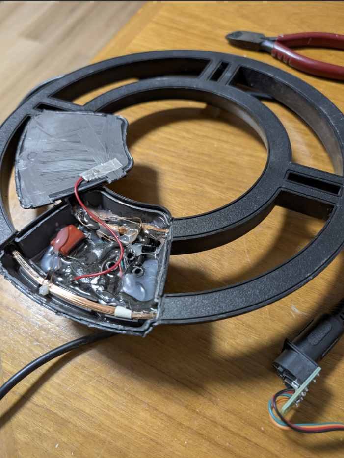

                    .. now we will need a broadband coil so we chop the capacitor out of our test coil Leaving us with two coils one at 3.2 mH and the other 2.6 mH ..
                    Its likely due to the high inductance that we will only be able to reach 50 Khz ...
                              How did it go with the modified coil?
                              • #75
                                Usually the hardware is quick and the software takes longer .. now I have found the situation is reversed. I am modifying the driver hardware to compensate for the increasing reactance of the coil with frequency so that the transmit power is flat across the spectrum from around 5 khz to 100 khz. The resonance point of the coil cant fall in this range so working on minimising the driver capacitance etc .... so getting there.
