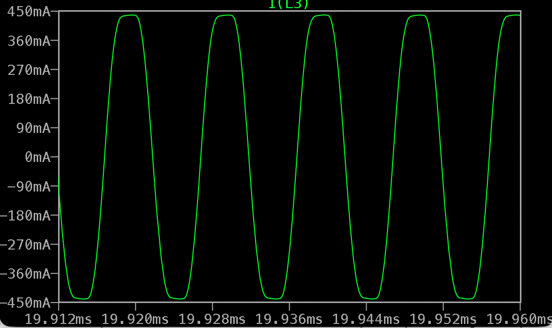

      I use the onboard DAC driven by an NCO with .47 millihertz resolution.
      The software can generate sine or square wave.
      A 300uh coil has about 9 ohms of reactance at 5 khz and 188 ohms at 100 khz ...
      Ideally we want at least a flat spectrum across 5 Khz to 100 khz a simple amplifier will give a spectral rolloff due to the increasing reactance of the coil with frequency.
      However we can achieve a flat response by using an LR charging and energy recovery scheme in the driver so that the power spectrum will be flat across the desired frequency range.
      So if our top frequency is 100 khz ( 10 microseconds ) then the minimum required rise time of the coil is 5 microseconds ( 5 t ).
      Below are the plots of coil current at 100 khz and 5 Khz. If we sweep the frequency from 5 Khz to 100 khz the spectral energy is flat +/- 1 db.
      What about the capacitance ? Yes it does affect the result but not in the way most people think ( resonances etc ) ... the capacitance effect is a function of the source resistance of the feeding power supply and the capacitance value.
      A simple RC calculation where the time constant must also be be less than the time constant for the LR.

      100 khz below

      • #78
        So DDS to generate the waveform. Presumably you could generate any (repeating) waveform, not just sine or square waves, using suitable lookup tables?
        Can you share the circuit for the constant current output vs frequency?

            yep .. you can use any waveform you like from repeating lookup tables or you can calculate on the fly. The lookup table with DMA loading the DAC uses almost no CPU cycles.
            The driver is based on the work I did here : https://www.geotech1.com/forums/foru...ansmit-circuit
            Very easy to generate constant power spectrums upto frequencies way beyond 100 Khz that I will be using.
            This method does introduce harmonics but the widest filter in the DSP is code is 100hz wide downto a few hertz so no problem ... plus all the harmonics are frequency / phase locked to the fundamental anyway.

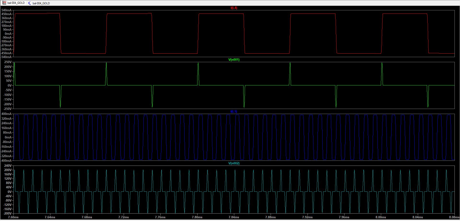

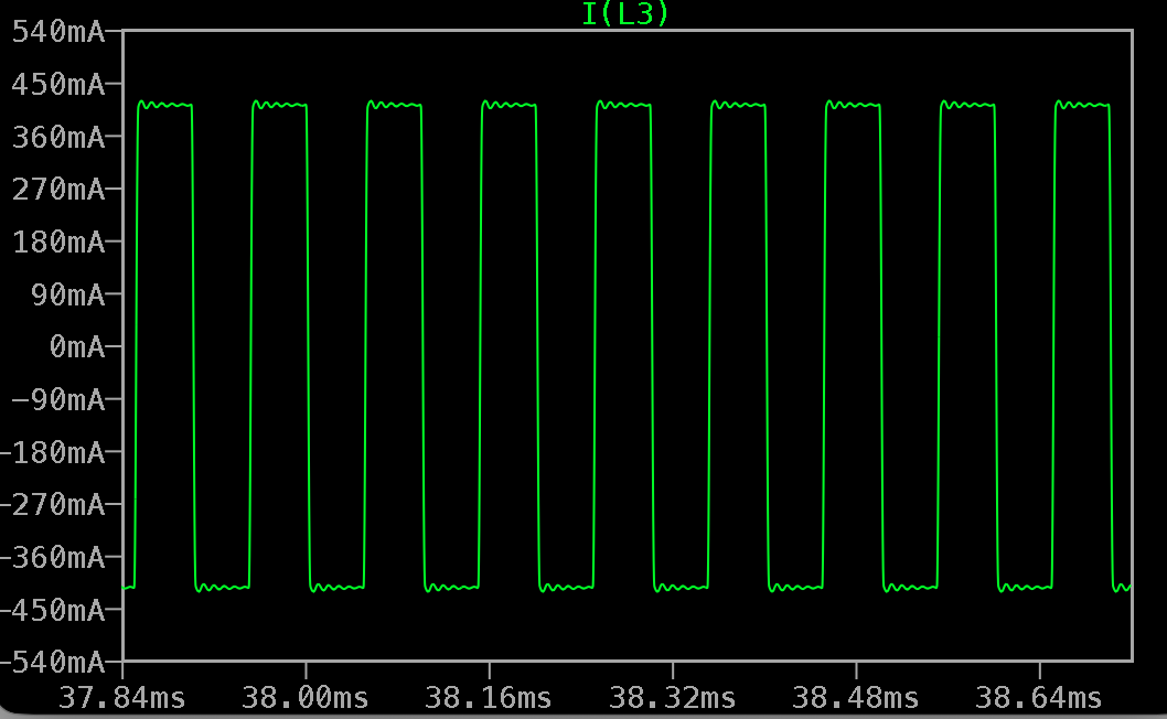

                      Aziz dunno about doing it with one mosfet ... I need to sweep the TX frequency from around 10 khz to 100 khz and keep the phase flat. Plus the circuit needs to drive an unbalance coil .. and did I mention that inductance changes must not change the phase relationships.
                      It took a bit of work but over the holiday break but I managed to get the driver into shape using a handful of cheap discrete parts not only producing the correct phase and amplitude across 10 - 100 khz but also bipolar into a transmit coil grounded at one end. Bonus .. it doubles as a bipolar PI transmitter as well.
                      The supply voltage is 3 volts and the Tx current is +/- 450 ma. ... around 1.5 watts of power consumption.
                      Traces for 10 khz and 100 khz below. With gold prices at over 6000 AUD even a .01 gram spec is worth $2.
                      The software phase sweep function is stable to 100 khz ...and now the coil driver can reach that frequency ... so if you think that .01 gram specs are not worth it ...think again. Would you walk past a ten dollar note ? ( .05 gram )
                      The coil voltages and currents are below ... 100 Khz and 10 khz shown.

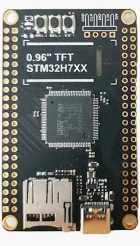

                          Finished V1.0 of the code for the STM32H750 chip ... I use this board: Its a chinese board by weact studio.
                          I will do a bit of testing then release the firmware. It detects a 10 x 10 cm foil at nearly a meter.
                          There are no physical controls its all done over USB plugged into a phone/computer ... RTFM below.
                          note : It does not need the USB connection to run in default mode.

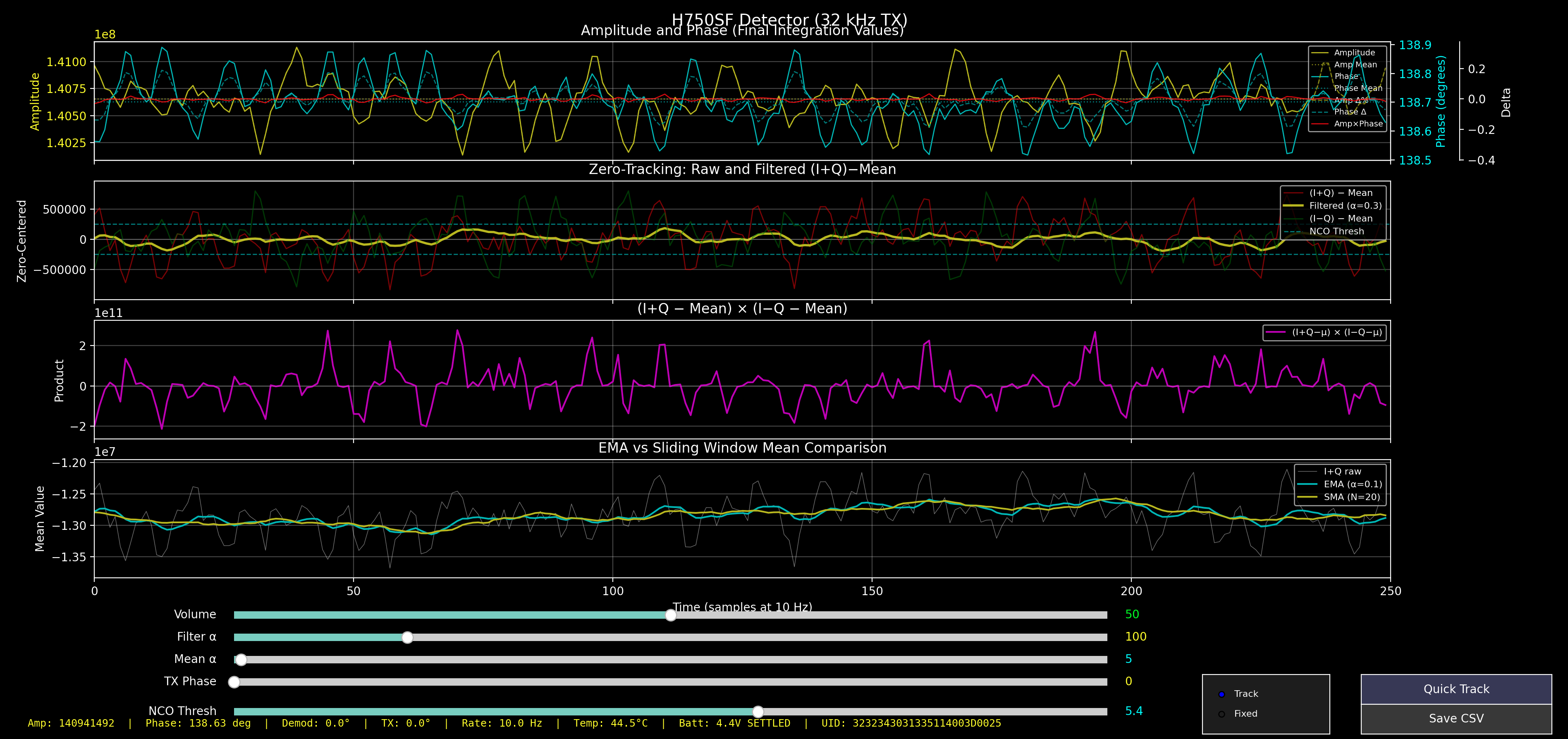

                          ​​​​​​Click image for larger version  Name:	image.png Views:	0 Size:	222.8 KB ID:	444403​
                          and the plotter app in python for experimentation :
                          Click image for larger version  Name:	image.png Views:	0 Size:	890.7 KB ID:	444405​
