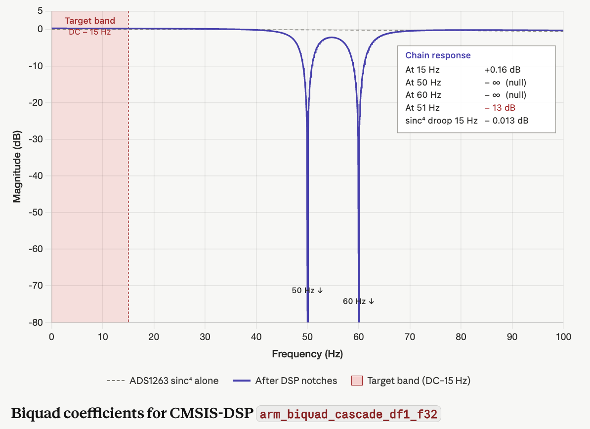

    Anyway here is the frontend response for my sampling scheme from the C code.
    The nulls are really sharp mains reduction wont be infinity obviously due to variance in mains frequency.

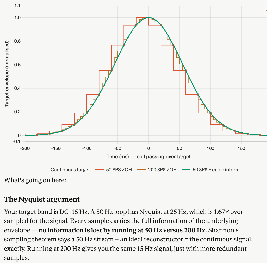

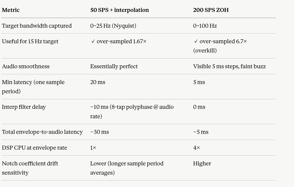

    • regarding the loop rates ... 50 Hz is actually better than a fast loop rate.
      Below is the comparison of continuous target, 200 hz rate, 50 hz rate and my code cubic interpolation .... giving a smooth signal response that is "near perfect".
      If you make your loop faster than needs be for a given target bandwith its just ignoring basic nyquist sampling and shannons sampling theorem.

      • This real math science is really trhiling a me amuzment by da way is not correct on target signal response it is not a continius signal so ewretinlg later is no relevant sorry to upset you again tell you just use 250SPS and all be well , and everything will be fine, and you'll be bathing in a chocolate bath.
        • Originally posted by Hristo View Post
          LOL. I am bathing in a chocolate bath ... the signal is just samples .. mine come in at 50 hz ... the integrators fully reset every 20 ms ( ie every cycle ) so theoretically it can detect a target in 20 milliseconds ..
          OK how about I put variable loop rate control in ( just for you )

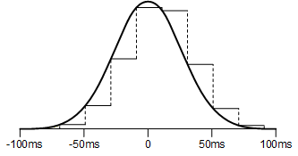

            Your Gaussian curve looks slower than it should for 15Hz. This is what I come up with for a 15Hz target response sampled at 50Hz:
            In general, the more you sample the more you can filter. The only reason most detectors used a 5ms loop rate is that processors of yore couldn't do much more than that.

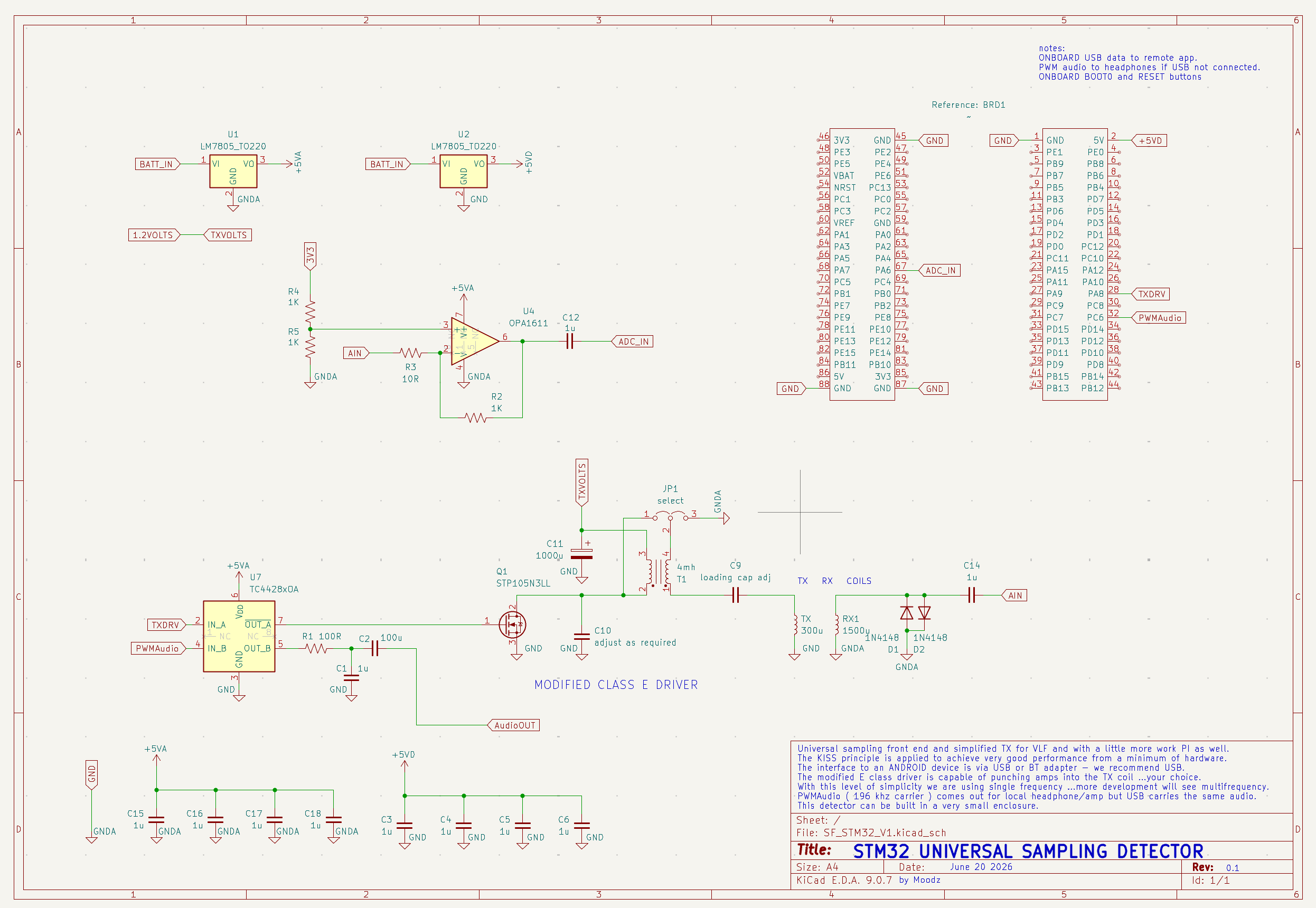

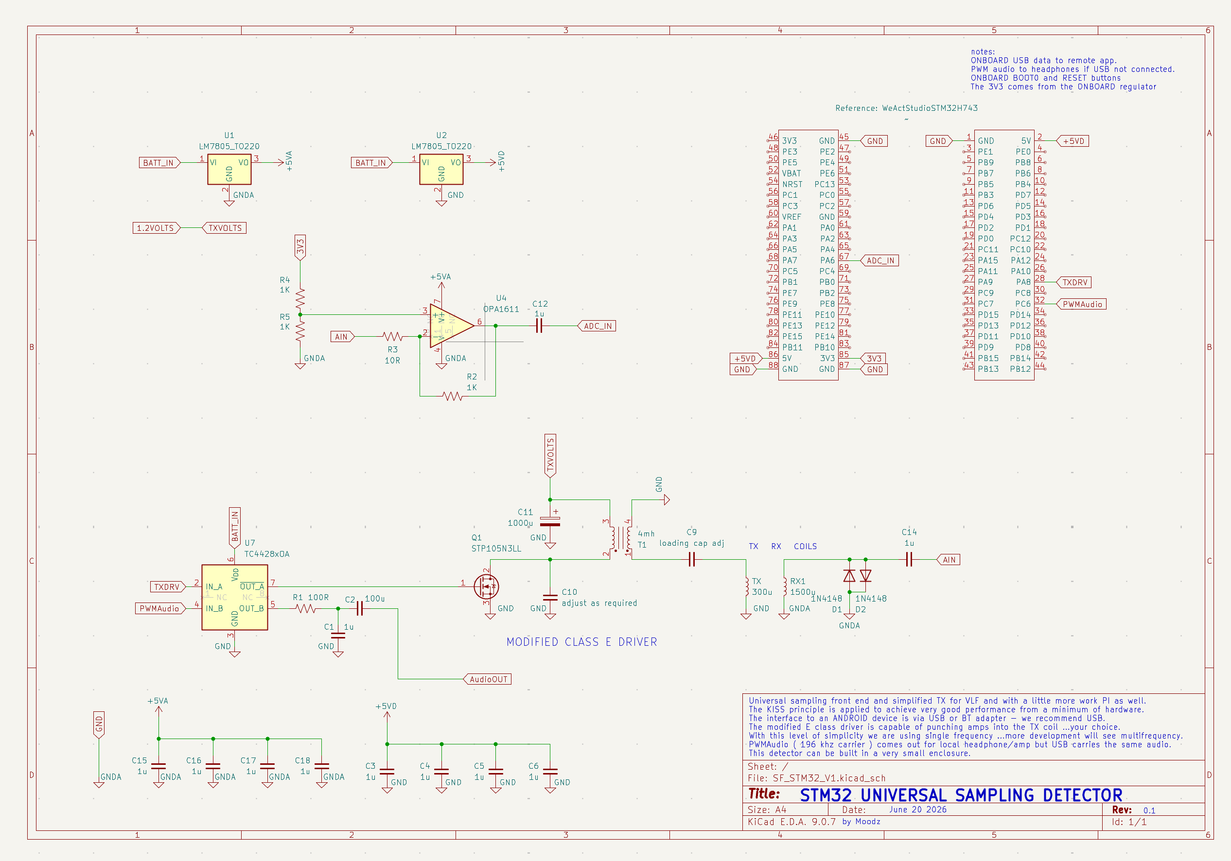

              The simplest possible version of the FCMD ( fone connected metal detector ) is a STM32 processor and a single mosfet + some resistor / cap / coils etc.

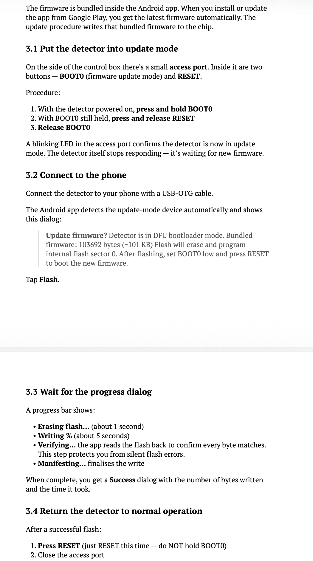

              The STM32 processors have a DFU mode for loading firmware ... its a factory firmware update mode and it makes "bricking" the CPU almost impossible.
              By bundling the latest firmware with the android app the firmware can be loaded over the usb port from the Android app. No need for programmers or flaky bootloaders.
              The transmit circuit uses my modified E class driver using a single mosfet and gets around 1 amp peak to peak in the coil from 1.2 volts. Current consumption from a 5 volt source is around 200 mA ( total ).
              So its possible to have a detector electronics enclosure that is the size of a matchbox that you just plug your phone USB into and you are ready to go.
              Audio comes from the phone as do all controls and power ( but can run off other power if required ). If the usb is disconnected and the box has aux power the audio falls back to PWM.
              The phone provides audio from internal loudspeaker or Bluetooth. Maximum latency is 20 ms.

              • This is the SDR of metal detectors .... ultra simple circuit mostly change code to do what you want at what frequency etc etc.
                You can build one under an hour for $10 - $20 .. dont even need a PCB.
                All of the complexity has moved from the hardware to the software.
                At this time the app supports any stm32h743 with a USB connector.
                more frontends coming soon for PI DD, monocoil PI, monocoil VLF, monopolar, bipolar ....
                Ferinstance emulating a classic whites MXT detector is trivial.

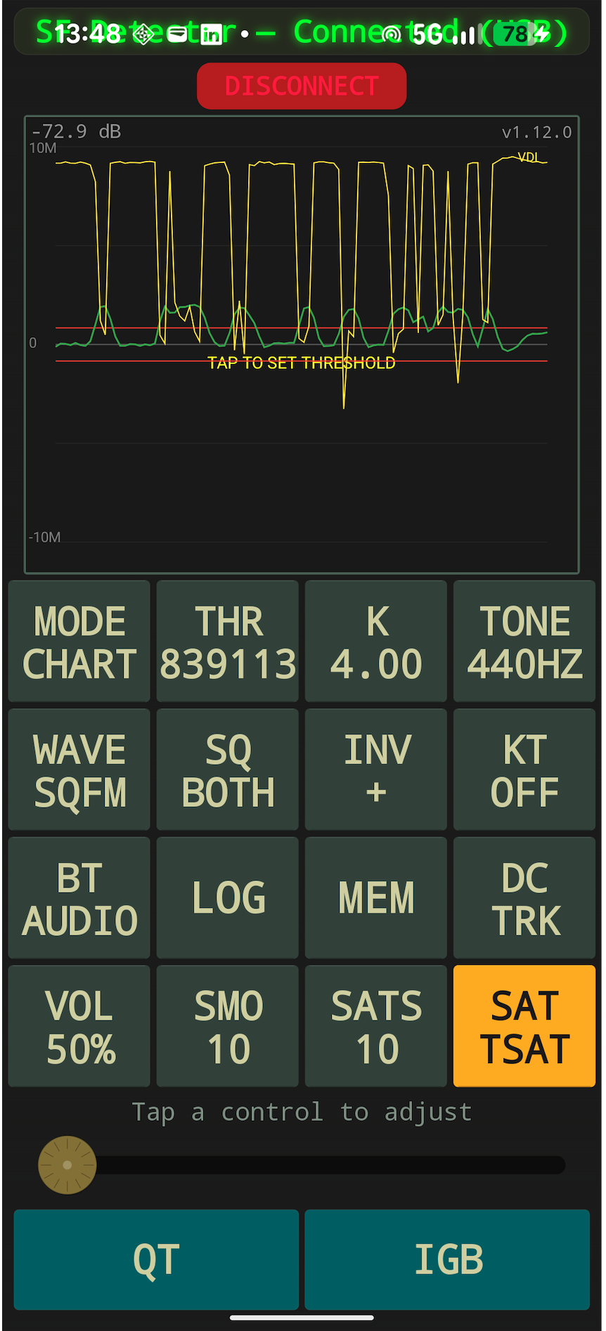

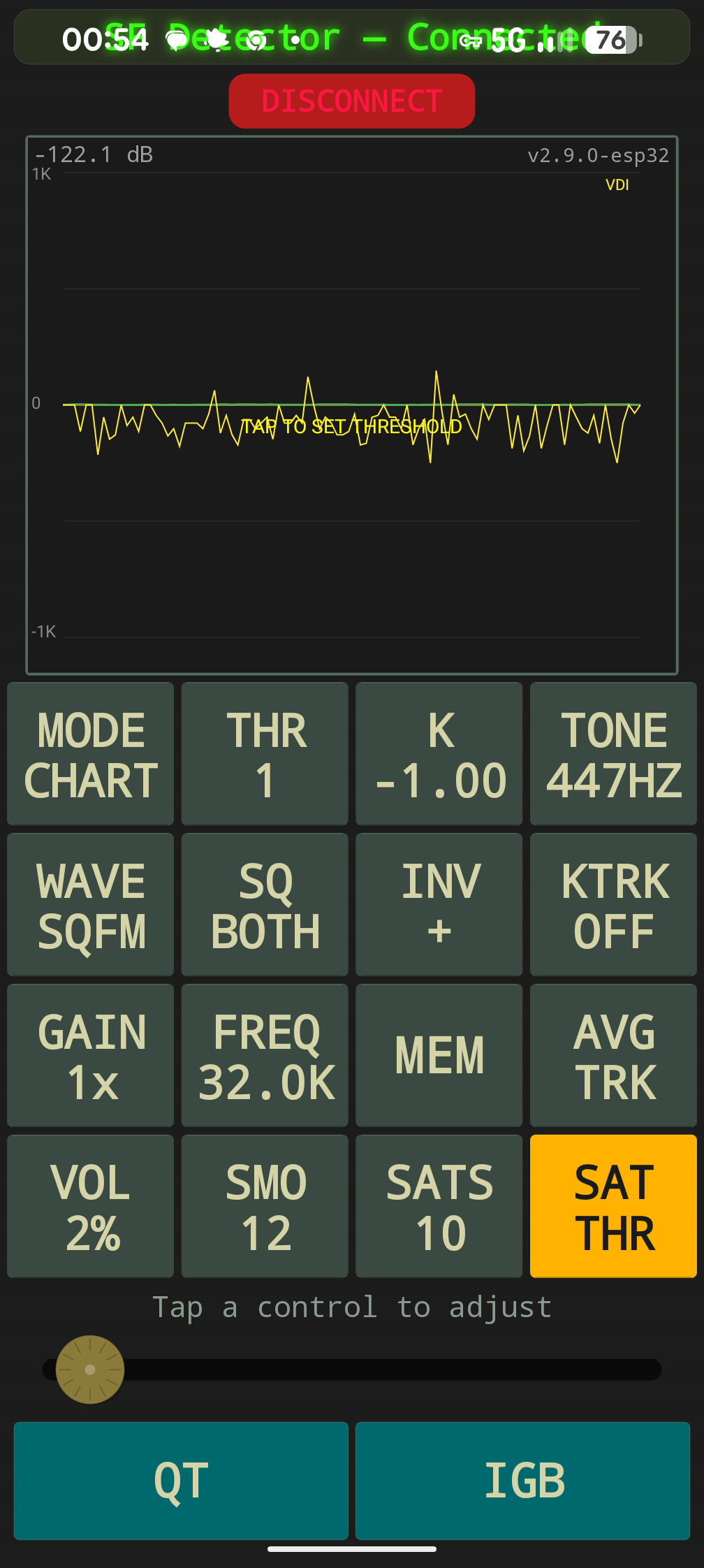

                  • i have two versions of the hardware ( stm32 and ESP32 based ).
                    The android app talks to either via blue tooth or USB.
                    I have been hammering the ADC and DSP code on both hardware platforms to achieve some decent noise floors.
                    At the moment the ESP32 solution is leading with a noise floor of nearly -123 db. ( the stm32 only achieves -89 db with the internal 16 bit ADC )
                    This equates to an ADC resolution of 21.7 bits noise free at gain = 1.
                    The big plus is that the ESP32 + external 24 bit ADC to do this is less than $20 ( PCB modules ).
                    In practice with the smoothing set to 10 ( thats the filtering knob on the controls )
                    .. the threshold is at a minimum ... this means the noise floor at the detector operating frequency is less than +/- 560 nanovolts ( half a microvolt ) peak
                    The ADC input amp is set to x1. ( gain setting from 1X to 64X )
                    The operating frequency can vary from 3 Khz to 60 Khz ( Pi or VLF .... whichever frontend is fitted. )
                    The same ADC /CPU works for PI or VLF ... its just software now and minor TX / RX configurations.
                    The peak noise is in the upper left of the target history trace. The green line is the target signal. The yellow line is the VDI ( +/- 100 )
                    A threshold of 1 ( corresponds to a peak signal of 560 nV ). If the target line ( green ) breaks the threshold the audio will unmute and modulates tone to indicate.
                    The android app will be available on android play soon ......
