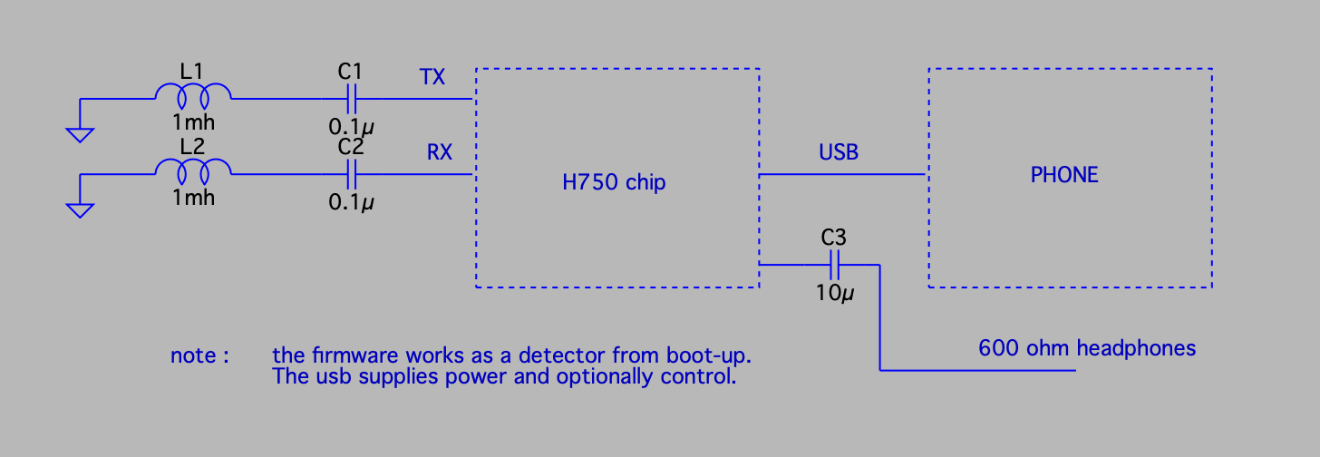

      Finished V1.0 of the code for the STM32H750 chip ... I use this board: Its a chinese board by weact studio.
      I will do a bit of testing then release the firmware. It detects a 10 x 10 cm foil at nearly a meter...
      That detection range sounds very good!
      For the real world use; will this design have trouble with wet/beach soil or near power lines, and will it actually be able to tell apart a common iron nail from, say, a silver coin?

          The AI never says the H750 ADC is better than a 24 bit ADC .... however for the purposes of this design a tiny $5 chip with $10 of components can make a sensitive detector and achieve good results all other things considered and the whole detector will fit in a matchbox.
          For instance there is no point using an uber ADC sound card chip with -137db performance if the noise floor at the coil is -90db.
          The AI does say that the H750 can achieve around 20 bit performance which is adequate for the application.
          Read the summary extract again :

          Bottom line: The dual 16-bit @ 3.2 MHz approach achieves ~20 effective bits, competitive with mid-range 24-bit ADCs, at lower cost and complexity.​​
          Cant get much simpler than the minimal detector circuit below ( useful as a pinpointer ). I proved this works because my circuit still detects metal at the coil with the transmitter boost turned off due to leakage currents from the driver cct.

          • #95
            it will probably have many more problems than you mention as well. It has not left the bench yet. This version is based on the FPGA design which does use a high end 24 bit ADC but costs alot more and is more troublesome to code for.
            There is just a cap connecting the rx coil ( no RX preamp ). The tx is a bipolar 32 khz current square wave with 3us rise time +/- 90 volt flybacks across a 300uh 0.5 ohm coil. The coil current should be about +/- 400 ma. It can tell ferrous from non ferrous but that is a work in progress as I have a number of "channels" to choose from and of course the channel with the best discrim has the poorest ground rejection.
