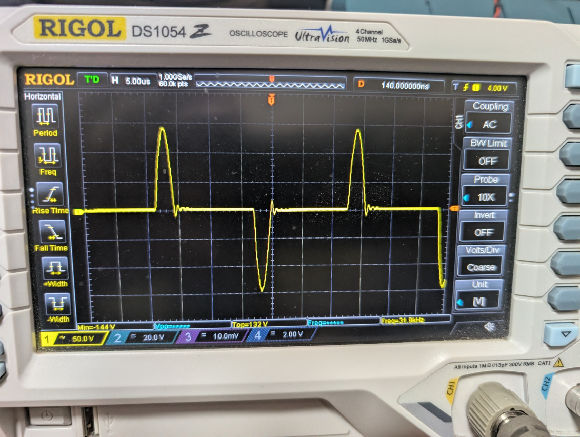

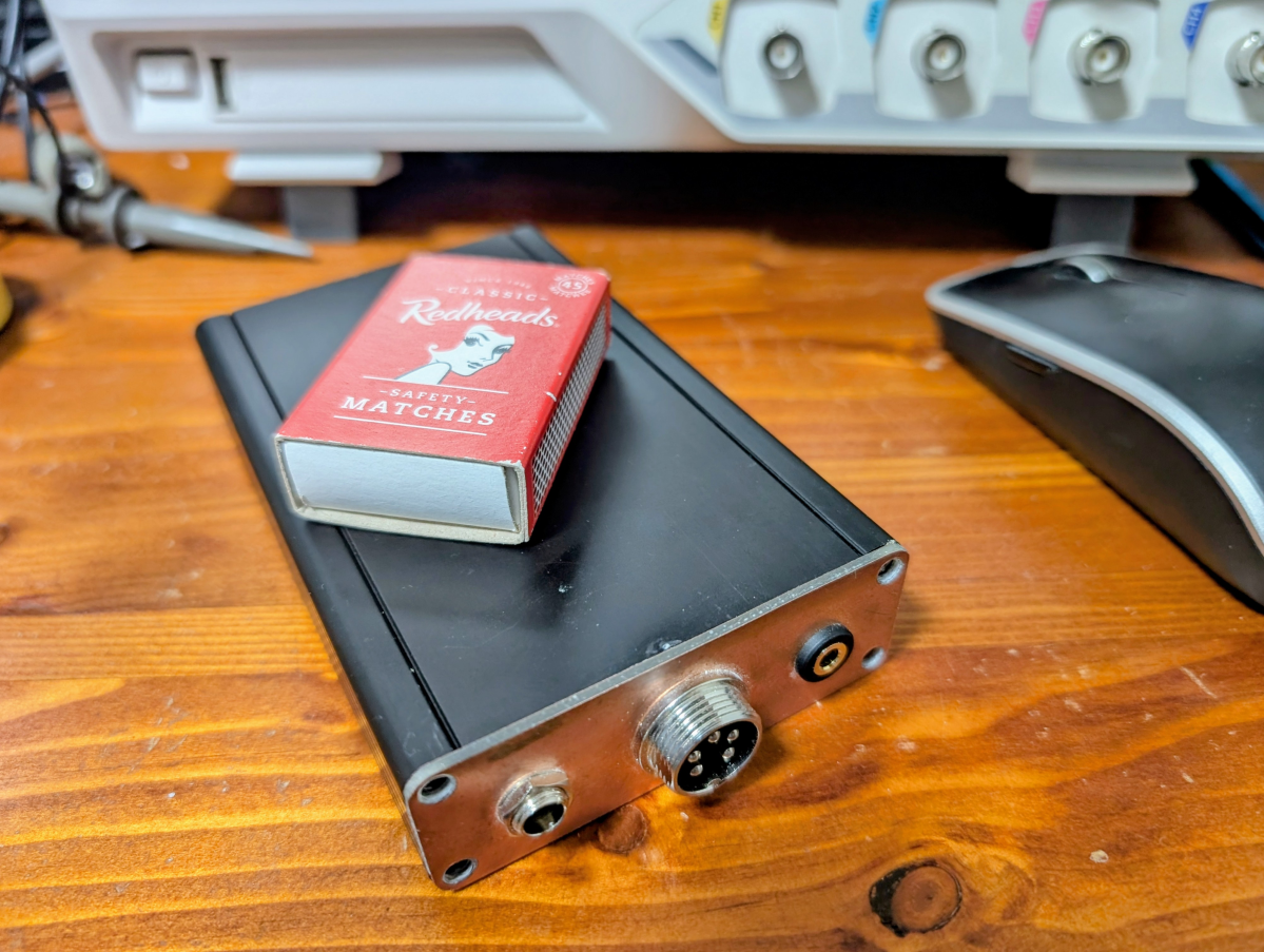

          • OK its a bit bigger than a box of matches .. the surface mount unit would be smaller.
            I added a 20x preamp prior to the ADC and the 10cm x 10cm foil is detecting at just over the meter in air.
            The coil current is 1 amp peak to peak true biploar square wave with a fall/rise time of 3 microseconds.
            The power consumption for the whole detector is just over 1 watt. ( ie less than 100 ma from 12 volts ).
            The code does simultaneous PI and VLF demodulation.
            It can be this small because the detector is a true software defined metal detector ( SDMD ) consisting of CPU, bipolar transmitter, preamp and power supply
            ... there are no switches, demods, integrators or damping resistors.

            transmit voltage waveform
            ​Click image for larger version

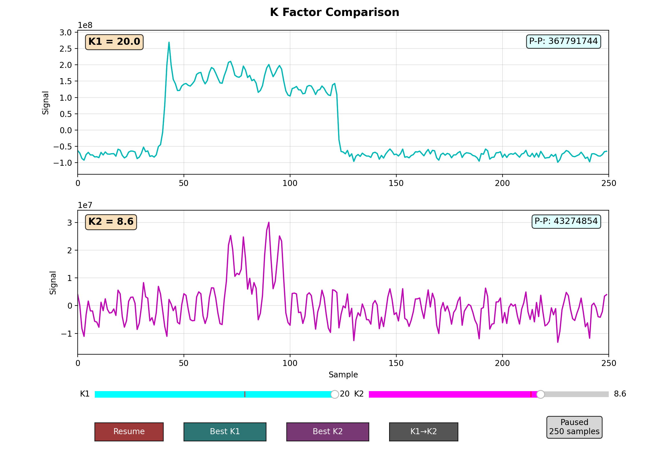

            • Might have nailed it ... found a new method based on very elegant maths that cancels ground (or anything really) whilst simultaneously boosting desired targets.
              Below is the output from a python app that shows removal of a ground signal ( nasty ferrites ) whilst simultaneously boosting a wanted signal ( non ferrous ) in the time domain !
              The pyhon app is taking a 5 second snap ( 250 samples ) from the STM32 ADC signal chain and doing a parallel execution of the method showing the complete elimination of the ferrite / ground signal but leaving the wanted signal boosted.

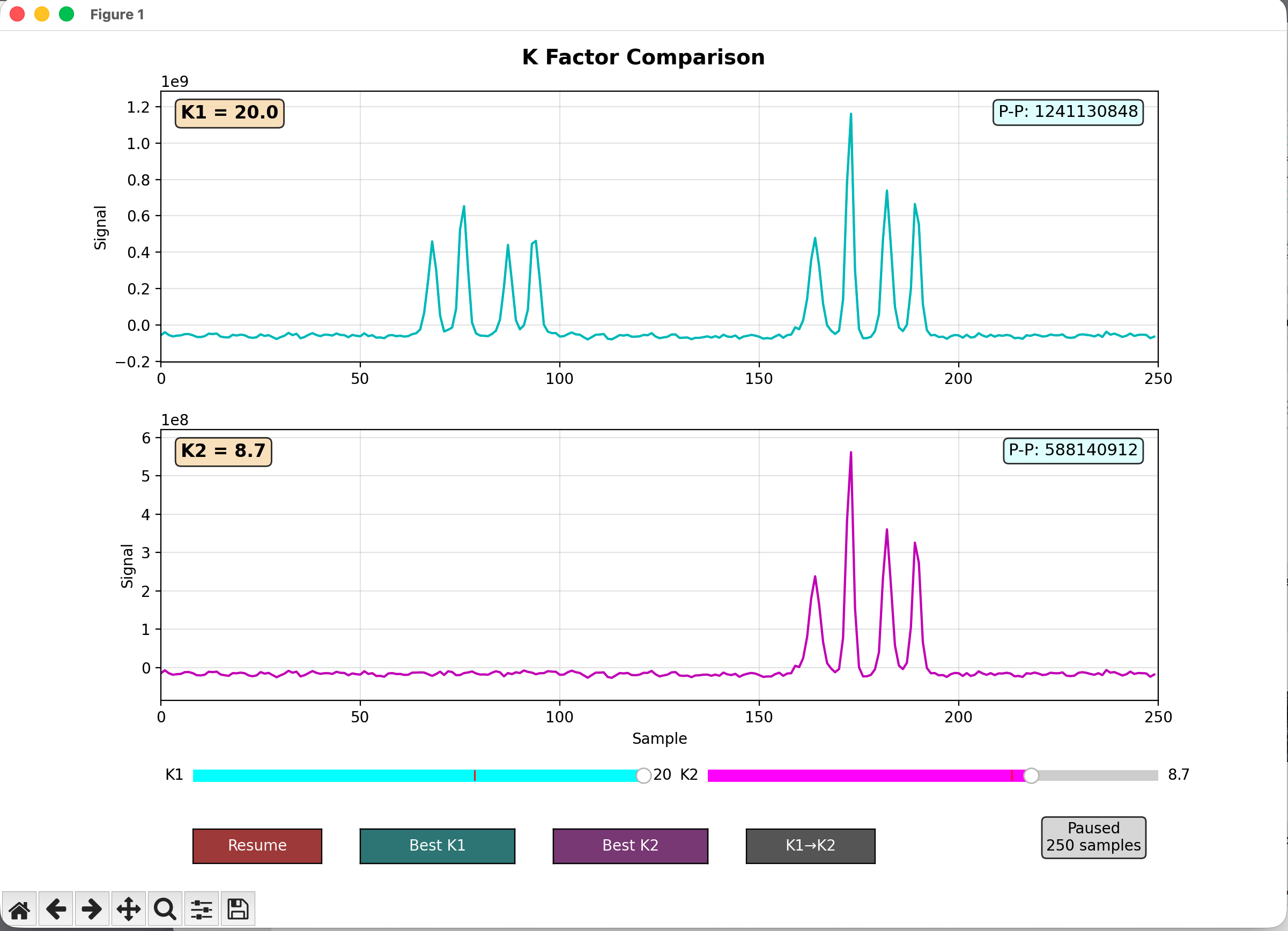

              • Just to prove I am not doing magic tricks like gating or something ... I bring the ferrite near the coil and keep it there ... then wave the target 3 times ... then remove the ferrite from the coil ... you can see this in the top trace. In the bottom trace the method removes the ferrite response leaving the target response ... Magic without tricks
                Click image for larger version  Name:	image.png Views:	0 Size:	209.9 KB ID:	444632​

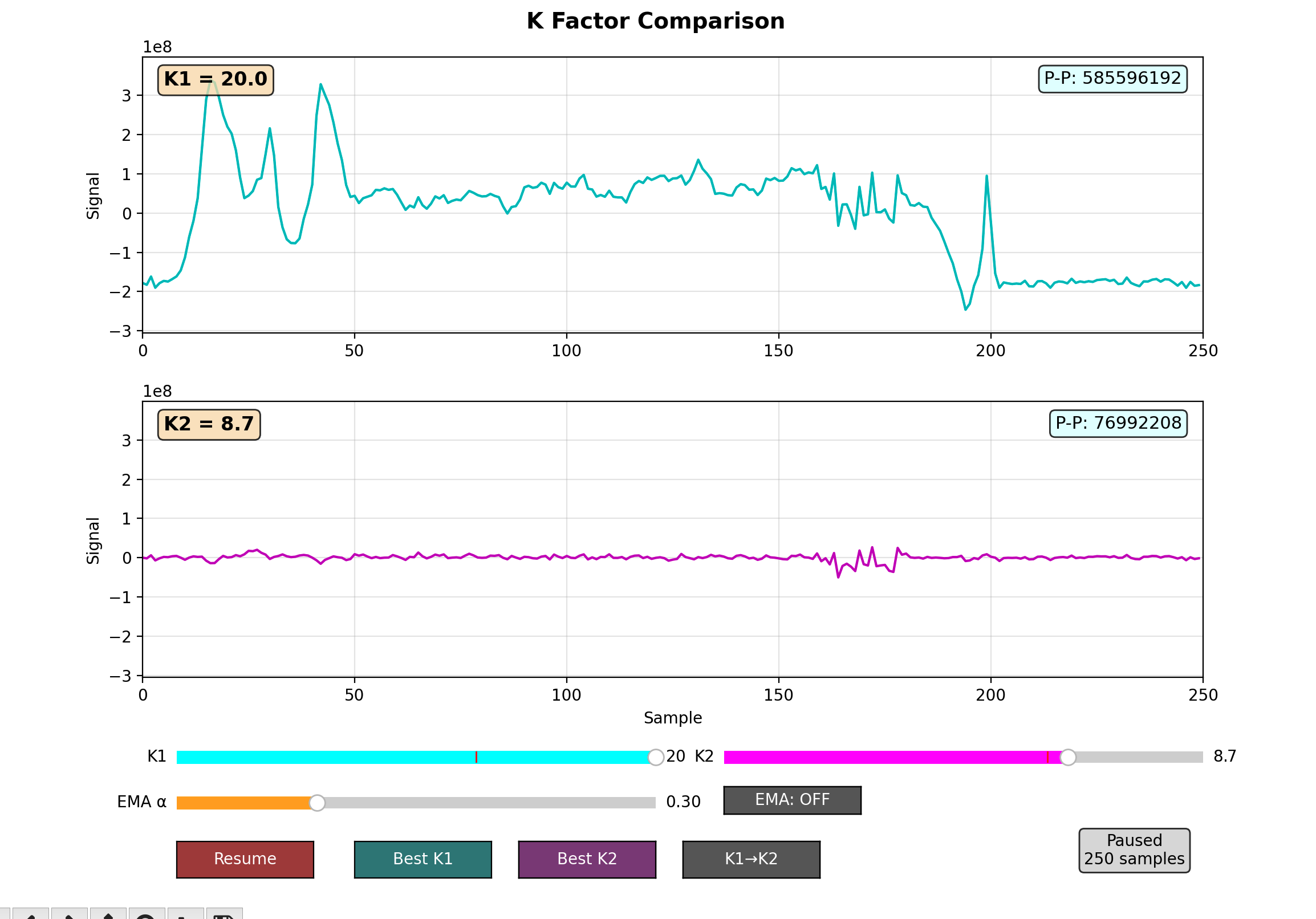

                • here the ferrite is is held about 10 cm from the coil and the target is waved twice at 80 cm ( 10cm x 10cm foil ). ... very hard to pick the foil without the magic !

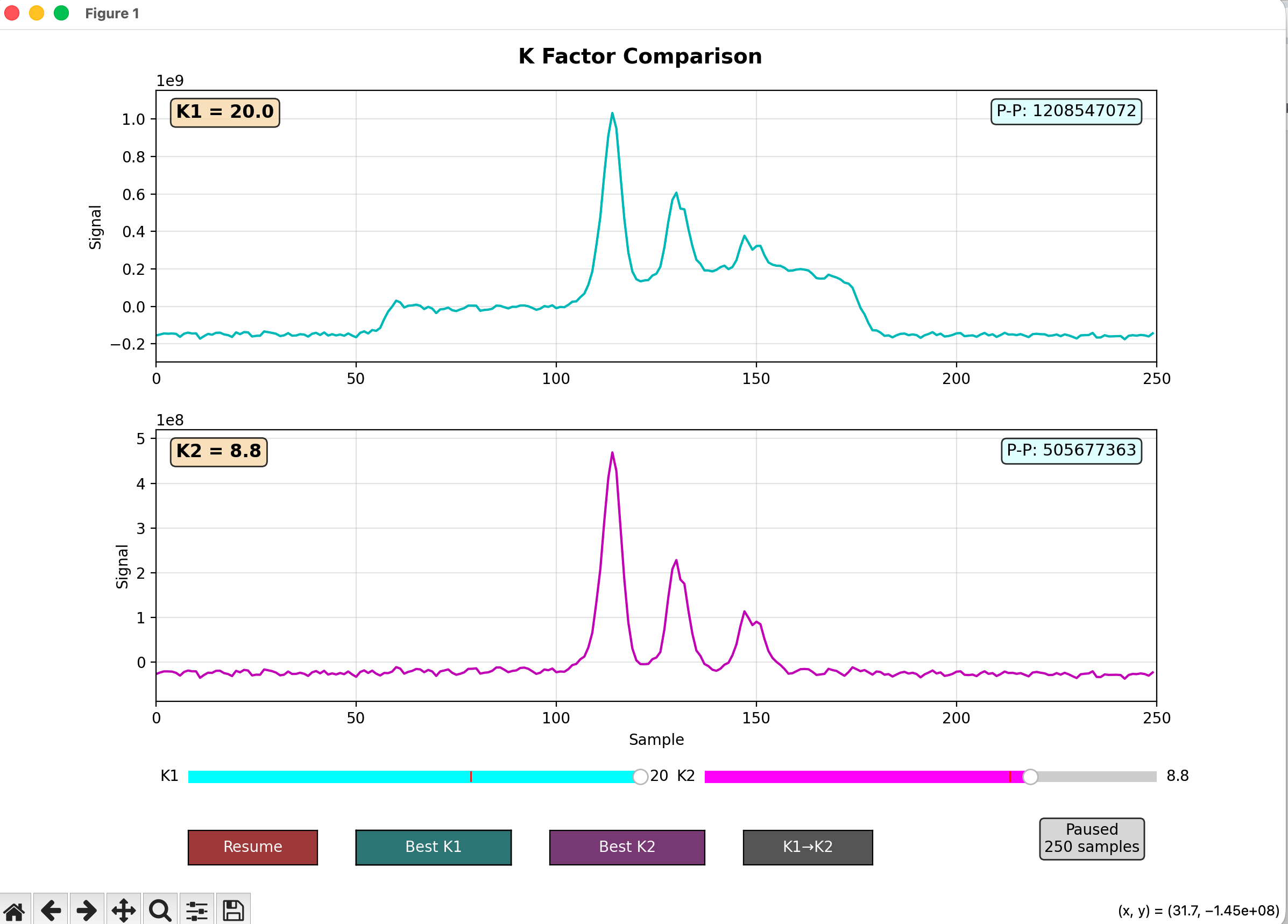

                              Here is coil sweep across large ferrite then crossing 1 gram gold nugget .. this particular nugget is a weak target and was found by a GPZ7000.
                              However the nugget signal clearly is extracted from the background signal.
                              Click image for larger version  Name:	image.png Views:	0 Size:	191.1 KB ID:	444654​
