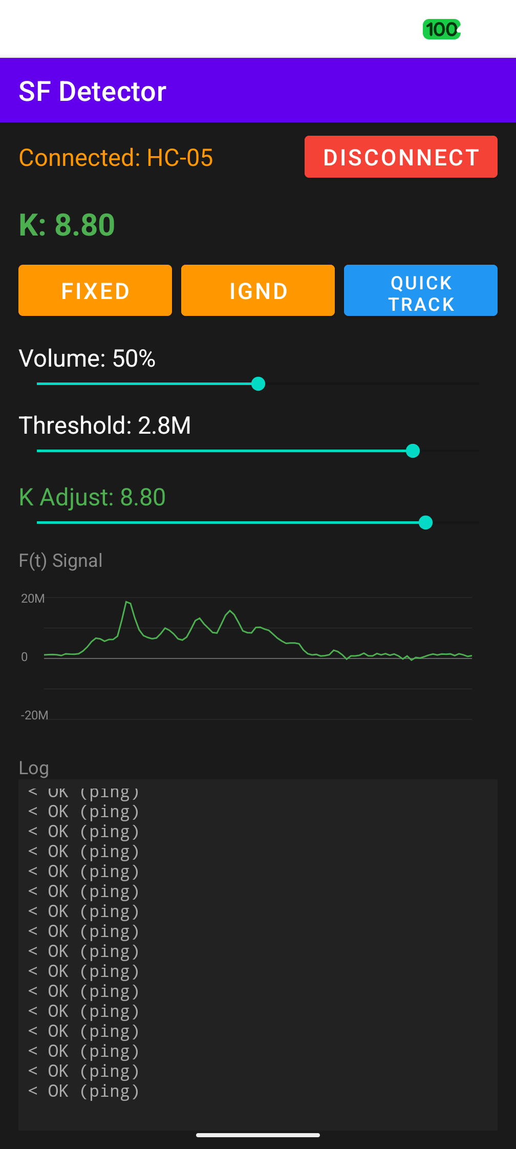

            • ... I've added the code to enable the bluetooth serial interface and a small android app to run the detector in field tests.
              The USB interface is still active but the bluetooth removes the tether.
              The android app provides all the main controls SAT / FIXED, INSTA GROUND, QUICK TRAK, K adjust ( GB adjust ), Audio Volume, Target Threshold.
              Theres a moving graph to show target responses / levels etc.
              I will add the iron channel later .. I am still testing the code.
              Now I just have to move the bluetooth module outside the electronics enclosure because it is causing low level interferance at the ADC inputs.

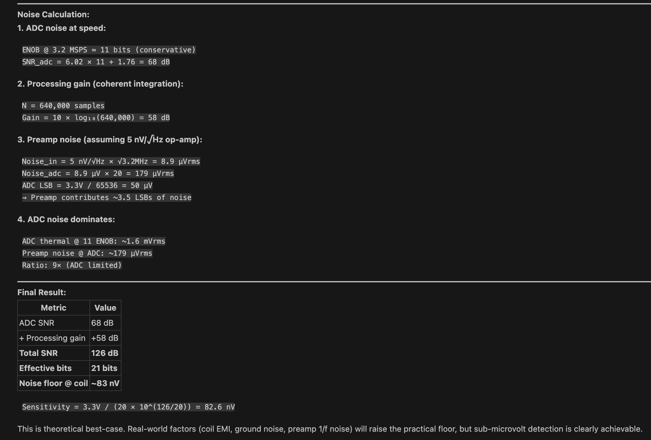

                    • Here is the final performance spec for the field test unit. This pretty much agrees with the experimental results in the lab regarding sensitivity and noise.
                      I would expect the noise ( EMI mainly ) to be less in the field.
                      It also demonstrates that the 16 bit ADC is a good choice ... a 24 bit ADC does not bring significant benefit as it only shifts the noise dominance from the ADC to the frontend.
                      ( remembering that the 16 bit ADC samples much faster than the the 24 bit ADC )

                        • Hi Paul,
                          your final ENOB of 21 bits on a fast 16-bit ADC is quite good. It is even better than most slow 24-bit ADC's can arrive.
                          Well, I don't get the same level of performance on my 192 kHz/24 bit sound card. I'm limitted to relative low frequency responses, which limits the total detector sensitivity.
                          I'm really impressed of your KISS and cheap project. Well done!
