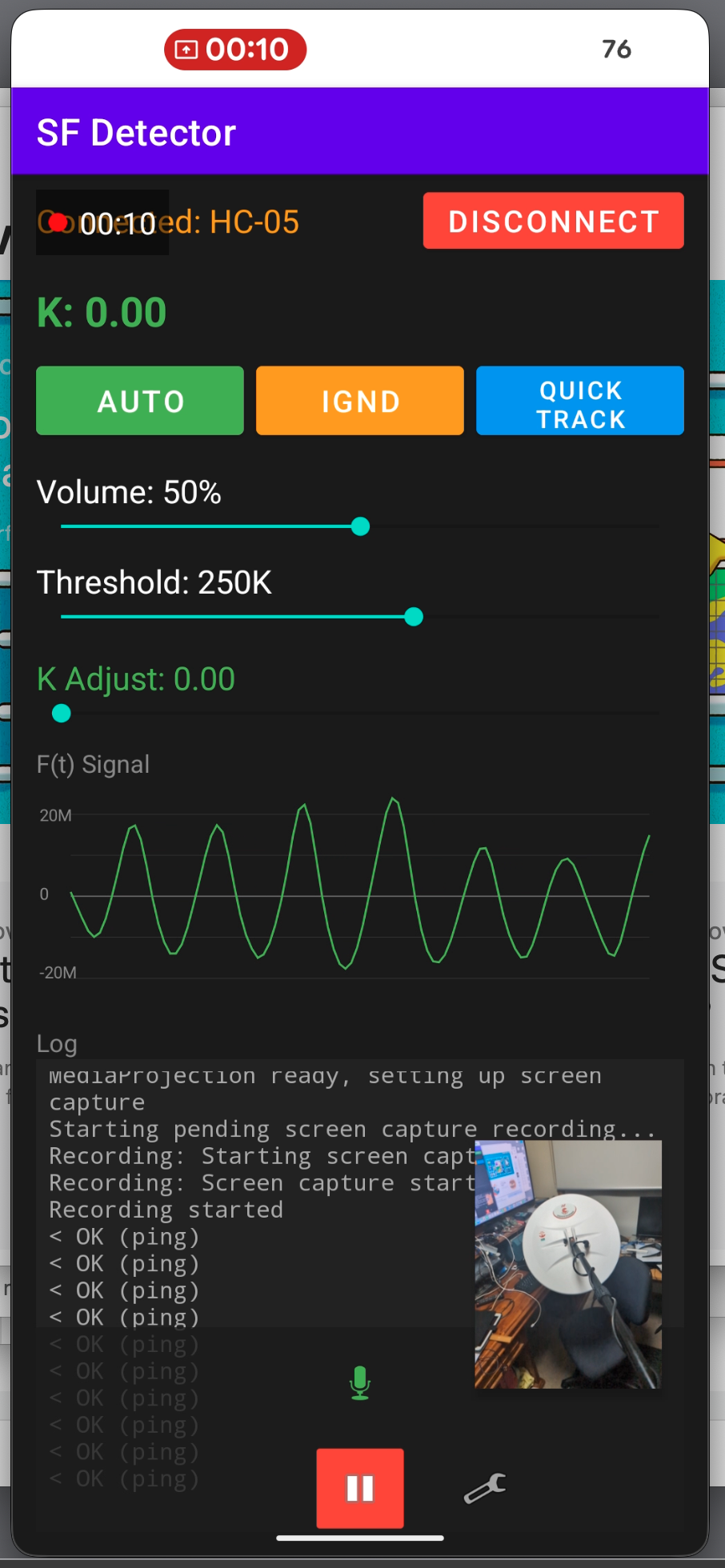

              • The good news .. the ground balance test in the field worked better than expected.
                Easily balanced a range of goldfield grounds except beach ( to do ).
                The bad news ... trying to video one phone (running the detector app) with another phone and holding the detector on a hot day with severe shading and reflections just did not work.
                ...So I have changed the app so it can do all the video work.
                It records the detector app screen in real time and overlays the front or back cam on the screen.
                1 tap toggles the video to full size vs PIP ( picture in picture ).
                2 taps toggles the video back / front cam.
                The PIP may be dragged to any position on the screen.
                The detector app controls are fully functional and will be captured if you are recording.
                You can stop or start recording obviously and sound may be captured or muted.
                Video is captured as MP4
                The default is PIP ( recording off ).
                Below is a screen shot from a short video shot just now in the lab ... .... might add timestamp and GPS coordinates ( or not ).
                This should make detector videos in the field really easy ... I hope.

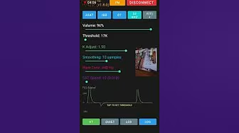

                        • Here is the FCMD app video .... the video was made by the app itself ( no editing ).
                          This makes detector videos super easy ..

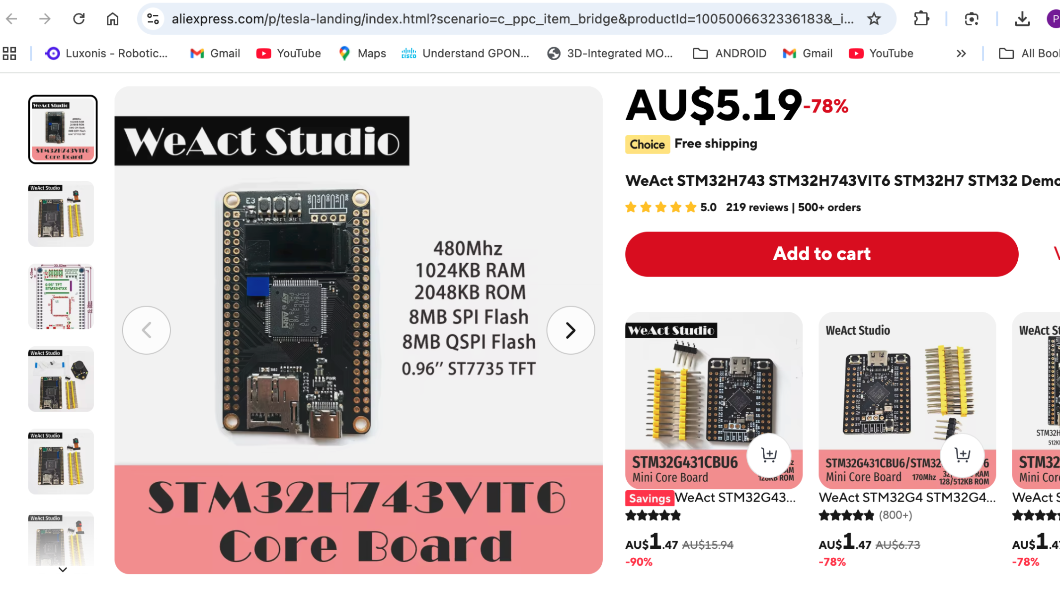

                              • Hi Paul,
                                maybe I should buy a few STM32H743VIT6 boards to be able to use your ultimate detector soon.
                                The STM32 boards are really quite interesting.
