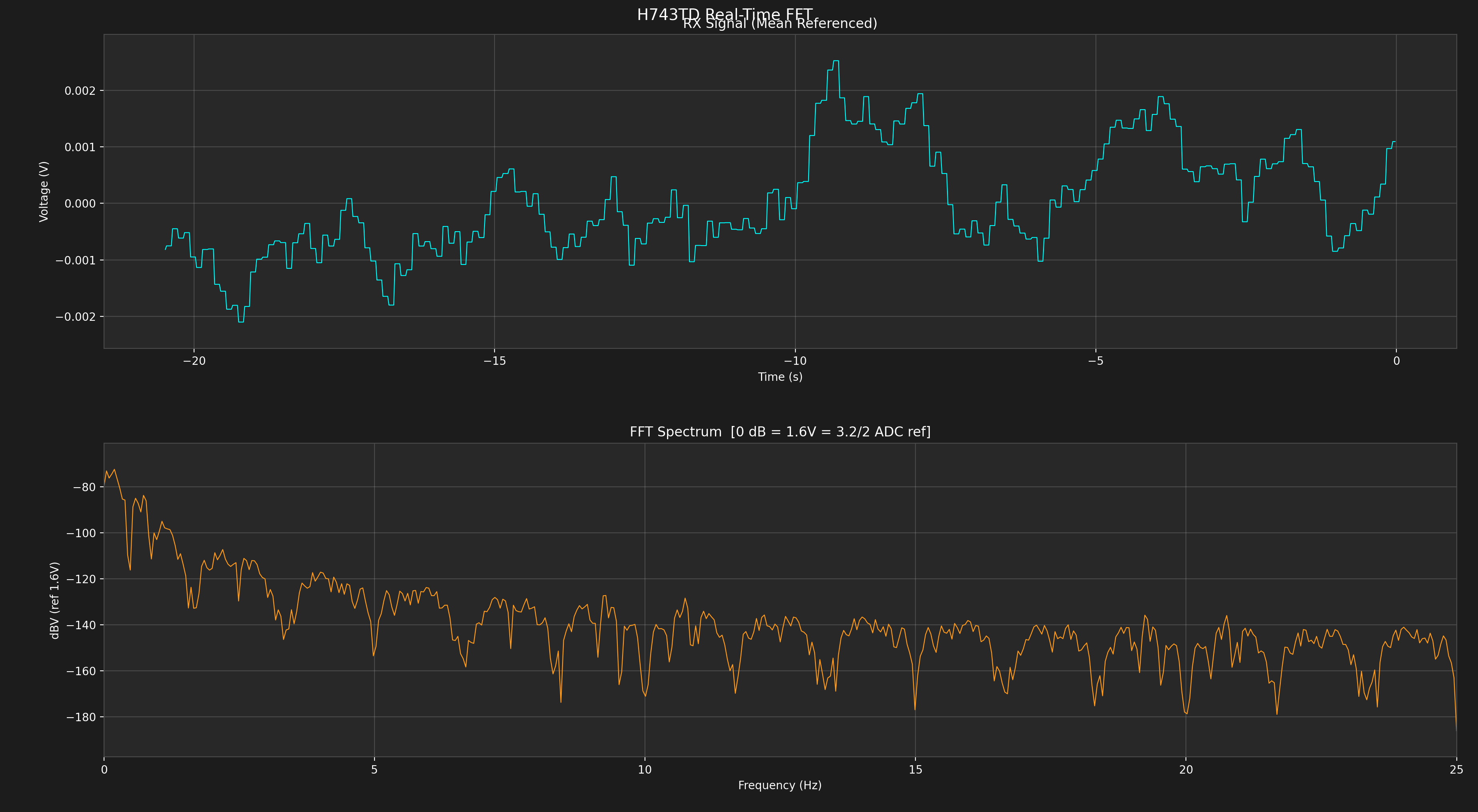

      I would not bother with an external ADC unless it was 24 bit or more. The ADC implemented on the H7 series is a "proper" 16 bit SAR ADC.
      On the H743 there are 3 of these onchip ADCs ..
      Below is the demodulated ( 0 - 25 hertz ) noise floor of the current firmware running on the chip with the coil connected and the TX running in a noisy lab environment.
      we are interested in around the 5 hertz point ( target sweep speeds ) ... the adc is better than -120 db in noise performance. This rivals alot of so called 24 bit converters.
      The real benefit is the tight integration of the ADC to the CPU ... and the H743 is a cheap chip ..
      you will be hard pressed to build a better combo unit using an external ADC that is anywhere near this price point and performance.

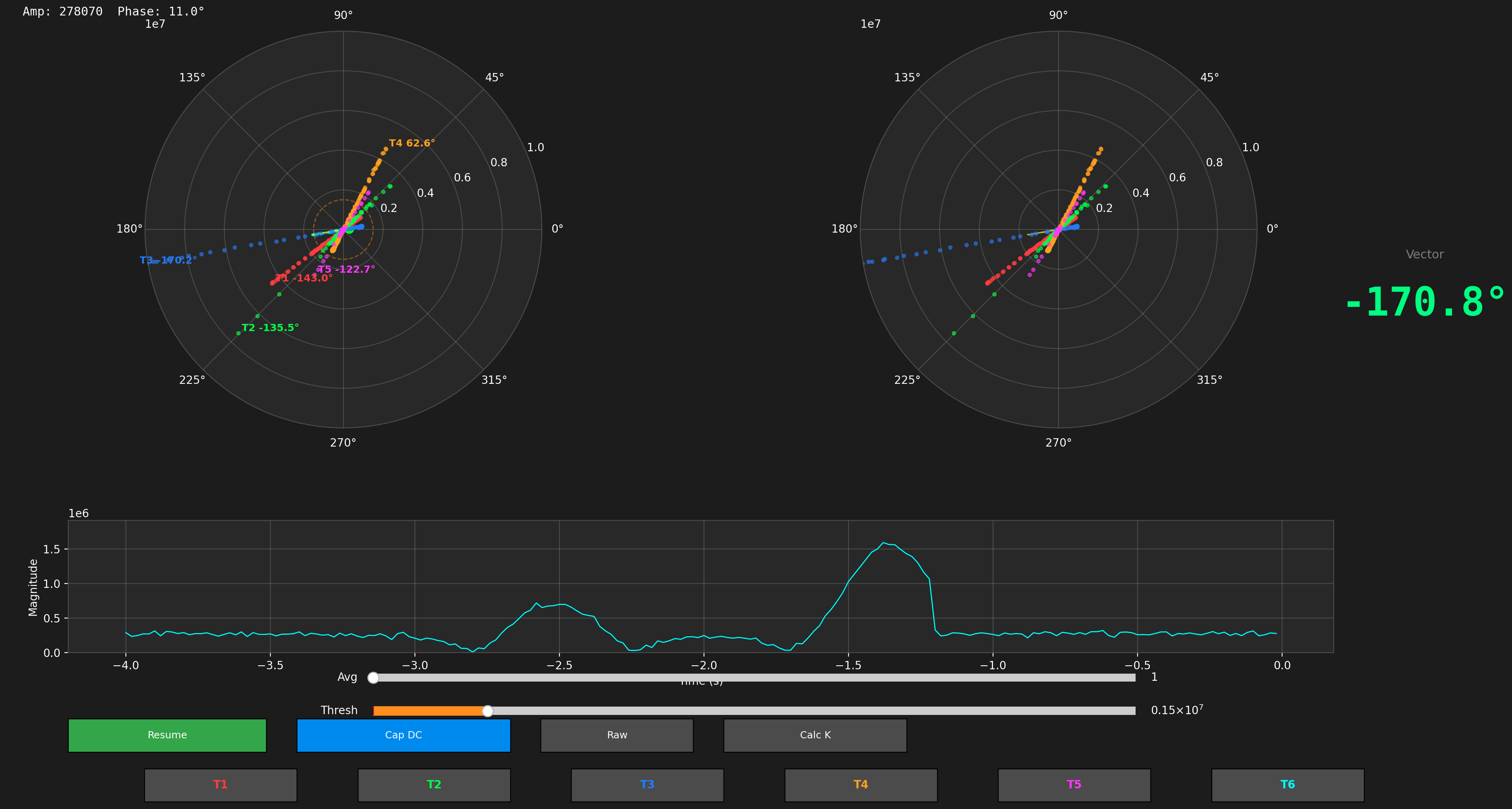

            • ..so we have achieved good sensitivity for target detection in FCMD.
              We are now getting the corresponding accuracy in discrimination ( without phase rotations or reference phases I might add ! )
              The phase accuracy is not impacted by GB either. ( though amplitude will drop a bit for some targets aligned in the phase plane with the ground. )
              Below we have copper, silver, gold, al foil, ferrite.
              The orange ring is the threshold setting ... anything exceed the threshold gets a phase tag.
              Theres no EMI ... because EMI is not a big issue in narrowband systems ( Aziz )

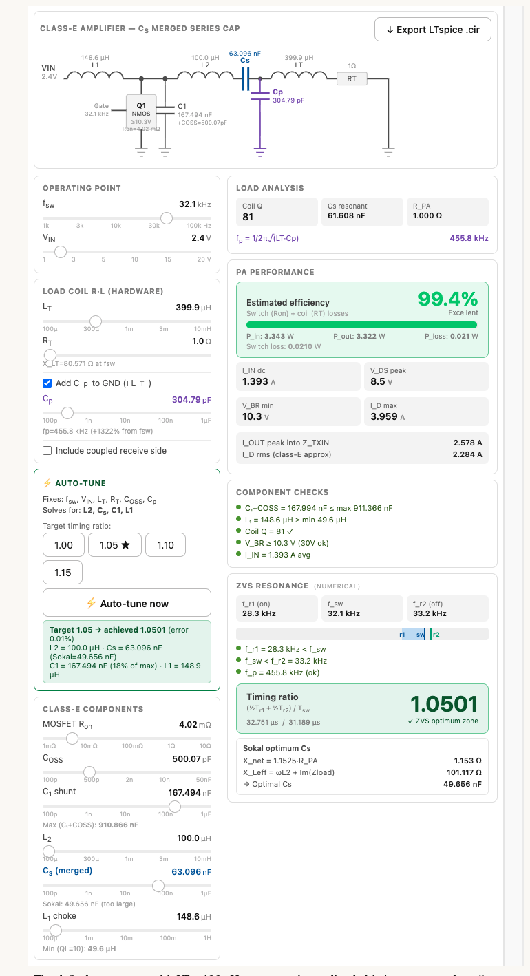

                    • I have been using the bipolar pulsing H bridge which uses 6 mosfets + driver chip ..... the bipolar square waves are nice and wideband but produce transitions that cause problems in the RX chain.
                      So I am switching ( there is a small pun there ) to an E class amplifier to generate the TX signal.
                      This amp only uses a single mosfet and some passive components.
                      It was invented back in the 70s.
                      The secret sauce is in the component values and the timing ... especially the timing
                      Even though the circuit is simple ... there is alot going on in there.
                      LT is the transmit coil.
                      There is also an F class amplifier ... that is for harmonics ... Its not suitable for the FCMD so I did not use it.
                      Long story short I got the AI to build me a fully auto pushbutton tool that generates the correct values for the E class amplifier and now I am looking at very nice high power efficient transmit signals.
                      It might look like the components have to be spot on ... but that is not the case. When you find the operating point using the tool the amplifer can work over a range of timings / frequencies.
                      Below is the tool ... I am still modding it so no point releasing anything yet.
                      It also builds an ltspice circuit once you find your optimal specs so the simulation can be checked.

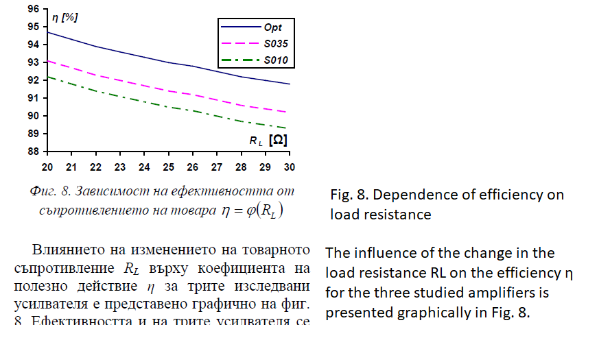

                            • In practice, that's not exactly the case.
                              Abstract
                              "The Class E power amplifier has a big popularity because of its high efficiency. The above can be achieved in optimum class E when both soft commutation conditions have been met– zero voltage and zero voltage slope of during turn on. Meeting only the one of the above conditions is described as sub-optimum mode".
                              The graph below is for three modes:
                              - optimal s = 0
                              - suboptimal s < 0
                              - suboptimal s > 0​
Name:	efficiency amp class E.png
                              The actually achieved efficiency coefficient is almost 95% in optimal mode.
