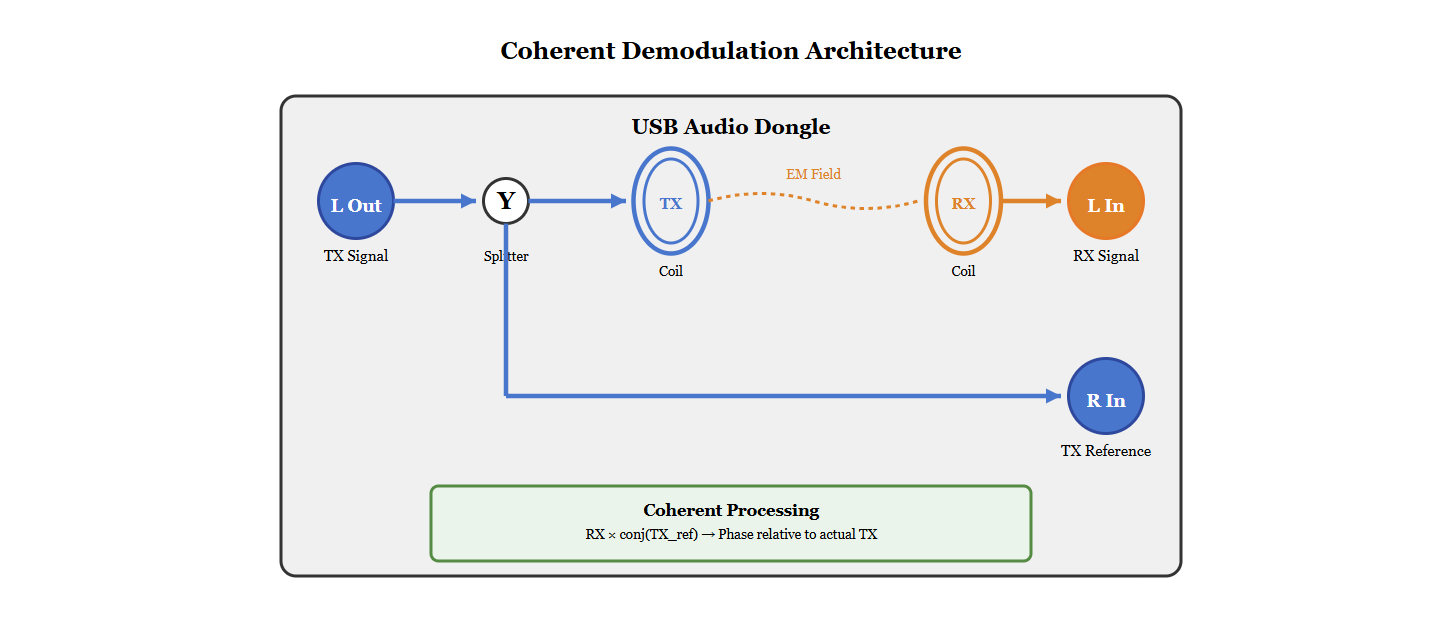

                    I asked the AI to draw a diagram of the hardware and it added a new section to the eBook with writeup and diagrams ...
                    The small powered USB hub is so we can power everything and maybe add other stuff :-)

                      ​This is true for all IB detector designs. But what, exactly, is being used as the phase reference? The TX voltage? The TX current? Something else? It has to be something, somewhere, or the whole scheme won't work.
                      ​Since the demodulator runs in the same process as the transmitter, using the same sample rate and clock source, it's inherently synchronized - no PLL or carrier recovery needed.
                      ​Tell AI that wasn't the question.
                      3. Relative Phase is What Matters
                      For metal detection, what's important is the phase shift caused by metal targets, not absolute phase. The demodulator measures phase relative to the transmitted signal. When metal distorts the electromagnetic field, it creates a phase lag that shows up in the I/Q components (lines 81-82, 96):
                      ​Yes, it's a phase relative to the TX "signal". In ITMD3, I consistently use the TX magnetic field as the reference phase because, physically speaking, it's an absolute reference that does not rely on any circuit characteristics, such as coil reactance. It is 100% consistent no matter how you design the detector. And with this reference, ground is always close to 0°, magnetic targets are always 0-90°, and eddy targets are always 90-180°. Makes everything conceptually simple. If you read patents (and I'm sure AI does this) you will find that different people have used different phase systems so there is little consistency. This is bound to confuse an AI analysis of those patents.

                        One thing led to another and then I remembered that there are small USB audio card dongles that register as a separate and independent device to the Windows system.
                        The price is a couple of dollars and anyone can get them everywhere.
                        I don't know how easy it is to do this under Android, but it's easy under Windows.
                        Click image for larger version  Name:	image.png Views:	0 Size:	294.2 KB ID:	442328​
                          The reason that phase references are not needed is because time does not exist in software code. Its just code ... it has no time dimension. However time does exist once it comes outside the CPU where a real time TX and RX signal is generated. Just because you tell the Codec to produce 20 KHZ .. does not mean that the RX will sample at the same rate. So testing the hardware showed phase rotations occurring due to this problem.
                          So now we ( me and the AI :rotfl ) use this scheme and it actually works because it compensates for the real world loop timing errors. See section 8 in the eBook its been updated.
                          We just use the real TX signal as the demodulation Local oscillator signal. This compensates for the problem with the phase rotations due to CODEC clocking differences between TX and RX.
                          I tested it with real hardware it works !
