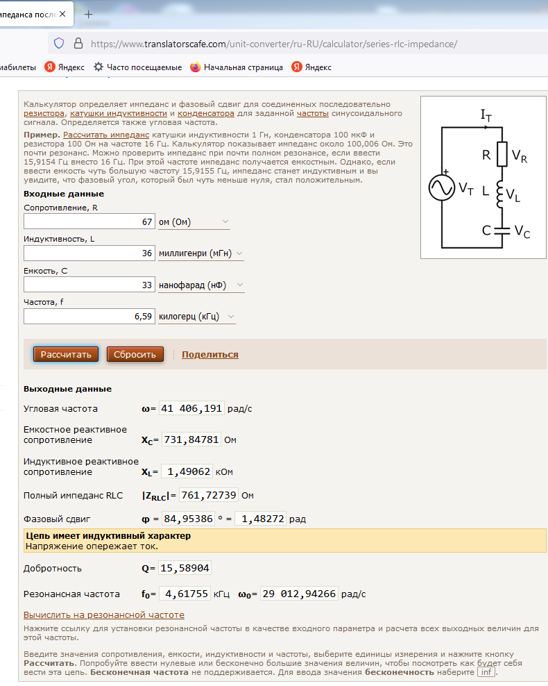

    You'll have to explain more because I don't understand. In a circuit where the RX coil is loaded by a simple resistor (say, 10k) then the phase shift of the RX coil is practically zero even with a coil resistance of, say, 100Ω. Even if you lowered the load resistance enough to create a phase error, it would still be reasonably constant and would simply be removed by the ground balance calibration, along with the phase shift of the preamp.
    Ground permeability can cause a shift in the inductance value but it is typically a very slight change and, for a resistively loaded RX coil, still won't make any difference. The IDX RX coil is capacitively loaded but I assume it is set considerably off-resonance of the TX frequency precisely to avoid issues with the Q causing variations in the phase shift. In the end, I can see how the RX coil resistance can matter where the RX coil is resonated at the TX frequency, but otherwise not so much.
      The detector measures two parameters simultaneously: amplitude and phase. Changing the sensor's impedance in the presence of soil changes the measured values ​​simply by changing the distance to the ground surface. This introduces additional noise, reducing target sensitivity.
      To reduce noise in the presence of soil, the sensor's impedance must be phase- and impedance-matched to the ground.
      The transmitter (TX) is phase-matched, and its active resistance is selected based on the required magnitude of the generated field. A non-resonant LR oscillator or a detuned LRC oscillator with external excitation is used (an extreme case is a low-Q oscillator).
      The receiver (RX) is phase-matched, and its active resistance is selected based on the conductivity of the surrounding soil in the search field. (An example calculation for the sensor described above is shown in the image.)​
        On the RX side, I agree that RX coil resistance creates thermal noise which is detrimental. But 50Ω adds less than 1nV/rtHz which is lower than most of the preamps used in VLF designs. The effect of RX-R on the phase depends on whether the coil is loaded with a simple resistor, parallel resonated with a cap (either on-resonance or off-resonance), or is series resonated. As long as the self-resonant frequency of the coil is well above the operating frequency, the only situation I see where the series resistance makes any difference is for parallel on-resonance. Again, I've never heard of anyone designing the RX coil to match the ground's loss angle. Finally, the example calculation is for a series RLC circuit, so I don't understand the relationship.

          "Finally, the calculation example is given for a series RLC circuit, so I don't understand the relationship."
          We don't have a separate EMF source feeding the parallel oscillatory circuit through the source resistance. The EMF is generated within the oscillatory circuit, and the current flows sequentially through all the elements of the RLC circuit, meaning we have a classic series oscillatory circuit.​

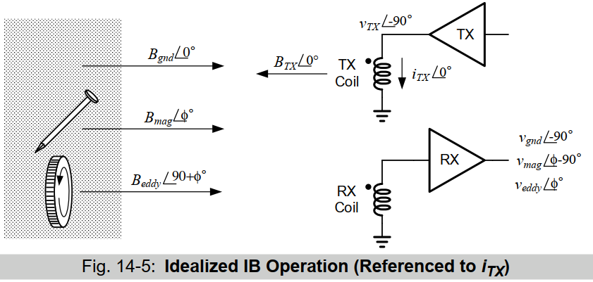

                            If you are looking at the magnetic fields, then perfect ferrite is 0°; the B-H curve has no gap so it distorts the magnetic field but causes no delay. If you are looking at the induced voltage on the RX coil, then ferrite is -90°.
                            A thin shorted ring produces a 90° magnetic phase shift, or a 0° phase shift in the induced RX coil voltage.
                            Heavy pure silver (Atocha bar) produces a 180° magnetic phase shift, or a 90° phase shift in the induced RX coil voltage.
                            Here is how to look at it using the TX magnetic field as the reference:

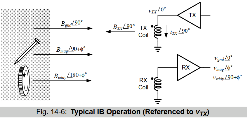

                            Here it is when using the TX drive voltage as the reference:
