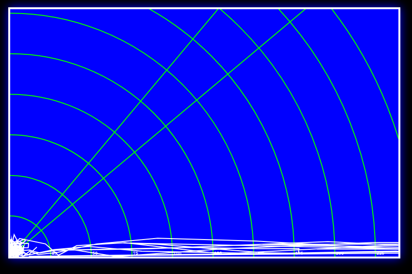

    this is for ferrite, 0.8 deg​
      Ferrite is a ferromagnetic material similar to iron. It generates a magnetic field due to its magnetizing properties. This magnetic component is the reactive component of the secondary field.
      Energy is not wasted because, due to the dielectric properties of ferrite, no current flows through the target, meaning the active component tends to zero.
      At the receiving end, you should observe a phase similar to that of the ferromagnetic target and an active component close to zero.
      This is what I demonstrated in post #26. This is the target's response to the pulse, which is independent of phase coordinate rotation, since synchronization occurs from the leading edge of the pulse in time.​

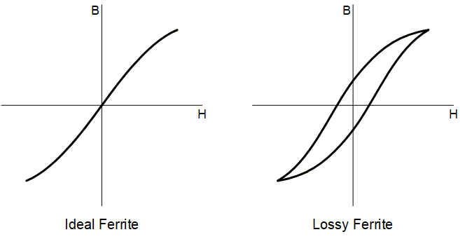

        The phase response of ferrite depends on how much hysteresis is in the BH curve:
        An ideal ferrite has no hysteresis and the loss angle is 0°. The hysteresis in a lossy ferrite will elevate the loss angle; the one shown might be 10-15° which is rather extreme for a ferrite. A lossy ferrite still has near-zero conductivity but the hysteresis causes a real power loss as energy is needed to overcome the coercivity. Iron targets tend to have a decent amount of hysteresis, plus conductivity that creates an eddy component, so there are two response mechanisms happening at the same time.

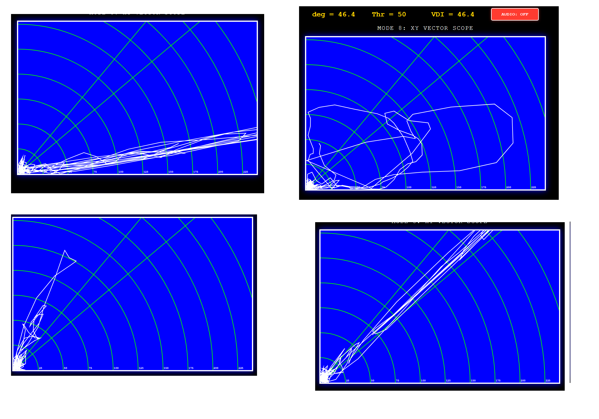

          Specifically, this hysteresis causes the response from the iron target in the device's hodograph to become broader in phase than the response from the non-ferrous target when the sensor is moved over the target.
            Yes, and the combination of magnetic response and eddy response can send the hodograph all over the place. Bottle cap:

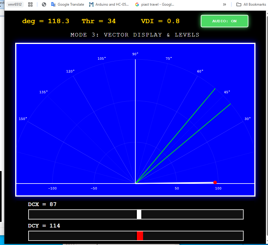

              ferrite, beer cap, cola tab, coin​
                ground blanced ferrite ​
