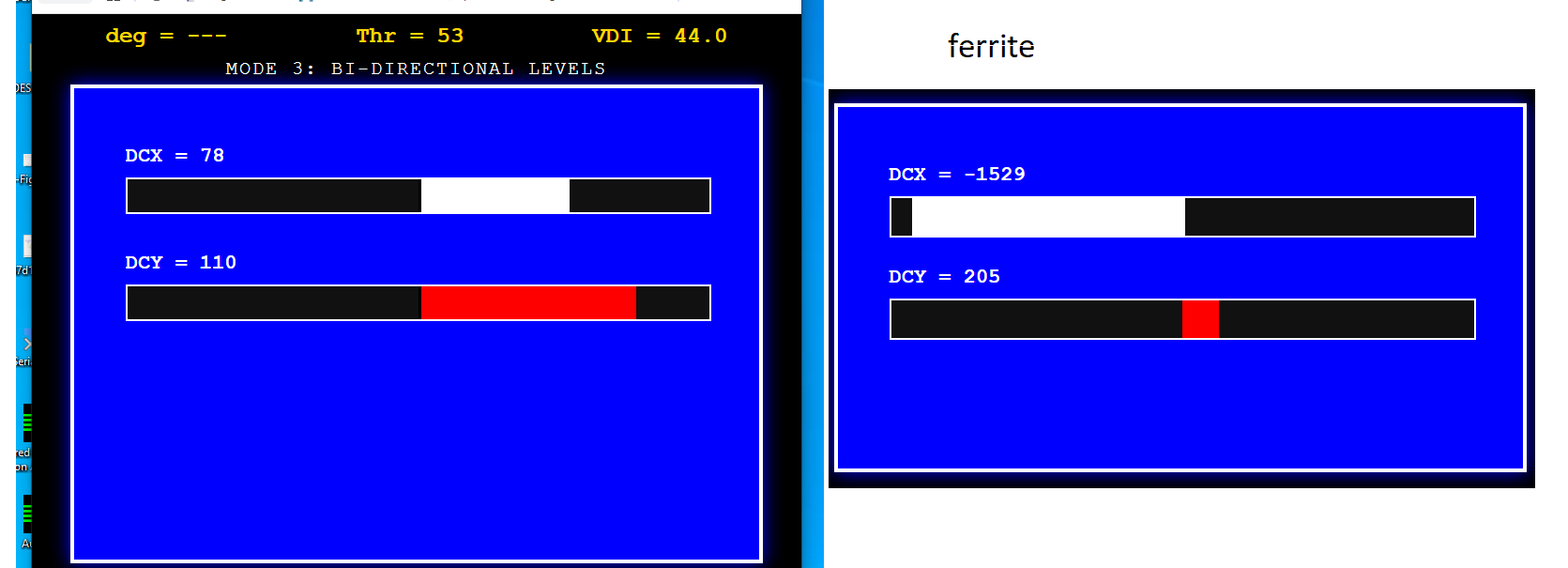

    Hi, Carl-NC
    Does the detector operate according to different physical laws?
    The conductivity of ferrite is close to zero (infinite resistance), meaning there is no active component of the current. Consequently, there is no active component at the receiving end, and no voltage with phase = 0 is generated. Due to the inductive nature of the interaction with the target, the received signal is inverted, and the inductive nature of the ferrite and soil generates a negative voltage on the reactive component of the received signal (-90 for ferrite, -84...-87 for soil).
    For a closed thin ring, there is no reactive component due to magnetization—only the active component of the flowing current with phase = 0 is present.​​
      We're saying the same thing, but the phase you get depends on whether you are looking at it in terms of magnetic field or induced voltage on the RX coil. That's what I was showing in post 14. There is always a 90° phase shift in the RX coil due to Faraday's Law.
        Hi, Carl-NC
        In the Cartesian coordinate system, any reactivity has a phase shift of +90 or -90, and the active component has a phase shift of 0 or 180. Under no circumstances can reactivity become an active component, except in cases where this occurs in a person's false imagination.

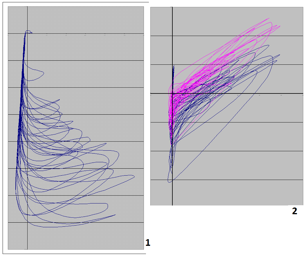

              About phases...
              1. Real signals from a diamagnetic metal embedded in the ground, on a real device (not calibrated with ferrite), in a Cartesian coordinate system.
              2. The same conditions, but with ground signal suppression (subtraction) in real time. Ignoring the ground signal by rotating the phase axes is useless here...

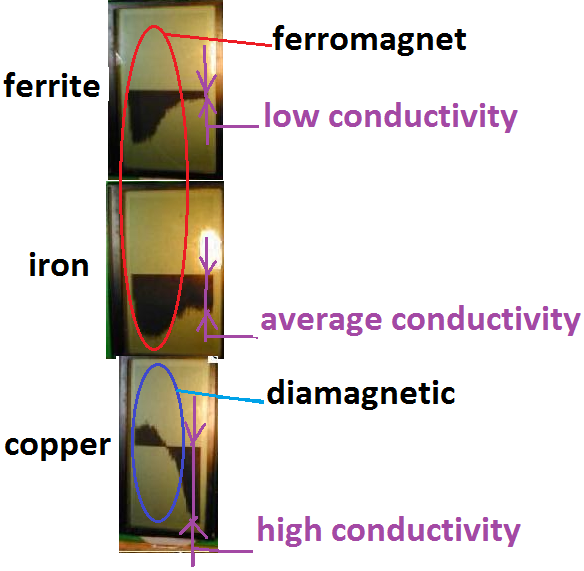

                      You may be able to correctly locate the ferrite based on the transient response of the pulses.
                        Originally posted by Sergey_P View Post
                        Hi, Carl-NC
                        For some reason the image didn't connect
                          post #26, can yoy show for aluminiun, brass, gold ?
                            Sorry, the image shows aluminum, not copper (I made a mistake). Copper would look similar to aluminum, only more elongated to the right, just over 64 µs. (I already mentioned this in Aziz's thread.)
                            Brass is completely impossible to identify, as it's an alloy of various metals and can be either ferromagnetic or diamagnetic.
                            I'm not interested in gold, so I didn't take a photo of it.
                            I pulled the breadboard out of the trash... after 15 years, the flash memory in the controller has leaked, so I can't show anything. The breadboard doesn't have an ADC, only a comparator (sign correlator), which evaluates the target signal relative to ambient noise.​
