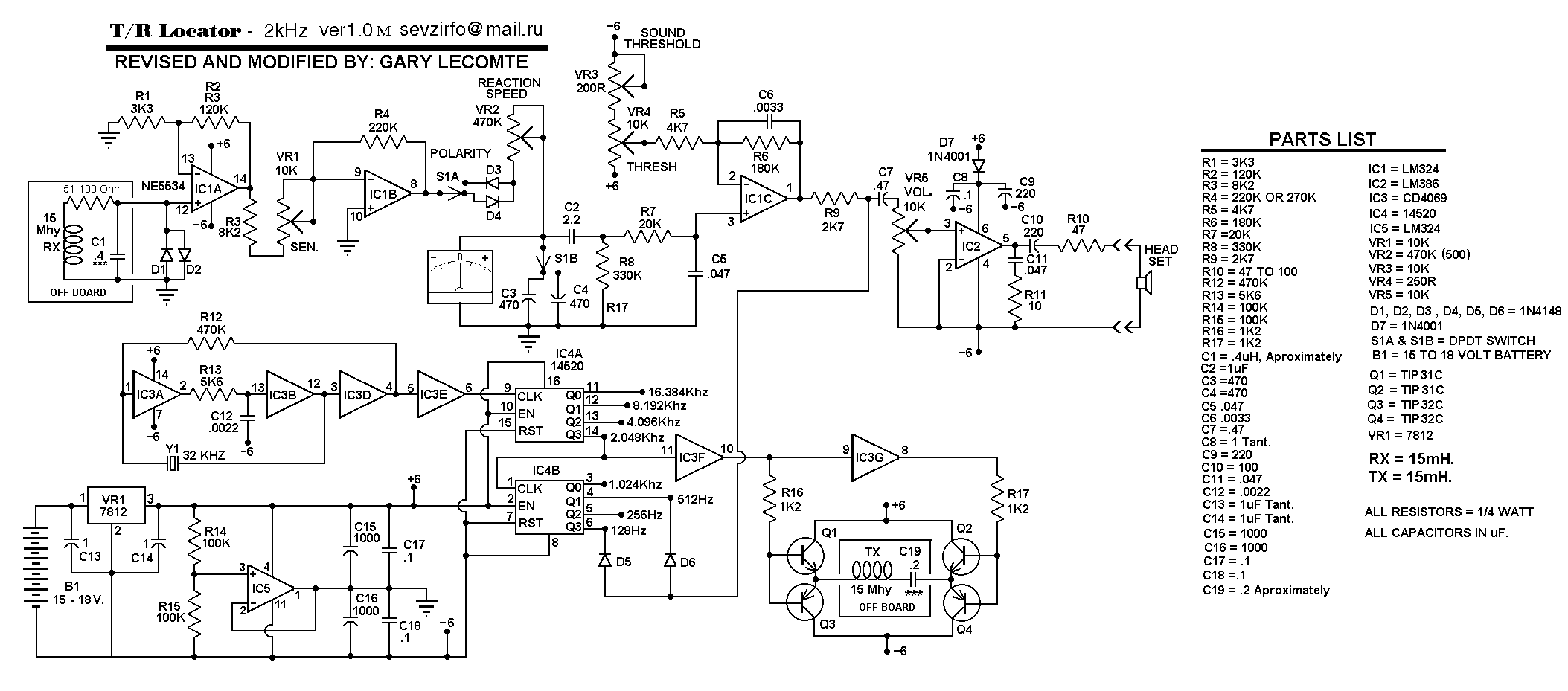

    Hi everyone
    a little help please
    i followed the instruction to build TR locator / 2 box

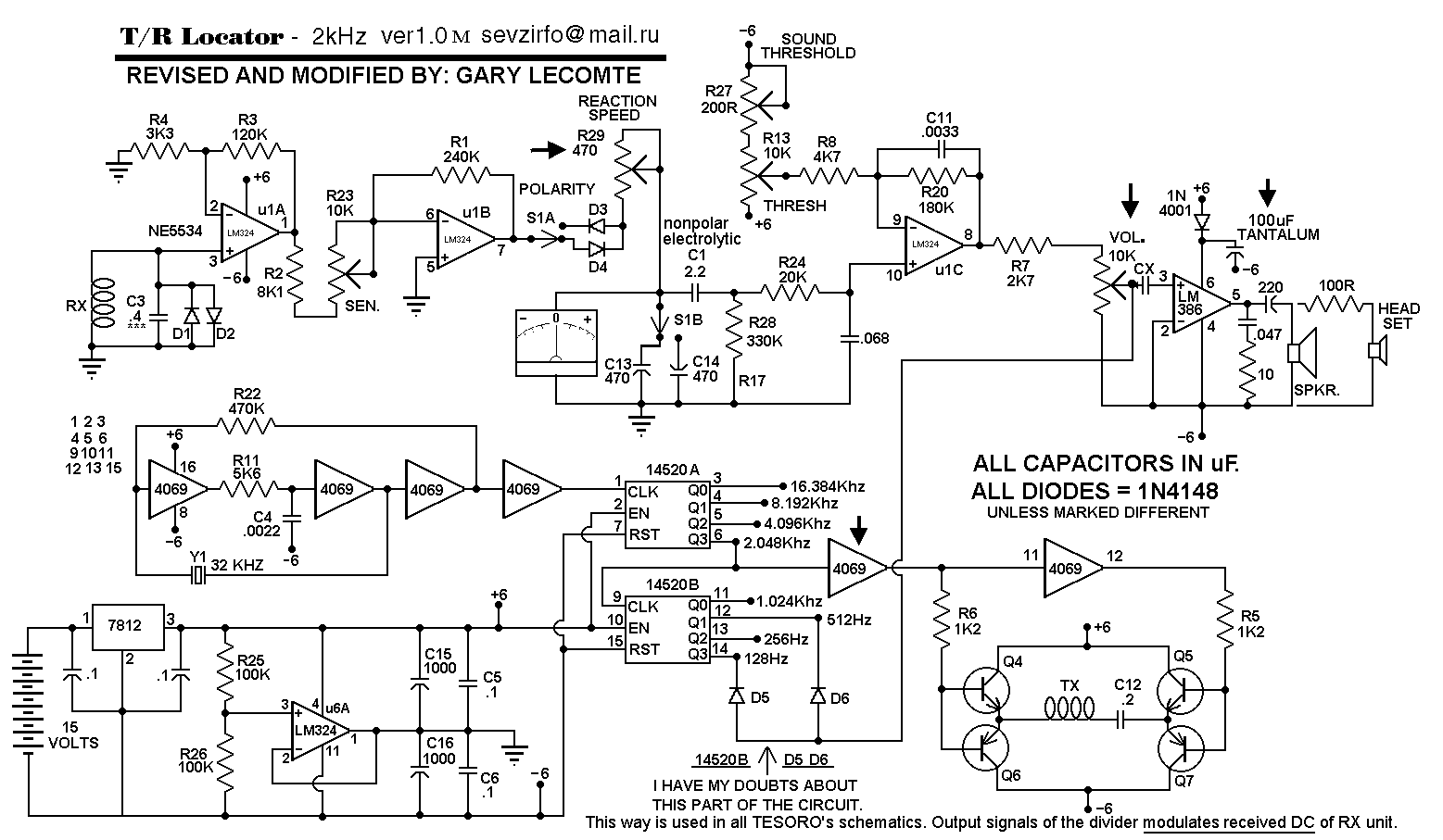

    i used this latest know working schematics
    instead of transistors TIP31C TIP32C i used TIP41C TIP42C which are a bit robust
    i used 16 mhz quarts which gives me 3.3 khz, i did try 32mhz the obtained coil frequency was about 5 khz= 4891 KHZ
    last quartz i put gave me the exact frequency as mentioned in the project = 2048hz
    both my coils TX and RX when measured using LRC meter gives 7.00 mh
    TX= wire diameter is thicker 0.8 mm and coil resistance is 13 ohm
    RX= wire diameter is 0.6 mm and coil resistance is 5 ohm
    when calibrating ; i put the coils facing each other , beyond 30 cm distance there is no recepetion at all on the RX coil

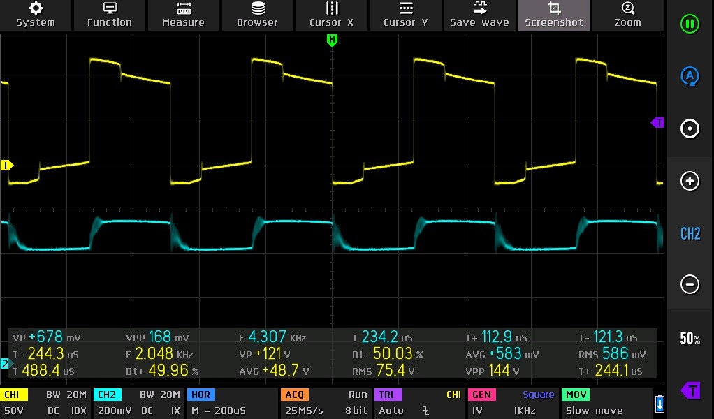

    the obtained results at 30cm on the scope are shown in the picture
    Yellow is TX
    Blue is reception RX
    **problems**
    i need more distance than 30 cm ( the advertised distance for two box is greater than 2 meters for big objects)
    there is no significant audio change on the headset whenever i put a big object between the two coils or whenever moving them inward or outward
    --Question--
    Can you help me what is it that iam doing wrong ?? ****Thanks in advance​****

    The circuit calls for 32kHz crystal
    A T/R Two-Box locator operates on the principle of Induction Balance (IB).​​
    ​Severe Resonance Mismatch:
    Currently, your TX coil and capacitor are far out of resonance, which drastically reduces the strength of the transmitted magnetic field:
    Your Setup: You have a 7.00 mH coil connected to a 0.2 µF capacitor (C12). This results in a resonant frequency of about 4.25 kHz.
    Because your circuit is driving the coil at 2.048 kHz but the tank is tuned to 4.25 kHz, very little current flows through the TX coil, resulting in a incredibly weak magnetic field.​
    To make a 7.00 mH coil resonate at 2.048 kHz, you need a capacitance of approximately 0.86 µF.
    ​Incorrect Coil Orientation:
    You mentioned that you "put the coils facing each other."
    The TX and RX coils must be mounted perpendicular (orthogonal) to each other (typically one flat/horizontal and one upright/vertical) at opposite ends of a rigid frame (usually 1.5 to 2 meters apart).
    You must physically adjust the angle of one coil slightly until you find the "null point"—the exact position where the RX coil receives zero (or minimum) direct signal from the TX coil. Only when the system is perfectly nulled will an external metal object disturb the field and trigger a loud audio change.

    The oscilloscope screenshot confirms exactly why your detector is not performing as expected.
    Looking closely at the on-screen data, the yellow waveform (TX) is being driven heavily into standard square-wave/switching distortions rather than a clean, high-amplitude sine wave, and the blue waveform (RX) reveals that your receiver is heavily saturated.
    • CH1 (TX) shows a frequency of 2.048 kHz. This is your digital micro/quartz clock driving the transistors.
    • CH2 (RX) shows a frequency of 4.307 kHz.
    This heavily confirms the mathematical resonance mismatch. Because your 7.00 mH coil and 0.2 µF capacitor inherently want to vibrate at~4.25 kHz - 4.3 kHz, the RX circuit is actually picking up the sharp, higher-frequency harmonic edge spikes of your square wave rather than your true 2.048 kHz base signal. When a tank circuit is forced to run so far outside its resonant frequency, power transfer drops to near zero.
    Re-tune the TX and RX Tanks:
    You must force the hardware tank frequency down to match your digital driver. Add capacitance in parallel to your existing C12 and C3 capacitors until you reach roughly 0.86 µF. Alternatively, you can temporarily test a standard 1 µF film capacitor on both tanks; this will bring your resonant frequency closer to ~1.9 kHz, which is much closer to your 2.048 kHz driver than your current setup.
    ​Change Coil Orientation to "Null" the Signal:
    Right now, your blue RX channel is reading 168 mV at 30 cm away while facing directly. When you mount these coils onto a two-box chassis frame (spaced roughly 1.5 to 2 meters apart), orient them orthogonally (one flat, one vertical). Watch Channel 2 on your scope and mechanically tilt one coil until that 168 mV reading drops as close to 0 mV (the null point) as possible.

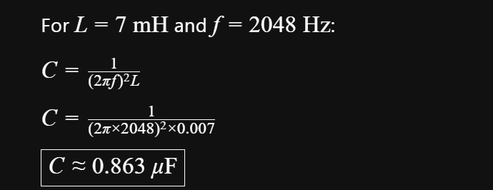

                        I couldn't get it to resonate although i put several values of capacity
                        i only got the resception to about 1khz - 8khz its oscilating very much whatever capacity value i put
                        i did follow one recommendation to put 0.82uf on both sides to get near resonance
                        but i dont know the exact equation of calculus to obtain the capa value
                        the coils are 40cm by 30cm
                        Tx= 2048 Khz coil ind= 7mh needed capacity =?
                        is the above calculus right ??​
                        i need all the help i can get Thanks again sir

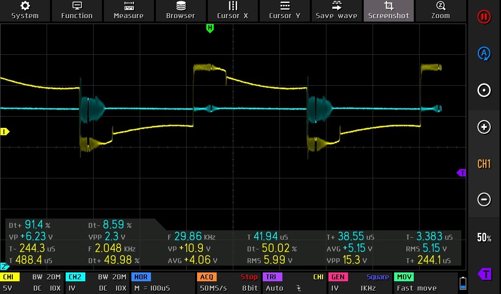

                          This is the scope readings with cap 0.8uf on TX and none on Rx
                            Yes, 0.8 is OK. Place oscilloscope probe directly across the TX coil, before the series capacitor.​
