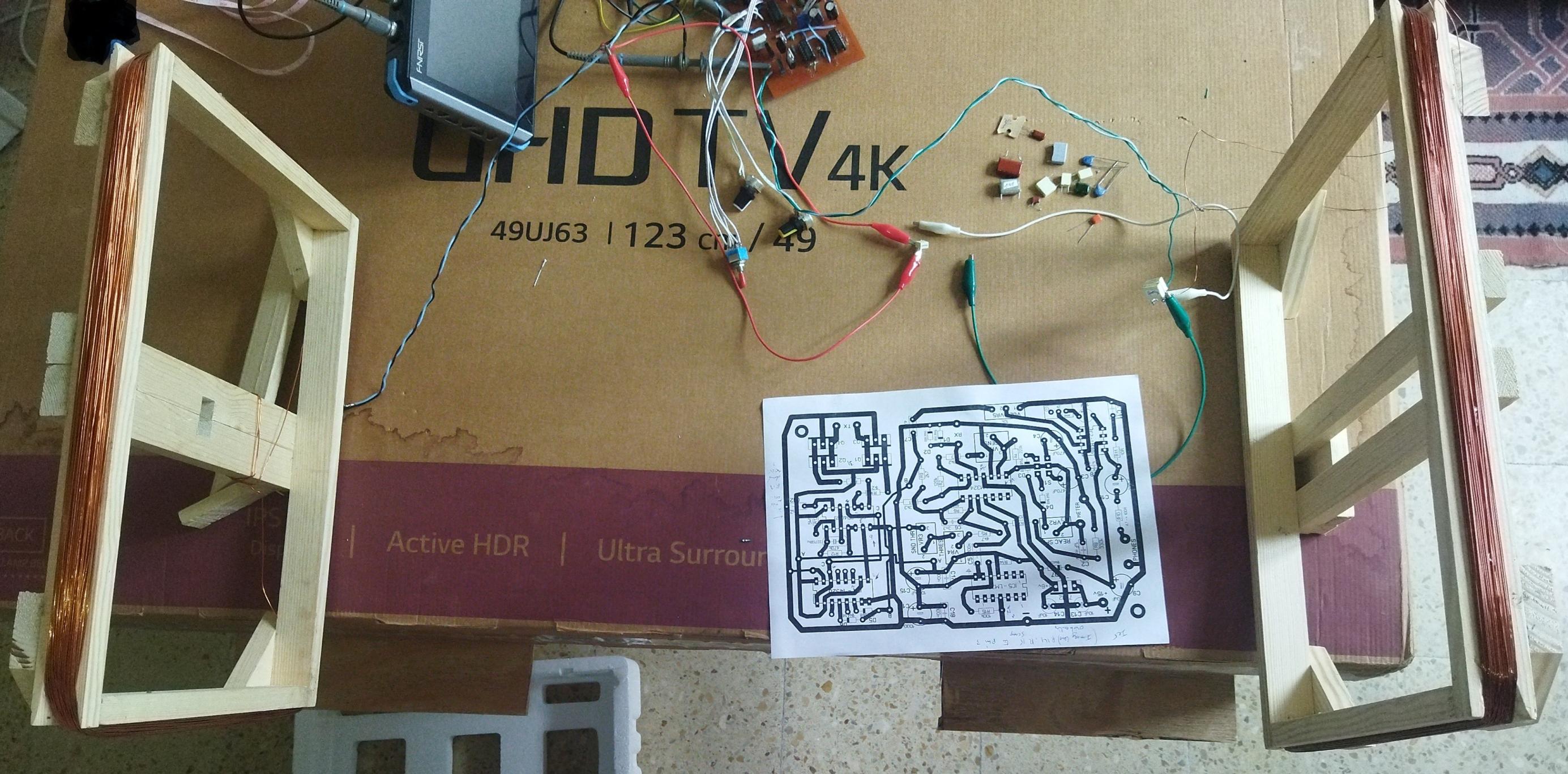

              THIS IS MY full SETUP

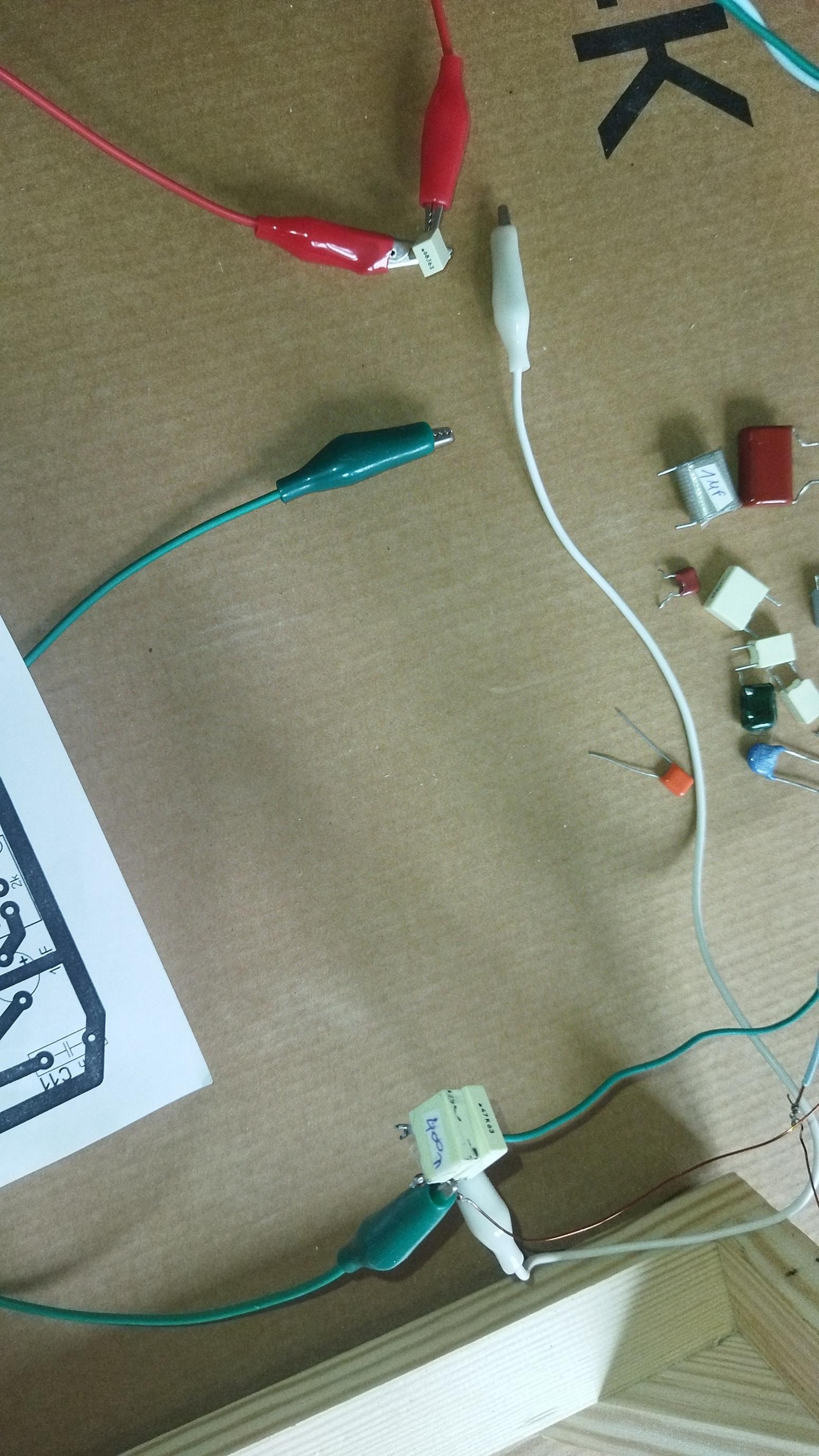

              small clips to put different capacities
              two in red in parallel for RX
              green and white in series for TX

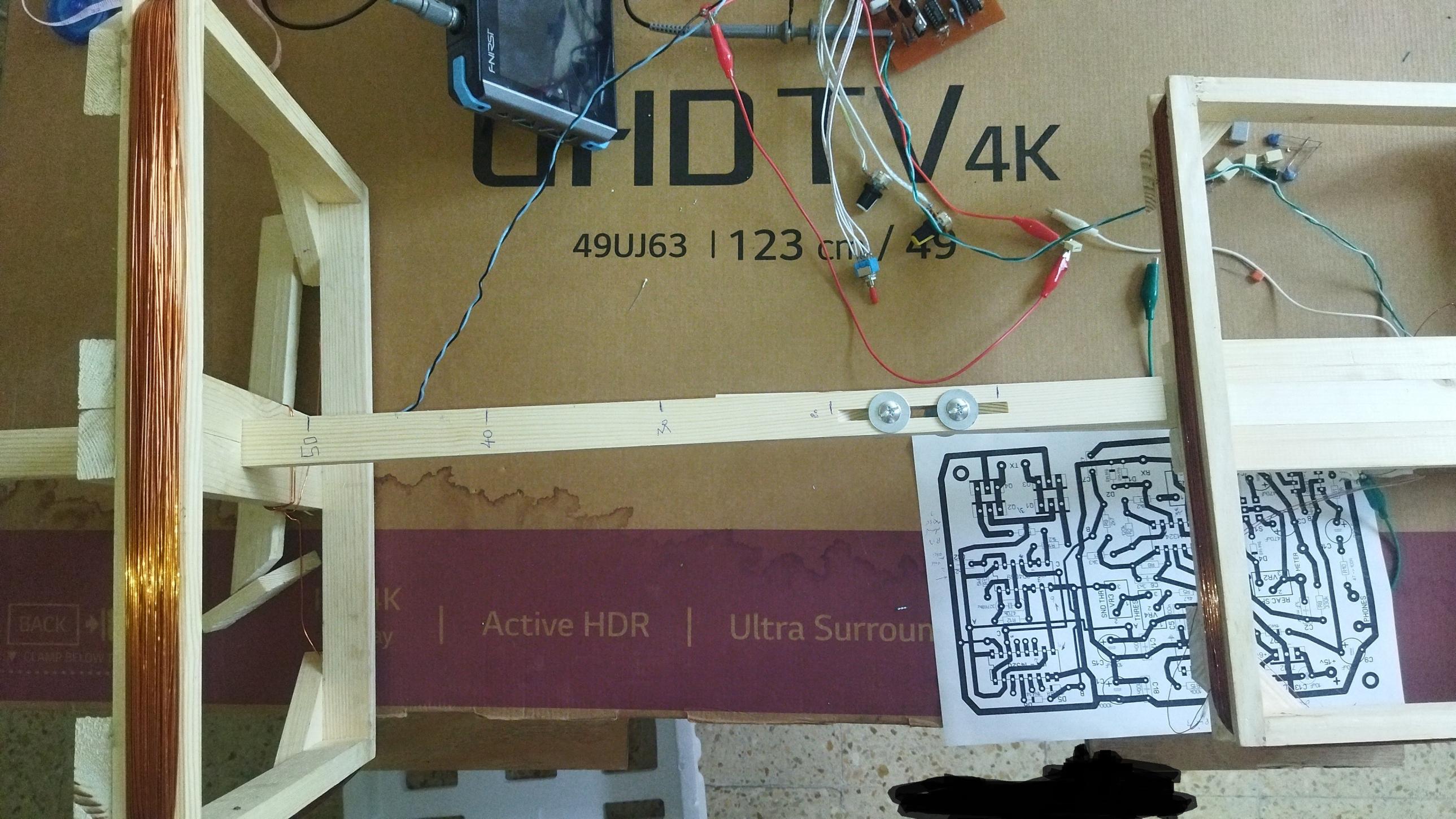

              Mechanical arms with graduations to adjust the distance between TX Rx loops

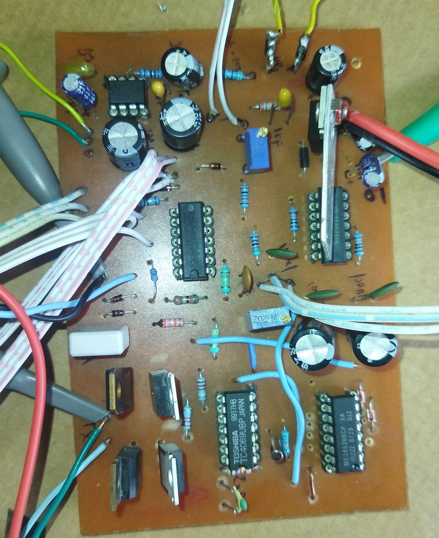

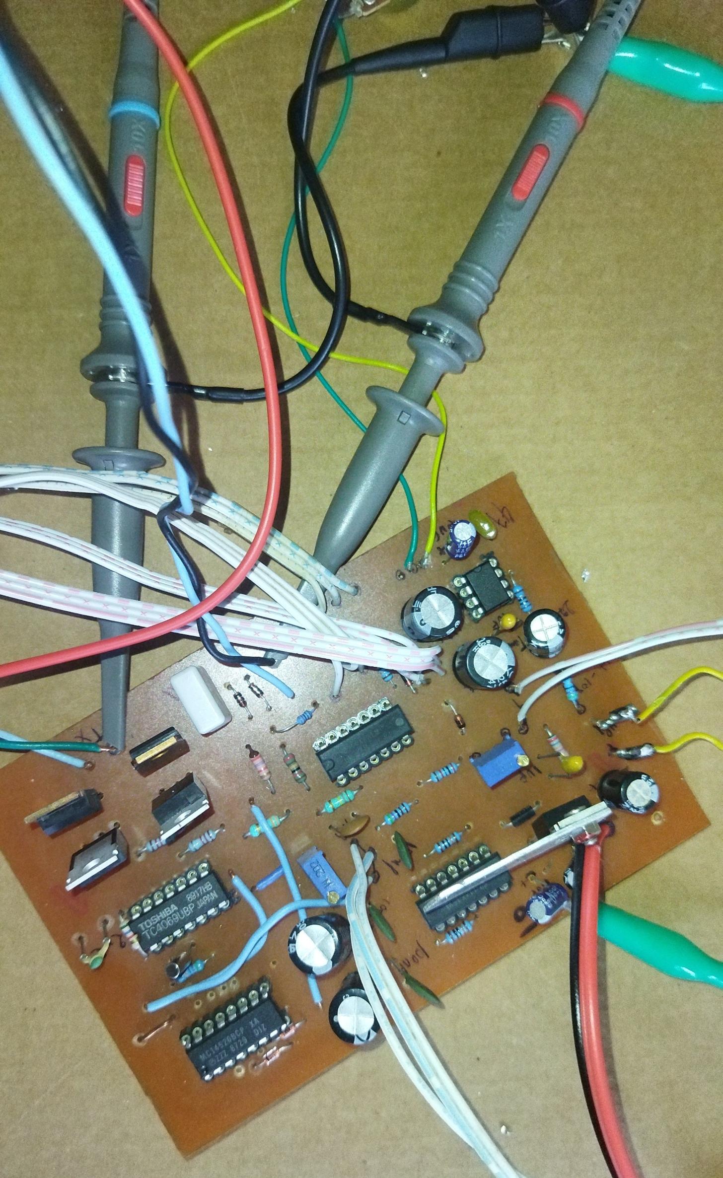

              the actual PCB board with scope probes Tx , Rx
              Thanks again
              any valubale comments would be very helpfull

                                Hello Kece Hon,
                                Thank you for the picture of your coil setup and detector. Please compare the coil in the picture Pechkata posted of the original T/R Locator with your coil. You will notice a significant difference. The shape might be negligible, but the winding technique could be the issue. The windings in the original T/R Locator are well wound. Your coil needs some work. This could also be one of your problems. I'm not entirely sure, but doesn't the original T/R Locator coil also have a shield?​
