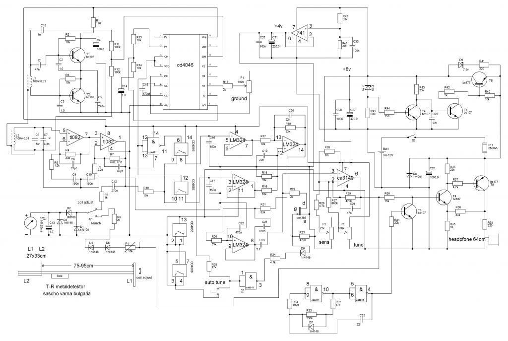

TR locator / 2 box

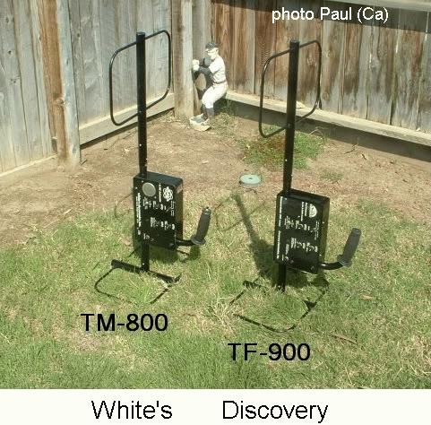

      just there will be order on 50 pcs for TF900 or DEEPERS 10DD pcbs i will do. but i do not see wishers.
        However, if you ask me; of the "dedicated" 2box, TM-808 is certainly the best
        TM-808 is different sch than TF900. TF900 is sure TM-800, TF600 as well. but TM-808 was took from 5900 6000 DI PRO SL sch static part.
        разработчик i do not know how to write in english took this part but forgot that DISC mode, it must be CAVITY mode in TM-808, has not needed depth.
        this mode was deleted by them from last TM-808s. Click image for larger version  Name:	TM800_TF900.jpg Views:	0 Size:	90.7 KB ID:	452897
          Hello Kece Hon,
          Thank you , The windings in the original T/R Locator are well wound. Your coil needs some work. This could also be one of your problems. I'm not entirely sure, but doesn't the original T/R Locator coil also have a shield?​
          Thanks a lot
          about the windings , ill see what can be made ,
          i remember that its made with no shield, works fine without it
            them this mode was deleted from last TM-808. Click image for larger version Name:	TM800_TF900.jpg Views:	0 Size:	90.7 KB ID:	452897
            sure the TM808 , when i looked at the components and the PCB it seems way hard to make
            have upgraded the schematics since then ?
            most of the electronic pieces are very hard to find , there is also some double coils ferrite ...
            i'll stick to the two box , if you could suggest any thing , that would be very generous from you
            if any one could provide some voltages values in the Two Box.... PCB lay file down in attachement
            Thank you
