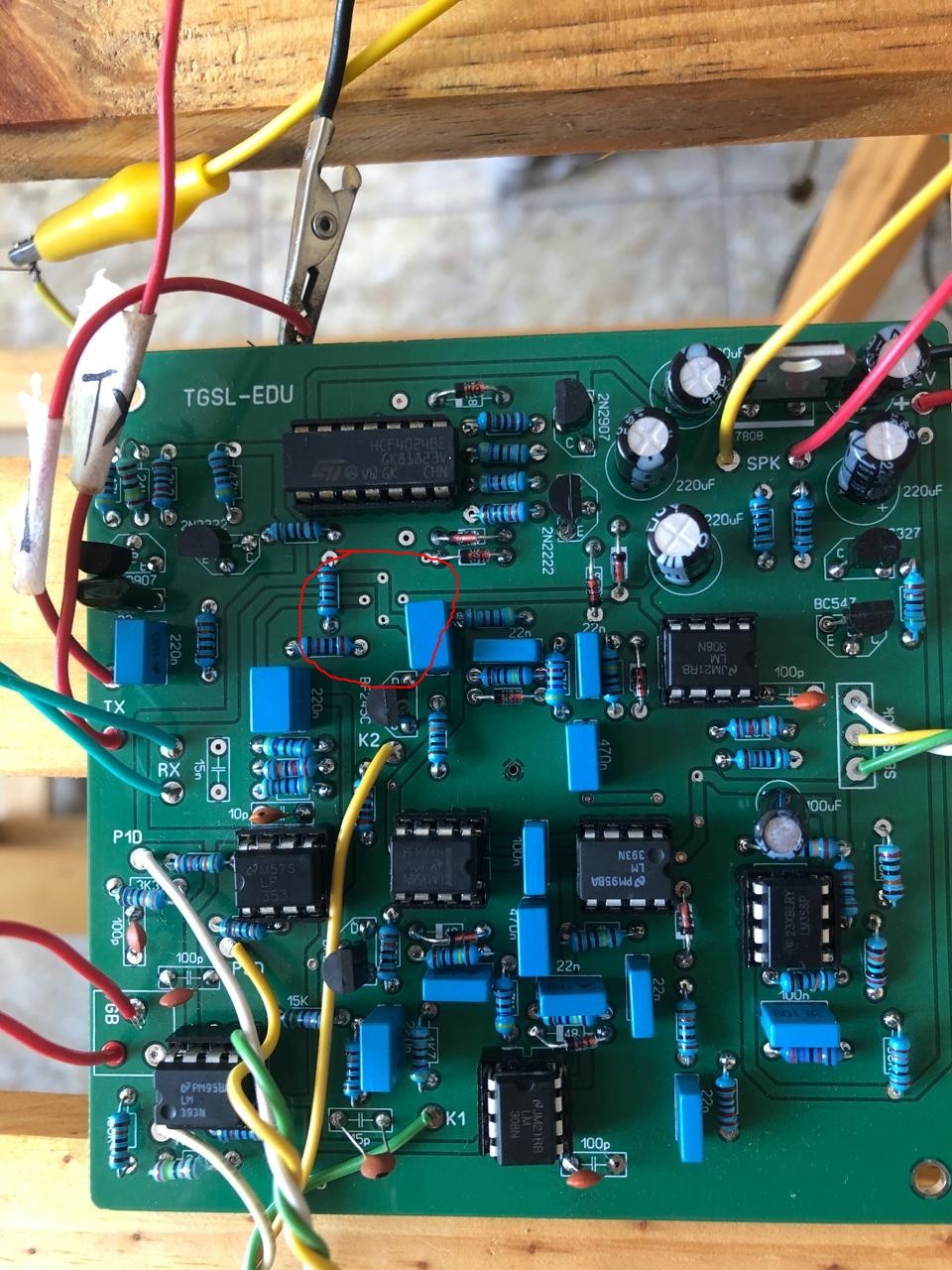

  • cristiano.sar
    replied
    Has anyone a picture of a built TGSL-EDU board so I can compare the components with mine? After a long time without touching the project, I decided to return to it and I'm still with the same issue reported in previous posts: I can only use the sensitivity pot at minimum, it i turn it higher a constant tone is heard (https://youtube.com/shorts/tP9NpLMGQfM). Coil is not shielded for now as i'm only testing it statically. Thanks.
    I've just found the problem, something with the LM308s, I changed them to supposed original versions and it worked ok now.

  • cristiano.sar
    replied
    Thanks.
    The coils are not shielded yet. I want to shield them inside the casing, with graphite.
    The 15nF RX capacitor is connected to the coil wires so I could change it easily, that why you dont see it in the photo.
    I will try other speaker (I'm using a piezo buzzer) and shield the enclosure.
    Thanks.

  • kt315
    replied
    Coils are not shielded?
    if a coil is not moving (in space), rests on a table, static, then the shielding is unnecessary. just you take the coil and move it up down - you have to shield the coil.
    Leave a comment:
  • ivconic
    replied
    I can't see RX capacitor 15nF on the pcb?
    Without it it will work similar as on your video.
    Behavior on video is typical when the last comparator goes into self oscillation.
    To mitigate this to some extent; use 32-64 ohm speaker.
    But first things goes first; shield the coils, shorten the wires that comming from pcb and put the pcb into shielded enclosure.
    If not the whole enclosure, at least make sure the pots and switches are all tied to metal front panel and grounded.
    Keep in mind; those old Tesoros are all coming into metal enclosures well grounded.
    And all use 32-64 ohm speakers.
