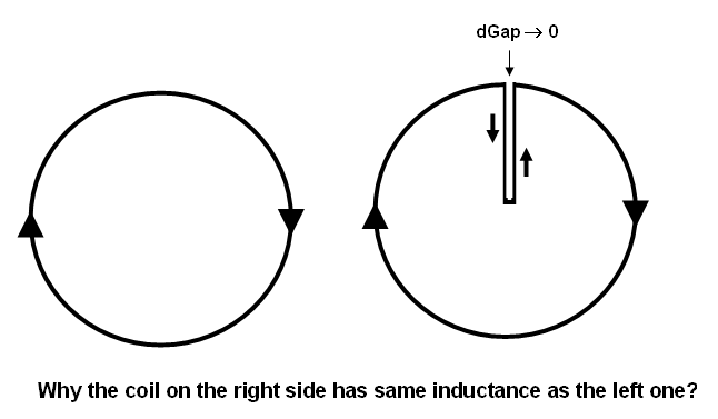

        • Hi guys,
          the gap in the coin does not interrupt the inner circulating eddy currents. You can cut it almost to the other side and it should still give response without any significant response loss.
          The response losses are due to flux area loss of the cutting line and the increased current path resistance (PI: time constant change, IB-VLF: phase change).
          Here is something to think of (see below):
          Aziz
          • Hi Aziz, if your statement is correct then we have in case of spring washer or open ring such current distribution:
            Clearly opposite direction. So spring washer or open ring have to be invisible, but it is not invisible?

              • Hi WM6,
                on your open ring, there is still some flux area for induced eddy currents. As long as the flux area is not zero (inducing voltage) and the current path is closed (currents can flow), the object will be visible.
                There are other effects, which change the detecting parameters:
                - relative permeability (material dependent)
                - coupling of coils (magnetic field path changing effects, can change the balance of coils on IB-VLF systems)
                - ohmic losses (when eddy currents flow)
                - electro magnetic induction effects (currents will even flow, if the current path is obviously not seen as a closed loop -> "antenna" ).
                Consider the open ring: it is an inductor + capacitor (LC-circuit).
                We could bring the "LC circuit" into resonance.
                Aziz

                  Hi Aziz
                  we are discuss frequencies of about 7kHz, not 700 MHz. So most of your indications here are practically not important for eddy current events inside small open ring (e.g. LC-circuit etc.).
                  Here You agree with Carls primary driving:
                  currents will even flow, if the current path is obviously not seen as a closed loop"
                  Yes, current will even flow inside many small eddy current areas and not as closed loop follow periphery shape.
