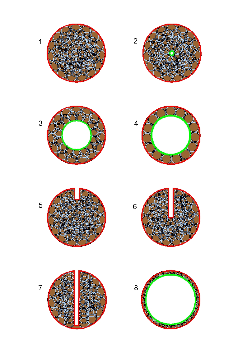

Targets frequency response
  • To remove any confusion, here is a summary of the tests I have performed so far, and my conclusions following these experiments. Please refer to the diagram below.
    Different colors have been used to denote different parts of the experiment, as follows:
    • The coin is shown in "brown".
    • The individual eddy currents (gross representation) are shown in "blue".
    • The areas of maximum current density are shown in "red" and "green".
    First - some explanation. When the coin is close to the search head, eddy currents are generated throughout the body of the coin. These eddy currents tend to overlap each other, and due to the principle of superposition they more or less cancel each other, except around the circumference of the coin. This is where the current density is highest, resulting in a current flow around the circumference. So there are two things happening here:
    1. The current (shown in "red") generates a magnetic field that is detected by the RX coil.
    2. The body of the coin absorbs some of the TX energy, but fails to produce any significant magnetic field. i.e. the body of the coin actually weakens the target response.
    It should be noted that the restriction of the current to the coin circumference has nothing to do with skin effect. This phenomenon is only significant at frequencies above 100KHz, and not at the VLF frequencies we are talking about here. Anyway, the skin effect only limits the depth of penetration of the TX signal, and hence the creation of eddy currents. Therefore in these experiments the whole volume of the coin has an effect on detection, not just the surface.
    Coin #2 is identical to coin #1 except for a small hole drilled in the center. By the same reasoning you can determine that there will be a current flowing around the inner circumference of the hole, but in the opposite direction. This current is too far from the outer current to cause any cancellation. The result is that coin #1 and coin #2 produce no measurable difference in detection distance.
    Coin #3 has a larger hole in the center than coin #2. In this case there is still insufficient material removed from the coin to provide a detectable difference.
    It is not until enough material is removed (coin #4) that the target response is improved. What seems to be happening here is that more of the TX electromagnetic field is concentrated in the ring, and less energy is being lost in the coin body, which has essentially been removed. There is still one more experiment to perform, and that is shown by coin #8. This represents a situation where the ring is now very narrow. The expectation here is that the inner and outer currents will start to interact and the target response will again be reduced.
    The experiments performed with coins #5, #6 and #7 all confirm the assumption that a current path is established around the circumference. It is unlikely that the air gap is being bridged by displacement current as the gap is too wide. These three coins all give a target response that is indistinguishable from coin #1. The only conclusion is that the current follows the edge of the cut. If this was not the case then the cut coins would have a reduced target response, whereas they have neither an improved or a reduced response.
    All of this, of course, assumes that the coin is lying flat in the same orientation as the search coil.
    If the concentric ring theory was correct, the three cut coins would show a massive reduction in target response. Which reminds me that there is one experiment I forgot to show in the diagram. That is a ninth coin, identical to coin #4, with a cut through the ring. This particular coin has a very poor target response, but the concentric ring theory would predict that coin #7 and coin #9 (not shown) would both show the same reduction, which they do not.
    It is this last experiment that is probably the most interesting. As we have seen, you can drill out material from the center of the coin and the response improves. But if you remove material by cutting in from the edge, the response will initially be the same as coin #1. However, removing more material by this method causes the response to be dramatically reduced. The cut ring is an extreme example.

          • Hi Qiaozhi,
            it doesn't matter. I just want you to discover your wrong assumptions.
            Particularly in the coin #2, #3, #4 and #8, the green opposite current flow is wrong. As long as the ring is not open, the current direction must be the same as on the outer side. The current density is lower in the inner area (could be visualised in light red).
            I am sorry, but the circular eddy currents theory is not busted yet.
            Aziz

                  Hi Qiaozhi,
                  Aziz
                  If the concentric ring theory was correct the original coin (#1) would give the best response, as all the "rings" would contribute to the RX signal. Likewise coins #4 and #7 would have the worst response, as a large number of the "rings" are missing. In reality coins #1 and #7 give the same response, and coin #4 gives the best.

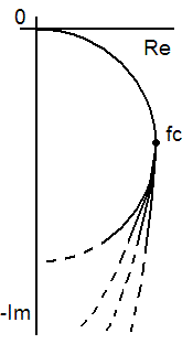

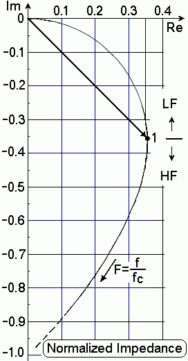

                              • LF region
                                Using the Normalized Impedance plot
                                The advantage of Normalized Impedance plot is that its shape is almost identical for all forms of nonferrous targets and nonferrous halfspace (ground, salt water). There is a difference, which
                                is illustrated in the attached figure, but it is not essential for design purpose. We need to determine in what area of the spectrum can be increased phase difference between
                                signals in order to improve discrimination and to suppress the signal from the ground.
                                Disadvantage of Normalized Impedance is that it not shows the real value of the magnitude and
                                frequency, but only relative to the maximum magnitude and relative to own cutoff frequency. This
                                shortcoming creates discomfort when in common drawing two targets are presented.
                                I will explain this in the next posting as damaged a few coins, but only virtually. Who does not
                                believe the results of virtual coins can actually damage :-).
                                Now to explain what is shown in the figure below. It is a comparison between the shapes of the normalized
                                impedance at 4 nonferrous solids: bracelet (ring), cylinder (coin), sphere (gold nugget) and
                                halfspace. They are scaled so that to coincide its LF region (below cutoff frequency). You may know what is the curve of the bracelet (ring), because occurs Moreland's effect.
