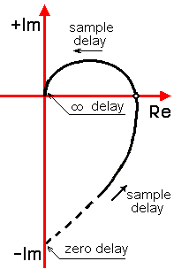

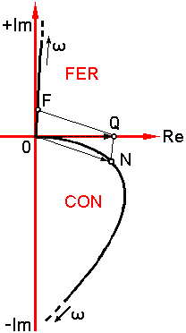

                        Resonance Frequency of soil and ferrous target
                        "Resonance" is term of frequency domain. It means that there is a frequency, at which the phase lag of response is zero because the imaginery part of complex transfer function is zero. Since EMI sensor excitates environment with magnetic field, induced EMF in RX coil has the same phase angle as TX current at resonance frequency.
                        Visual analysis in complex plane shows that there is resonance frequency of soil or target if it possesses both conductivity and magnetizm. This is shown in attached figure. Magnetizm pulls working point upwards in ferro quadrant, but conductivity pulls it downwards in conductive quadrant. In this case, the curved line of transfer impedance intersects Re axis at resonance frequency.
                        In reality, the phase lag of induced in RX coil voltage can not be zero at resonance frequency. It is 360 deg phase delay, because the response is causal. Conductivity generates signal ON at resonance frequency. The phase angle of point N is negative. Ferromagnetizm generates signal OF at resonance frequency. The phase lag of this signal is more than 270 deg because is shown lossy ferrite.
                        The vector sum of both generated signals OF and ON is the resultant received signal OQ. In frequency domain, point Q coincidents visual with the axis of excitation Re. In time domain, resonance point Q can be achieved by appropriate sample delay.

                          Mikebg wrote:
                          <In time domain, resonance point Q can be achieved by appropriate sample delay.>
                          Thanks for the input.
                          Your figure explains a lot. I wish I knew how to do the mathematical analysis of what I do with the circuit.
                          In general the discriminating PI, (Time Domain) has to overcome the problem as you mention above. The steel disk test mentioned above is an easy way to try to coax a specific response.
                          A much more difficult target to differentiate is a clad coin. That is a coin with a FE core and a copper, silver or other non magnetic alloy outer cover.
                          The problem with the decay times is that different size\mass targets will produce different decay times even if they are of the same metal or alloy. Talking about core eddy currents.
                          Now, when you look at skin effect eddy currents, it is rather the surface area that is important. Example, a thin aluminum candy wrapper, gives a large response in the skin effect time domain.
                          If we lump all different responses into one single output, we will know very little about the target's identity.
                          Therefore we need to spread the responses into several times so that we can sample each window that can give us the desired information.
                          At present I use 6 samples and I can differentiate quite a few different metals and alloys. But, there is still a lot to learn. For instance, I still don't quite understand what causes the different readings, why the readings change when the target is very near the coil or why a gold leaf shows a negative response like FE, but a gold coin or ring is of opposite polarity.
                          Oh, by the way, I can differentiate a clad coin from a FE disk or a copper disk.

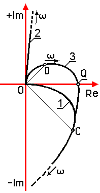

                            Combination magnetizm &amp; conductivity
                            Transfer impedance of conductive permeability
                            Curved line 3 represents transfer impedance form in common case when soil or metal object possesses conductivity as well as permeability. The half-cardioide 3 is obtained by summing pairs points – one of line 1 (impedance of ferrite) and another of line 2 (impedance of nonferrous conductivity) having equal frequency.
                            The line 3 can't be normalized exactly because the line of ferromagnetic impedance 1 can't be normalized at all. Besides, the line 1 is not exactly straight and represents nonlinear properties – hysteresis, saturation and magnetic viscosity. Complex plane can represent correct only linear properties. Despite all we can show shape of impedance form and make several conclusions:
                            1. If a soil or a metal object have both conductivity and permeability, transfer impedance seems like half-cardioide line 3 laying in first and fourth quadrant intersecting Re axis. The intersecting point Q represents resonance frequency. The shape of half-cardioide can differ from shown form because depends on permeability/conductivity ratio. After rain conductivity of soil increases and changes impedance form of ground signal.
                            2. We can define three characteristic frequencies on half-cardioide 3:
                            - Resonance frequency (point Q), at which phase lag is zero (the actual phase angle is minus 360 deg),
                            - Quasi (pseudo) cutoff frequency (point C), at which the phase lag is 45 deg (the actual phase angle is minus 405 deg) and
                            - Mirror cutoff frequency (point D), at which phase lead is 45 deg (the actual phase angle is minus 315 deg).
                            3. If an object is made of ferrous metal and is excited by relative high TX frequencies having impedance points in 4-th (conductive) quadrant, we can't determine whether it is ferrous. Only at relative low frequencies we can identify ferrous objects by impedance points situated in first (ferrous) quadrant.
