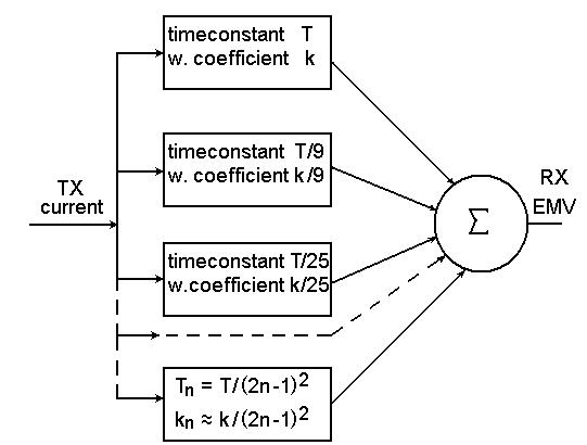

                • #98
                  Signal flow diagram because of eddy currents
                  This is valid for each nonferomagnetic conductive object or each conductive soil or water.
                  The weighting coefficient kn of n-th time constant Tn depends on the shape of the object. If the object is annular (like bracelet), all harmonic coefficients are infinitesimal. The spherical shape of the target increases the weight of harmonic coefficients relative to fundamental coefficient k1.

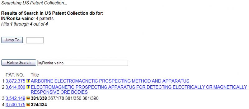

                        This guy loses a lot that I do not know his email. I have an important message for him on how to seek gold veins with radio waves emitted by a powerful VLF Australian radiostation. We made experiments with a method patented by Vaino Ronka. Although here in Eastern Europe does not irradiate the earth from such a powerful radio waves, the results with passive metal detector are encouraging.
                          Discriminating and target ID inclusive?
                          • Passive metal detector
                            As described in the following patents, the answer is YES!
                            Here in Eastern Europe we could not discriminate because the received radio station radiates at relative high frequency 32 KHz.
                              "Superpulse is a term for very strong man-made radio signals. The two most common instances of superpulses are those transmitted by the VLF transmitter GBZ, and occasionally by an unidentified station on 17.8 kHz. The purpose of superpulses is unknown, but they are believed to be an element of an obsolete sound-based navigational system. Superpulses can overdrive the front-end amplifier of a PC several hundred kilometres away from the transmitter, when a PC with an aerial attached to its soundcard is used as a VLF receiver."

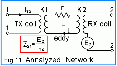

                              • Exercise1: Frequency Response of Sensing Network
                                The purpose of this exercise is to analyze the formation of specific frequencies for conducting nonferrous ground and metal objects. What is happening inside the sensing network when the target is represented by only one eddy current loop?. The eddy current in this loop is calculated by a differential equation of first order, which forms a time constant L/r. The simplified circuit diagram of sensing network is shown above in posting # 20. For spectral analysis and simulation, the above diagram is transformed to simplified equivalent network shown below in Fig. 11.
                                Note that in this diagram, the total inductance L of eddy current loop is formed by two windings in series: the secondary one of transformer K1 and the primary one of transformer K2. The forward transfer parameter Z21 of sensing network has dimension of impedance: the electromotive voltage E2 inducedin RX coil (port 2-2 without load), divided to TX coil current (port 1-1). Note that the equation in red frame is valid in frequency domain only.
                                In the time domain, this network is complicated since every transformer K represents differentiation. This increases the order of DE of the whole system. Therefore, the received voltage E2 is proportional to second derivative of TX current. The analysis in time domain can't show us how target should be excited. The action of sensing network is visible in frequency domain. To analyze how twice differentiation forms specific frequencies for target, we need an instrument NETWORK ANALYZERto plot in complex plane twoport parameter Z21. Search WEB for and download the mentioned above software "NI_Multisim_Analog_Devices_Edition_10_0_1.exe ".
