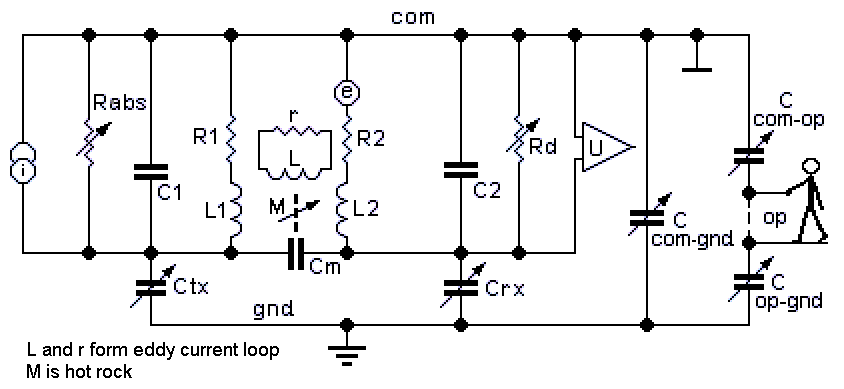

    Note that in this diagram, the total inductance L of eddy current loop is formed by two windings in series: the secondary one of transformer K1 and the primary one of transformer K2. The forward transfer parameter Z21 of sensing network has dimension of impedance: the electromotive voltage E2 inducedin RX coil (port 2-2 without load), divided to TX coil current (port 1-1). Note that the equation in red frame is valid in frequency domain only.
    In the time domain, this network is complicated since every transformer K represents differentiation. This increases the order of DE of the whole system. Therefore, the received voltage E2 is proportional to second derivative of TX current. The analysis in time domain can't show us how target should be excited. The action of sensing network is visible in frequency domain. To analyze how twice differentiation forms specific frequencies for target, we need an instrument NETWORK ANALYZERto plot in complex plane twoport parameter Z21. Search WEB for and download the mentioned above software "NI_Multisim_Analog_Devices_Edition_10_0_1.exe ".

          • Simplification of sensing network
            To understand what is happening inside the sensing network before first differentiation, let us simplify the above circuit, removing TX current and transformer K1. In the following equivalent network (Fig.12), they are replaced with a voltage source. It is negative in time domain (according to the Lenz's rule).
            In this simplified network, the forward transfer parameter has no dimension - output voltage divided to input voltage (like an attenuator). In time domain, the induced electromotive voltage E2 is derivative of eddy current.
            Differentiation in the time domain means quadrature, ie a rotation of 90 degrees in the frequency domain. To see the rotation of forward transfer parameter, let's simplify more the network in Fig. 12 and see for beginning the forward transfer parameter of eddy current loop. The equivalent circuit of eddy current loop is shown in Fig. 13.
            In this network, the forward transfer parameter is Y21 because it has dimension admittance: eddy current, divided by its EMV. The next step is to connect this network to NETWORK ANALYZER. Search WEB for and download the software "NI_Multisim_Analog_Devices_Edition_10_0_1.exe ".

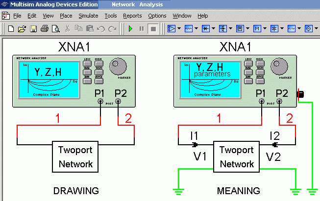

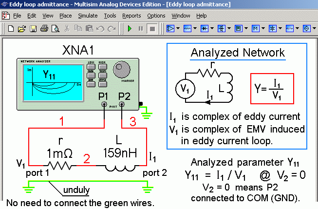

              • NETWORK ANALYZER
                How NETWORK ANALYZER works? It calculates the 4 parameters of the connected twoport network .
                You can learn in WIKIPEDIA for two-port network and its parameters. Then read Help in the software of NETWORK ANALZYER.
                For us the most interesting is the Forward transfer parameter. It has as index the number 21 or the letter F. Remember the parameter H21 (or Hfe) for transistors type BJT and parameter Y21 or (Yfs) for transistors type FET.

                    WM6, For a professional designer, the NET ANALYZER is a very powerful tool for impedance matching. I am an amateur designer who is accustomed to the primitive method with sheet and pencil. I have created effective miliwatt TXs and sensitive nanovolt RXs for QRP ham radio without using SPICE simulator. For example, when I design an amplifier with transistors, I use only simple formulas containing parameter h21, neglect by the other three network parameters h11, h12 and h22. This is not correct. The SPICE and NET ANALYZER are using all 4 parameters, but they can not draw or block diagram, no circuit diagram.
                    When I started exploring metal detectors, I decided to SPICE simulate the attached equivalent circuit diagram. But it turned out that I do not need because I know what parameters of the diagram must have a minimum value, and which - maximum, what parameters should be stable and what parameters must be adjusted after being assembled device.
                    The SPICE simulator can not edit the circuit diagram of an electronic device. It can only show the shortcomings of the analyzed scheme and show for what values of the components these shortcomings are minor. The block diagram and circuit diagram are compiled by the designer.
                    In the Exercise #1, I will use NET ANALYZER to show that the sensors must have one additional coil, generating reference signal for synchronous demodulation.

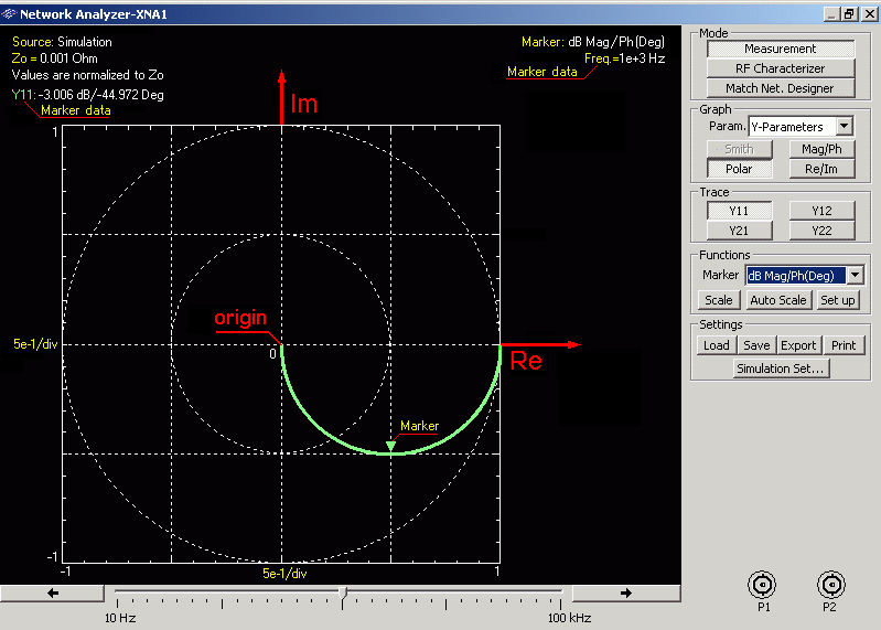

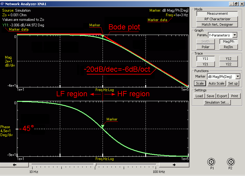

                    • Forward transfer of eddy current loop
                      Let's start with Forward transfer parameter of an eddy current loop. Timeconstant of the shown loop is L / r = 159nH/1mohm = 159us.
                      • Polar Graph of above network
                        Admittance of an eddy current or forward transfer parameter Y11 in complex plane. Note that this plot is called "Polar Graph". The value of "Zo" is chosen equal to the resistance "r" to obtain testimony -3dB for frequency at which the phase lag is -45deg.
                        • Admittance expressed in polar coordinates
                          GLOSSARY:
                          Bode plot (the red linies) is approximation of Log-Log plot with asymptotes (stright linies). The error of this approximation is maximum -3dB and appears at cutoff frequency.
                          Cutoff frequency is the point where two asymptotes in Bode plot intersects. Synonimes are:
                          - f3dB or 3dB frequency,
                          - f45deg or 45 deg frequency,
                          - Corner frequency since Bode plot seems as a corner,
                          - Break frequency since Bode plot seems as a broken line,
                          - Characteristic frequency since this point characterizes boundary between regions:
                          LF region are frequencies below cutoff frequency
                          HF region are frequencies above cutoff frequency. Slope -20dB/dec = -6dB/oct is attributable for First order Low Pass Filter. This term is used in frequency domain. In time domain the RL network is Real integrator (in HF region only). An Ideal integrator has no resistance in series (capacitor or coil without ESR).

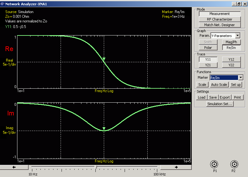

                          • Admittance expressed in rectangular coordinates
                            CONCLUSION:
                            The eddy current loop trasfers signal as an real integrator in its HF region. This allows us to differentiate signal once without loosing spectral information.

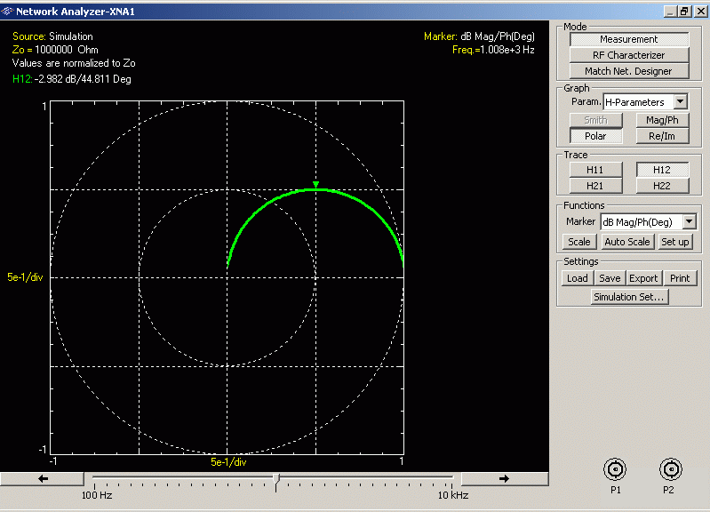

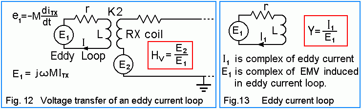

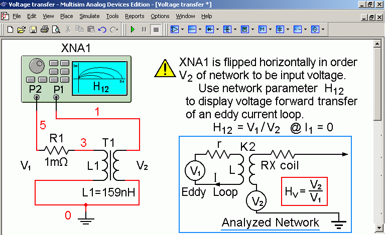

                            • Network for voltage transfer of an eddy current loop
                              As is known in the study of transistor amplifiers, the hybrid parameter H12 represents reverse voltage transfer. In common emiter network this is the parameter Hre. Since in principle both ports of two port network are equivalent (not defined input and output), we can flip horizontally Network Analyzer to make parameter H12 forward voltage transfer parameter G21. For a detailed explanation of G21, search WEB for "Two-port network" and read "Inverse hybrid parameters (g-parameters)" .
                              • Polar Graph of Voltage Trasfer
                                Voltage Trasfer of an Eddy current as Polar Graph
                                When Network Analyzer is inversed (flipped horizontally), instead hybride H-parameters, it represents G-parameters (inversed hybride parameters). Therefore, two readings on the Network analyzer's skin should be changed:
                                - The inscription "H-Parameters" should be "G-parametrers" and
                                - Inscription on button pressed H12 must be G21. Parameter G21 is nondimesional forward voltage transfer. This is inversion of H21 - the nondimesional forward current transfer parameter.

                                1. In time domain, the Voltage transfer by an eddy current loop is scaled derivative of its Transfer admittance. Compare the polar graph of Transfer admittance (shown in posting #116) with the polar graph of Voltage transfer shown here. Explain how differentiation in time domain amended complex spectral response in frequency domain.
