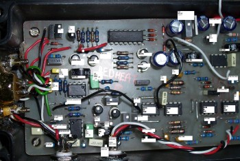

    Have had a "go" on 4 chips---in photo,looks to be scape marks after the LM & LF's
    would this have been were the number was? is there enough info? If so I'll do the rest.

      • Is there enough info on them chips?
        • Originally posted by chopz54 View Post
          Think yes. Also would be great know other last three.
          The big one should be 4024.
          • Originally posted by johnsmith77 View Post

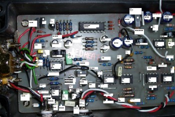

            Will have another go at it tomm- morning. And will label everything thats not clearly
            visible (about 25 comps).
            • REDHEAT
              This looks to be about the lot. 1 comp- with no visible markings.But I'm sure you
              will figure it out.
              chop
              • Thanks Chop.
                Grt Nakky

                  Thanks Nakky, Good one of you appreciated my time in getting this asked for info.

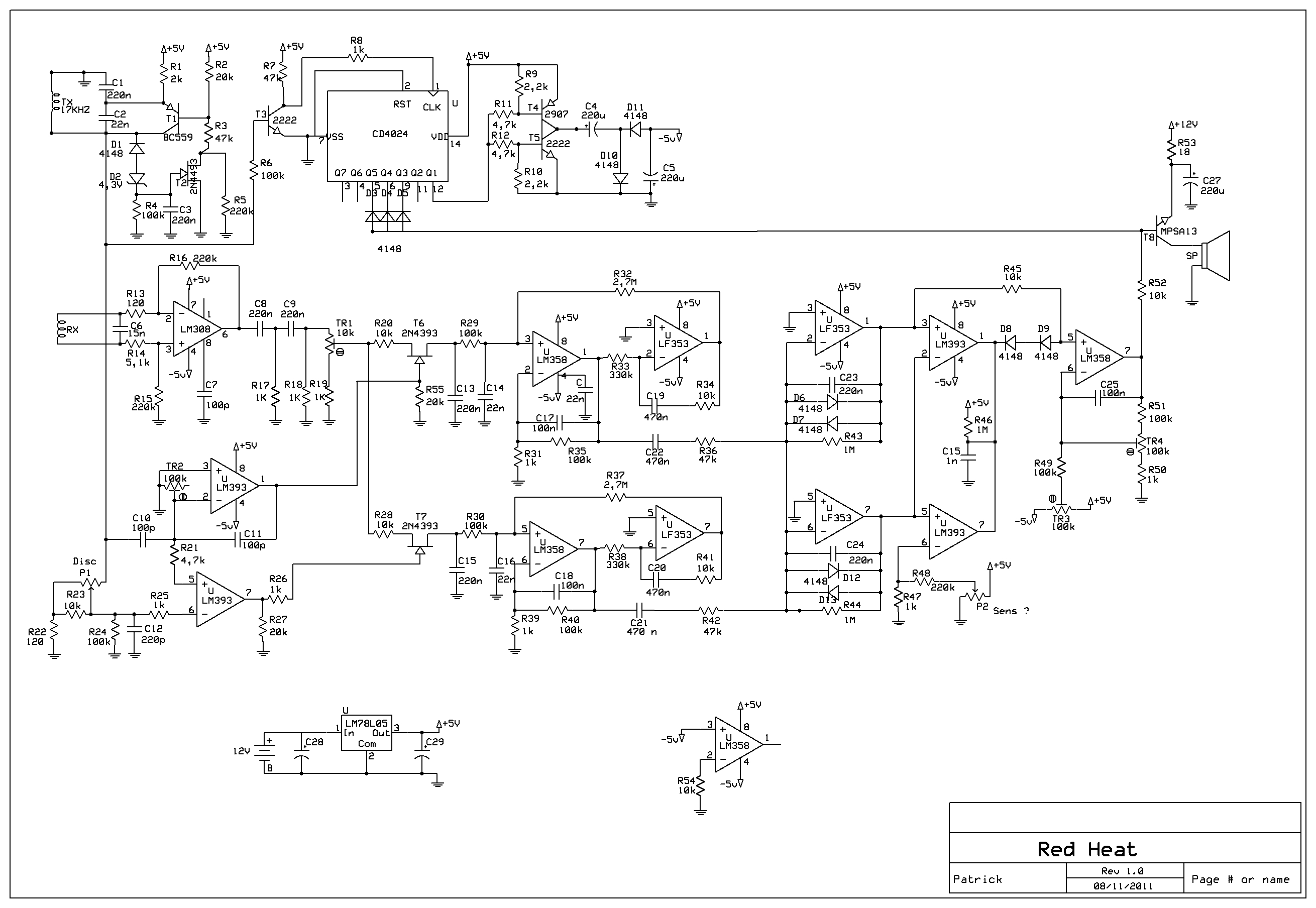

                    It 's another version of the Eldorado schematic.
                    Could you clarify :
                    R13 = Brown, Red, Broown = 120 ohms
                    P1 = ?
                    P2 = ?
                    R23 = is it</SPAN>connected toP1 ?
                      Could you clarify :
                      P1 = ?
                      P2 = ?
                      </SPAN>
                      P1 & P2? Controls? Left is Disc, Right is Boost.
                      All other controls/parts etc are in the
                      battery box under the arm cup (No photos of this are possible)
                      R13 & R23 see other photos
                      Not about to take it apart again,having already spent lots of time cleaning,supplying component info etc.
                      Did I waste my time guys???

                        I seem to remember talk about Vic's metal detectors way back in the mid 1970s.
                        Some 5 to 10 years before the Tesoro's came around
                        I may be wrong here, but maybe the 'Eldorado' from Tesoro is a version of Vic's 'Red Heat' machine and not the other way around.
                        It is certainly possible and just a thought.
                        • [quote=headshed22;139481]
                          Originally posted by Patrick View Post
                          Thanks Chop.
                          My RedHeat was made June 10th 1993
                          (see my dated/signed machine photo earlier)
                          The Eldorado was introduced about 1986.
