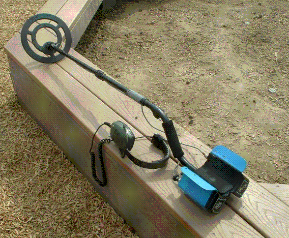

                      Hello , It has been almost two months since my last "Old Forgotten" Post's !!! So here are two Great Relic Machines that have dissappeared and are no longer being manufactured !!!! I heard , they were last sold in stores about 2003 . Also , can you guess the difference between the 1st and 2nd model shown on the top photo . Both detectors are Great , but there is only one difference between the two !! The answer is in the last , Bottom photo . I will post a depth test report on both , later on ........................Regards.......Eugene52/Member/Stalni-Clan

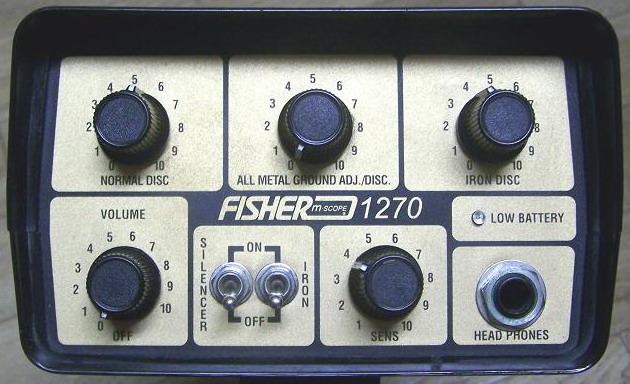

                      • hi all. is there a progress in 1270 PCB?
                        respect

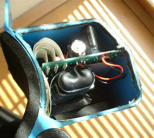

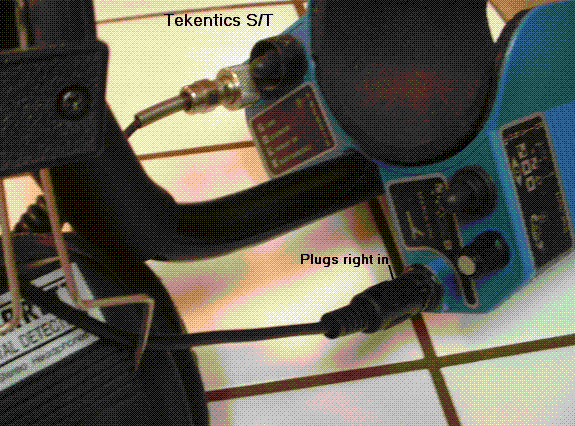

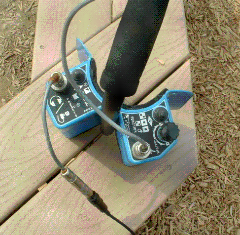

                        • ST
                          Would run for 30 seconds on that battery. Those blue pods were full of C cell Ni cads. Drew about 170 ma. Fatal design flaw was those toggle switches with rubber boots on. Boots would get holes in easily and next time in the sea. ST was smoking like a Russian.

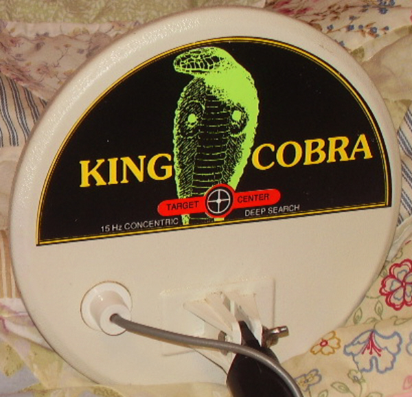

                            • Joe, have you King Cobra coil for sale or trade in any condition? ought to learn it. I have 2 Garrett coils for trade.
                              sincerely yours
                              • ......OLD FORGOTTEN DETECTORS.......
                                ........SORRY......But I sold my Gold Mountain King Cobra at least a few months ago.....................decided to sell anything that was not being used..............just collecting dust is not a good thing............Joe
