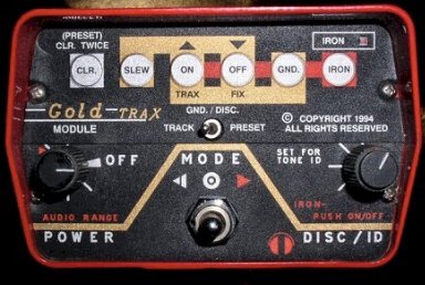

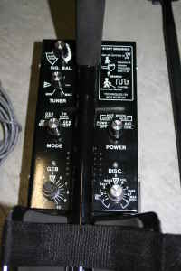

              O.K. , Getting back to the important Technical issues !!! Away from politics and finger pointing . Which I no longer will get involved with , here on the Geotech Forum !!!........I want to post again a few photos of a Detector that is now discontinued . I believe the frequency is 12.5 khz. I wish I knew more about the "Modules" . Does anyone know about all the optional modules ????? And I see a separation on the housing , so the bottom must be a common base unit , and the top sections must be the different modules. It would be nice to see a catalog of all the modules with specs or even what the actual prices were. OR better yet to find out if the base was just the power supply and audio , disc sections , and the top units were TX and RX sections only ????....... Were they great ??? , or did they have problems ????...Comments are welcome...........Thanks.......Eugene

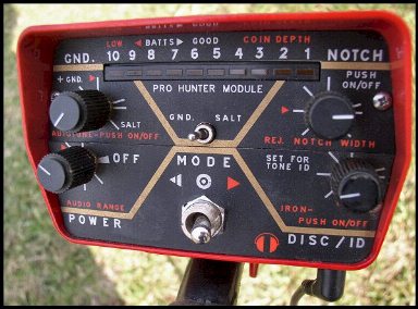

              • #97
                Don't know about the technical stuff concerning the TB but there was several modules including deep hunter, ProHunter, Cointrax and Goldtrax and another one that I forget.
                The base of the detector could be used as is without the extra modules of course. Modules and the base detector are hard to find.
                This detector is still a very good one, still keeps up with the best detectors on the market in depth and has some neat features such as a high/low adjustable break tone that has a wide range from anywhere in nails up to zinc pennies and could be set to accept all metals or disc out iron.
                The old ones are the ones that can accept the modules.
                George Payne's detectors are always good ones.
                www.jb-ms.com/Baron/

                  Steve , Thanks for the information , and maybe we can keep this topic going on "Discovery" for a few days !! A couple things I wanted to mention. If they stop manufacturing the Modules , that is good for the Forum here !! Because I always wanted to get more information and see the Module "PCB-PHOTOS". And the circuits that each module contain !! I think what George Payne did was very Clever and He was ahead of his time !!! You know I kind of see similarities , with today's minelab "xterra series" and the changeable search-coils. Also a question I have had for so many years...... Is the Discovery Detector company we are discussing today , related anyway to the Radio-shack Discovery Series ???...............I hope we get a bunch of new information soon from other Geotech Members . It would be something to finally have a project here on Geotech that is similar to the discovery set-up , also with different changeable modules . One for Coins , one for gold , one for relics. But an improoved version and not a "Copy" of George Paynes Great work !!!!......Thanks......Eugene

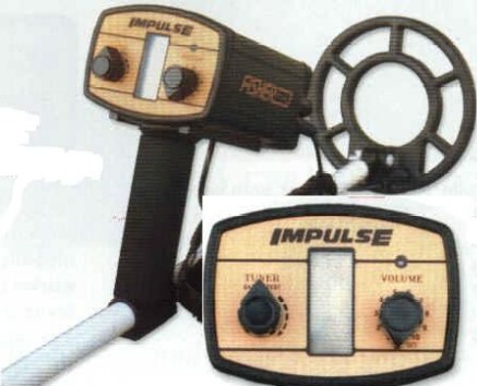

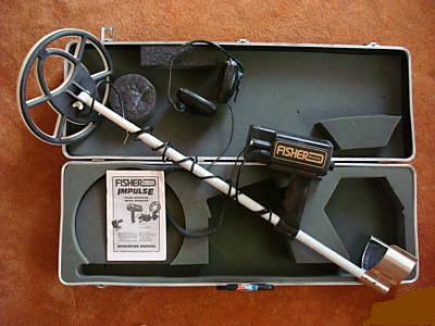

                            While we are waiting for the "Discovery Module" photos and schematics from other Members !!!! Here is another Metal Detector that seemed very impressive just a few years ago , and now , like many others has "JUST DISSAPPEARED" !!!!! It was a Pulse Induction , but worked at a crystal-controlled 5,333 Pulses per second "P.P.S." !!! And the tuner adjusted the "Threshold" But I still do not understand why Fisher picked that frequency , but the field tests I read were pretty Good . I wonder why it was discontinued ??? So now , this would be an excellent Metal Detector to open up and examine , and then many questions will be answered. I am sure everyone knows we are talking about the "Fisher Impulse" by now............Eugene

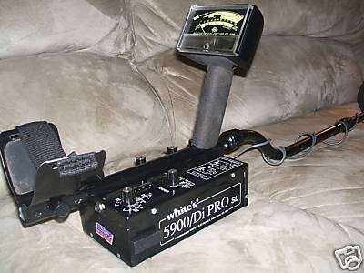

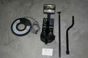

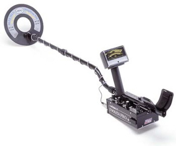

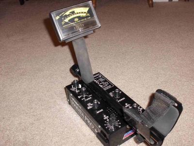

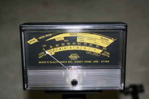

                              Here is a "LEGEND". Whites 5900 DI/PRO/SL. 4 search mode selection's :
                              1. GEB/DISC
                              2. GEB/NORM
                              3. TR/DISC
                              4. GEB/S.A.T.
                              Target ID / Depth meter , and Used a 4 pack of nicad "C" cell Batteries . Depth on this machine was an average of 34 c.m !!!!! Using the Whites 9.5 inch blue max search-coil. ...........You can buy one today for $250.00 to $300.00 , and to me that's a Bargain !!!!............Eugene
