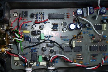

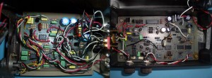

    • side by side
      The Redheat beside my SS+
      • RedHeat Cleaned(?)
        Good news-- Cleaned some of the components.
        Bad news---Chips etc are coated with something different- would not budge
        with what resources I have to hand.
        If you need any info off something---USE MY PHOTO with numbered arrows
        and I will have a closer look.

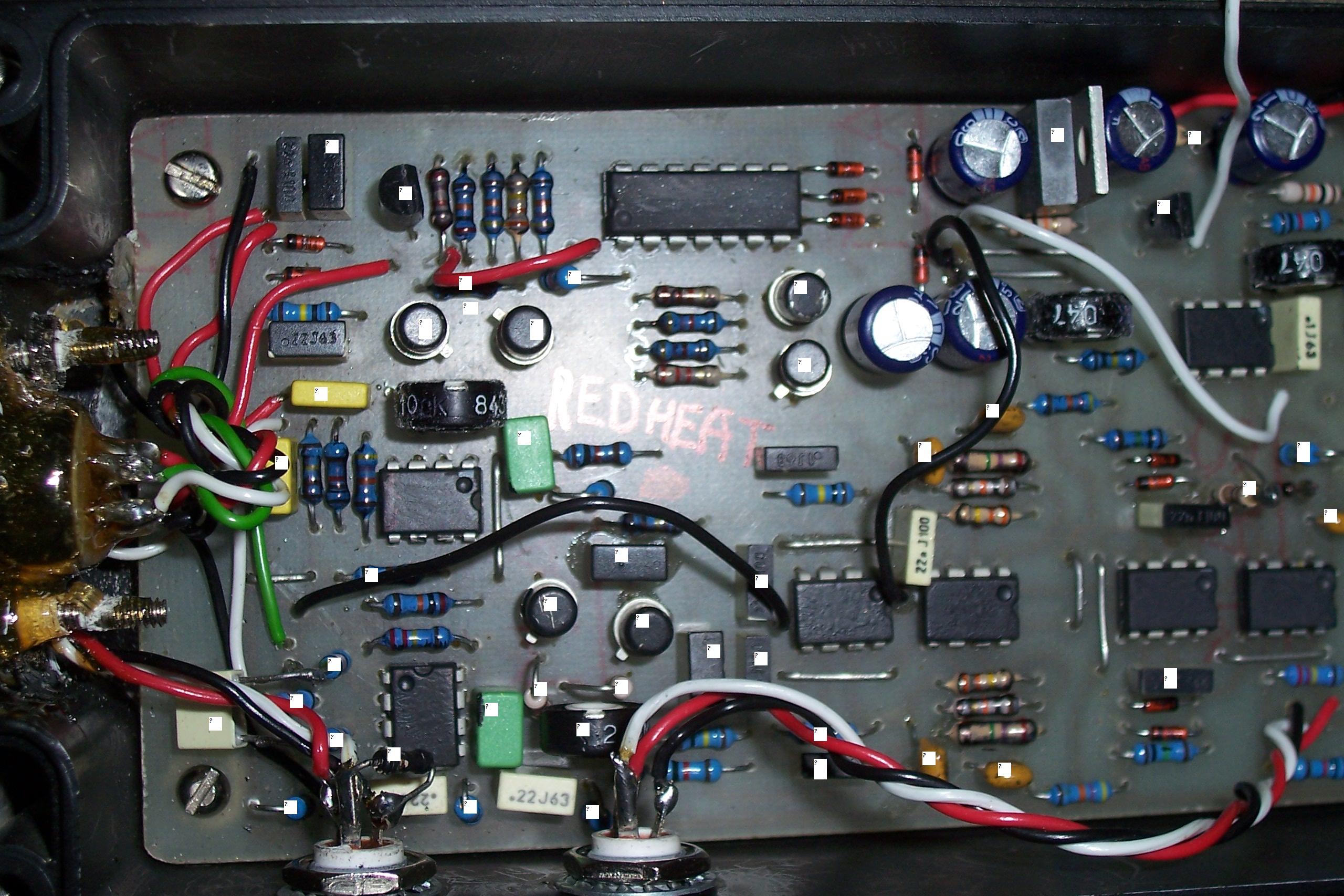

        • Originally posted by chopz54 View Post
          Thank you for your effort!
          Сan you tell what kind of chemicals you tried on chips?
          Thank you

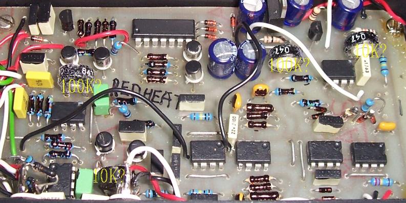

                • Black Light
                  Hi give it a try using black light, try to read the numbers from different angles and using (if possible) a cheap USB microscope.
                  Good luck.
                  • Originally posted by solmer2 View Post
                    Good luck.
                    Backlight..That wont work as what ever is on there is pretty thick.
                    I dont have a USB microscope either...or know anyone who has I could borrow.

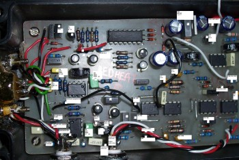

                      Values we need marked in photo i attached.
                      You could fill needed values directly on that photo even with paint text option.
                      It would lighten process
                      • RedHeat Labels
                        Heres about 75% of the asked for comp labels.I have only listed the ones I can get to (at the moment...I wish it had taken a moment!!)and am pretty sure on colours etc (you will have to find the values for yourself) The rest will either require the board removing (again)or a bit more cleaning.Some of them eg: transisters(?) etc are coated in the same
                        stuff as the chips...so I dont know what to do about them.Theres about 12 left to find.
                        I hope that all this is of help?

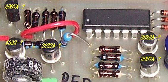

                          Can you try scrape top edge of metal transistor with needle or something sharp. (knife, small scissors). I think there is no marking on the top. And no damage will be done to metal. Just to see if that coating breaks or is very strong.
                          • Hi Chopz 54,
                            Is this right.
                            Grt Nakky
                            • Can you try also scrape top edge of IC's with sharp knife.
                              Grt Nakky
                              • And these ?
