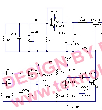

              I don't have the complete schematic for the DMCiib but here is one that I believe uses the same coil and TX arrangement. Notice, along with adjustable TX power they provide external controls for nulling as well.
              Circuit looks like a single channel designed to be used in salt water.
              Don
                Don
                Thanks for schematic. Definitely interesting center-tapped coil usage among other things.
                -SB

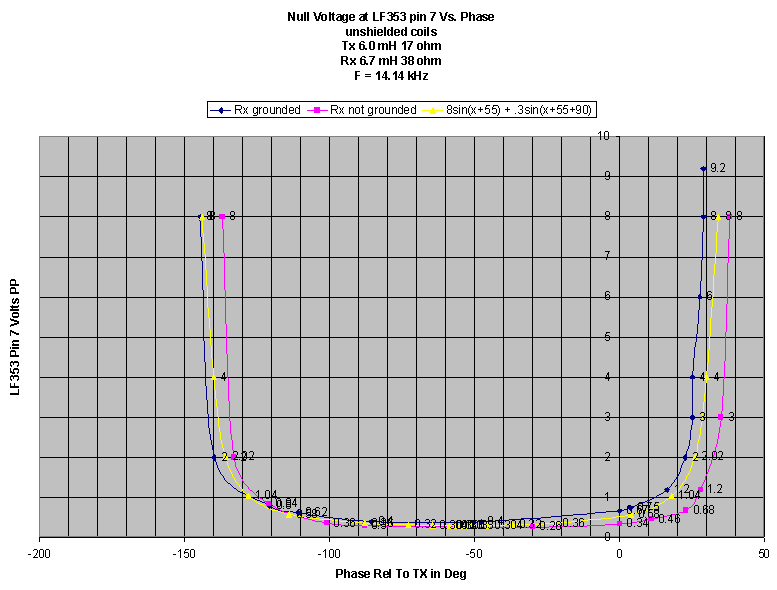

                • nulling to death
                  For those of us with noisy workshops, we can't do depth tests, but we can do nulling phase tests! Yea!
                  Why? I don't know either. But people seem interested in this subject as it might impart magical powers to their MD if they get the null phase just right...
                  Anyway, here are some results with unshielded coils. I slowly changed the overlap and measured the null voltage (at LF353 pin 7) vs. the null phase (relative to the TX signal).
                  I did this with the RX lead grounded and then with the RX lead ungrounded (true differential input, dfbowers wet grass configuration).
                  I also wanted to see how this compared to a simple theoretical model. This model is:
                  A sin(x) + B sin (x + 90), where A represents the pure coupling of the two coils and changes from a large number to zero to a large negative number as the coil overlap moves through the null point, and B represents a small capacitive coupling of the TX and RX leads that is 90 degrees out of phase with the TX signal.
                  I changed A from 8 volts to -8 volts, and let B = .3 volts, which is approximately the null signal voltage minimum observed.
                  The attached photo shows the results.
                  I plan to repeat these tests with other coils which I will then put different shields on to see the effect.
                  My hunch is that the radical shift of the null phase near minimum can be explained by the presence of another signal approximately 90 deg relative that is added in, and is not "magnetically" coupled and therefore not affected by ground balancing, and that the exact phase of the null signal is probably not critical. But I could be wrong.
                  It looks like the simple theoretical model may be improved by adding a small magnetic phase bias to the magnetic component, so instead of shifting from -90 to 90 it goes more like -85 to 85.
                  Anyway, more tests to come...probably...
                  -SB

                        Hi der_fisherman:
                        No, I haven't concluded anything about how/where to set the null point, just sort of developing a theory about what we see.
                        I would actually like someone with a noise-free environment (cellar???) to do a similar test only measure the air-depth carefully as the phase changes.
                        Theoretically, I don't see why the null phase should affect the depth much if you are near the minimum voltage. But it will affect voltage on capacitors on C12, C15 (TGSL).
                        It also has some implications for the ground balance setting, but I need to study that some more. It may be more important which side of the null you are on than the exact phase of the null signal, and even then it may make less difference than most people believe. Of course there are many considerations besides air depth and simple ground balancing, such as margins of error, etc.
                        -SB

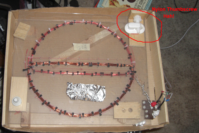

                        • I want to add a nylon thumb screw which pushes on the coil to fine adjust the null next time.
                          S
                            S
                            I like the idea (assuming the null is really that critical.. stay tuned..). I haven't found a clean construction design to do it myself.
                            Cheers!
                            -SB
                            Attached: nulling machine with foil target. No particular relevance...

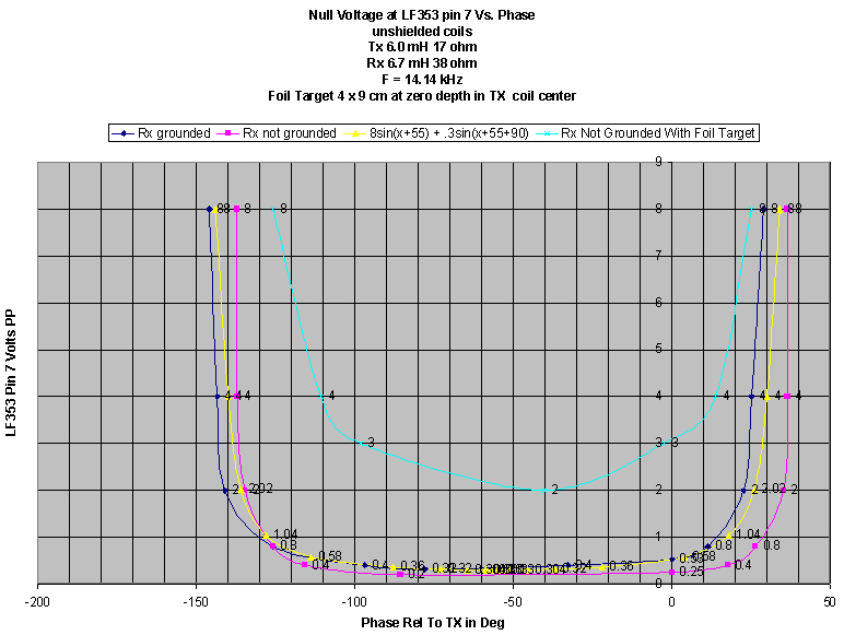

                            • Redo Null Phase Tests
                              One more time with feeling...
                              Realized that for my last null phase test chart, I had the RX coil leads reversed (you know, gives a double beep).
                              So I fixed it and redid the tests. Didn't really change anything.
                              However, I added a test with a 4 x 9 cm foil target at zero depth just to see what it does to the null signal.
                              My conclusions so far are:
                              - The "grounded RX Lead" configuration has slightly larger null signal and is shifted in phase by a few degrees from the ungrounded configuration.
                              - Metal objects near or in your search coil (hardware, circuitry, shields) may change the null signal by increasing it and may change the ground balancing point(s) by compressing the range of the magnetic component of the null.
                              More experimenting to come (maybe).
                              -SB
                              • Commenting further on my last graph of the null phases:
                                1. I shouldn't have said switching the RX leads didn't change much. The graph looks pretty much the same, but now the phases corresponding to more overlap of the coils are the more positive phases, the opposite of the previous graph with the RX leads reversed. I guess this isn't any surprise.
                                2. Note that the previous two graphs were for a configuration using a standard USB cable. My next graph will compare data using a Belden cable to the USB cable for the non-grounded RX case, for the heck of it. I don't expect too much difference, possibly not even in the margin of error of my data points, but let's see.
                                3. By the way, I know my theoretical model of two sine waves 90 degrees apart is not exactly correct because my null signal becomes quite distorted near the minimum null voltage, doesn't look like a nice sine wave.
                                In fact, to measure phase, I measure the positive-going zero-crossing difference for one estimate and the negative-going zero-crossing difference for another, and average the two, because the waveform is so non-symmetric. Maybe dumb approach, but that's what I do.
                                To normalize the zero crossings, I center both waveforms (TX and RX) vertically on my oscilloscope center x-axis gridline, making the top and bottom peaks equidistant from the x-axis. This may not work so well for the RX null signal at minimum when the top half of the waveform may look sine-like and the bottom flattened, or vice versa, etc.
                                But hopefully averaging the two null-crossing phase differences help reduce the errors.
                                I noticed that Dennis the Mennis, in his tests, seems to have a nicer looking null signal as it moves across the minimum. Perhaps it is just noise in my workshop causing distortion.
                                Dennis the Mennis and I seem to be studying this null phase characteristic simultaneously, so it will be interesting to compare his results to mine, and the combined data may be helpful.
                                By the way, I'm not doing this to make a big deal out of null phase. In fact, I generally thought the null phase was not critical and depended on peoples shields, cables, etc. But it seems to be a topic of interest and so deserves some study in hopes of debunking any myths, and learning useful practices, etc.
                                -SB
