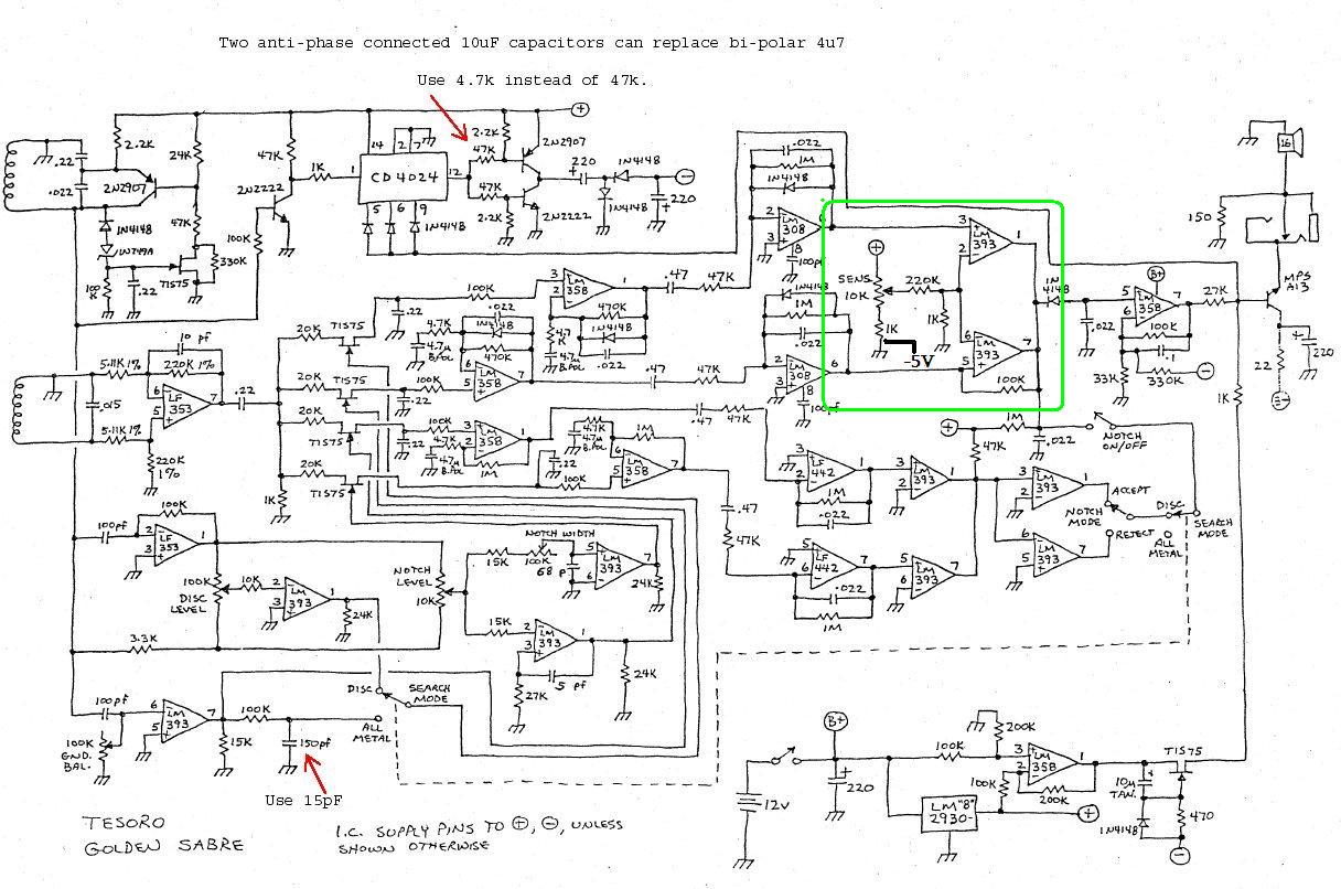

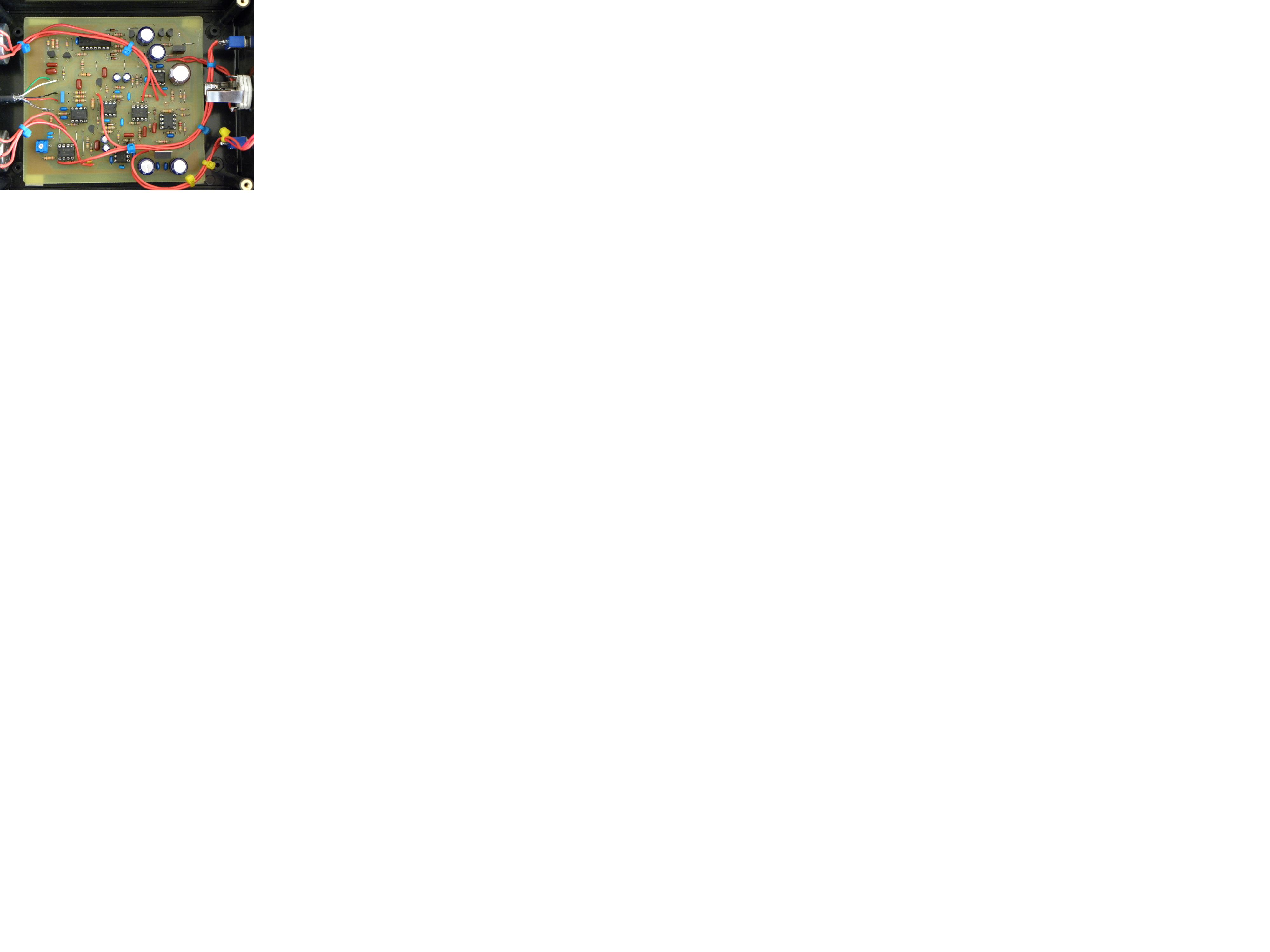

    Here is an easy mod I did with TGSL#2. Just clip one wire to the 10k pot and move it to the closest jumper with -5v. (Look close at the 2nd pic.)
    Don

      This is great. Thanks for getting done in a few days what I can't do in a year!
      The mod is beautiful and no real reason not to do it, IMO. I think for marketing reasons Tesoro didn't want people to turn on their machines to a lot of beeping.
      [As a temporary measure, people can skip cutting the wire and just run a jumper to the -5V buss (just wastes another 5 milliamps through R37). Whatever is easier.] (let me think about this, I may not be correct as to dfbowers mod)

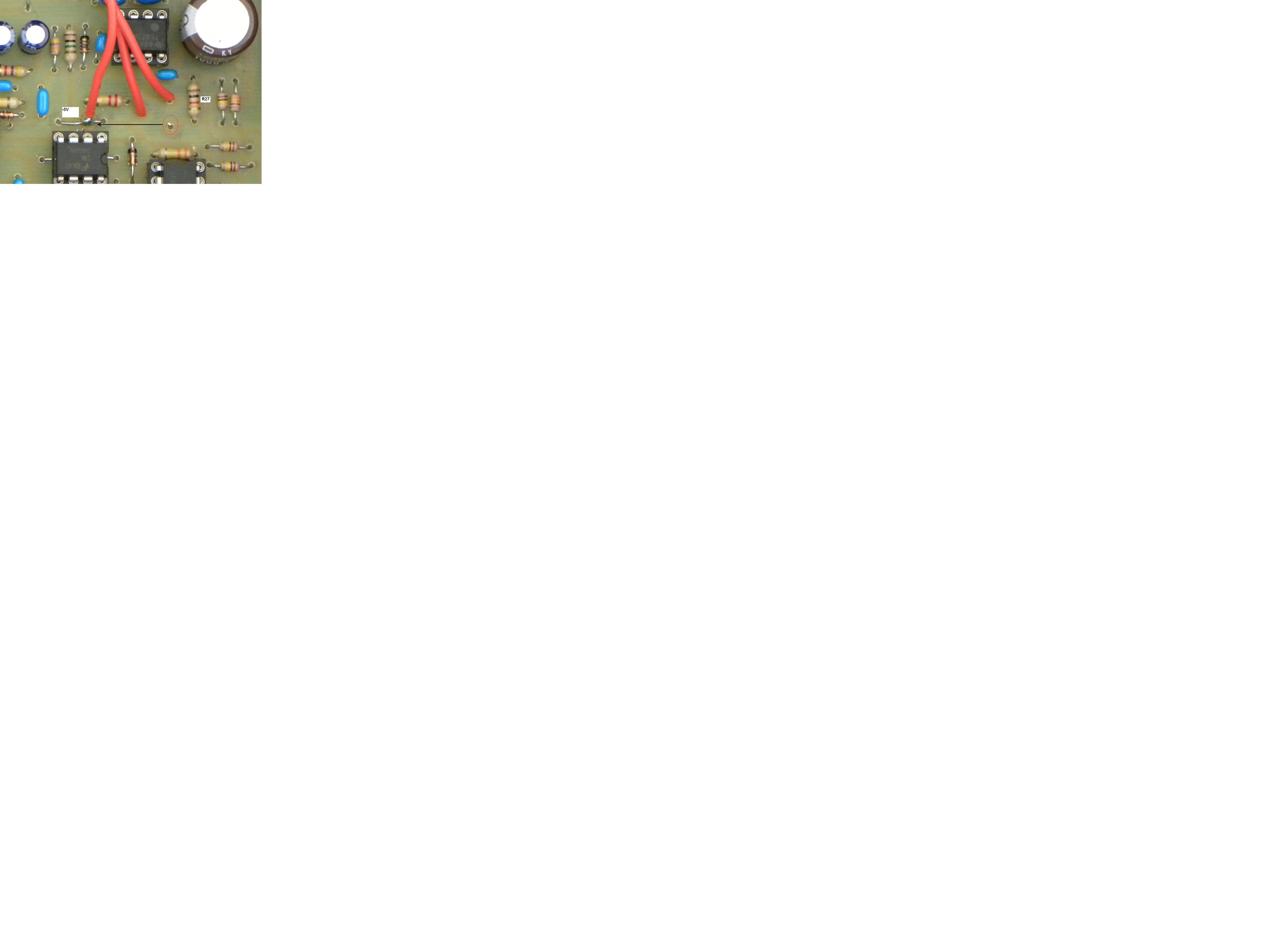

      • Hi dfbowers -
        Looking at the photo of your mod on the PCB, it is hard to tell the connections. It looks like the pot wiper goes directly to the LM393 inputs, although your schematic indicates should pass through the 220k resistor first.
        Also not clear what happens with the jumper wire that was there -- is it intact or altered?
        Can you describe a little more?
        -SB

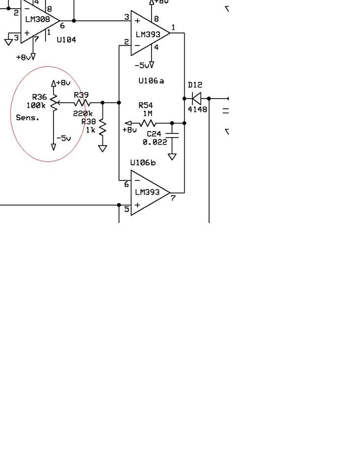

          Simon,
          I would just go by the shematic that I posted. I just moved the wire that was connected to one end of R36 FROM R27 TO -5v.
          The bare jumper wire was a convenient place just to test.
          You are right about the change is current consumption. A 20K pot would now be a better choice for R36..
          Don

            I get it finally... my eyes thought the jumper wire was cut and pot wire went through a hole - just shadows now I see... all is consistent with your schematic!
            So my comment about extra current really doesn't apply to the way you do it, not worried about the little extra current through the pot. I was thinking some people may want to just do an alligator clip jumper from pot lead to the -5 without moving the wire. Then you get constant drain across the 1k resistor. Your mod is fine and dandy as is. Now I've got to get my carcass out there with my rig and test noise and play with mod.
            -SB

              I'm thinking that this mod is more of a Bandaid approach.. But it proves a point. The real fix is to install an offset circuit for each LM308, or TL071. It would only take 2 resistors and 2 pots. Your "stereo" idea is probably the more correct thing to do. Do we really know what the threshold level of an LM393 really is? The data sheets only say that it compares signals "near" 0.
              Also, what happens when we fine tune the connections between the LM308s and the LM393s? Suppose we can get both channels to switch more closely in unison? In playing with mine, adjusting the reference point for the comparators effects things in a very non-linear way around the threshold.
              The original design most likely has a ton of marketing influence built in.. Minimal parts, minimal returns for repairs under warranty.. Machines that work under a wide range of environments. Sell the thing, make a profit and never see it again! But that's not what we are trying to do.

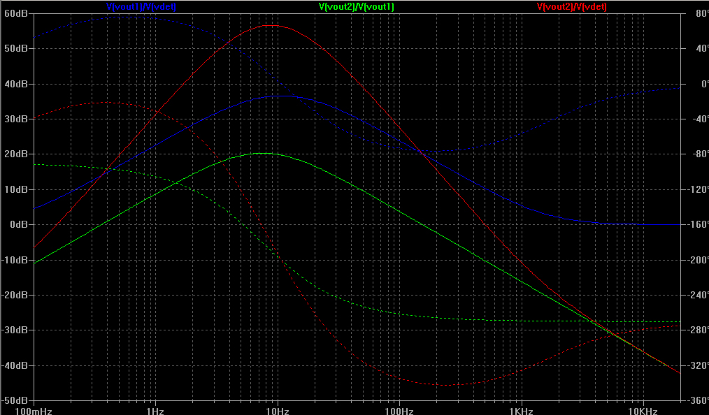

                      pebe made a good point that my graphs at the beginning of this thread showing Bode plots for each stage of the TGSL filter (LM358, LM308 ) and the overall gain don't make sense.
                      The reason, I believe, is that my original plots plot the signal difference across the stages and compare them. For Bode plots, I believe you must plot the signal ratios across the stages for them to be useful for comparison and combining.
                      So attached is a new image of the same stages that I plotted at the beginning of the thread, only using signal ratios instead of signal differences.
                      Thanks pebe for bringing it up.

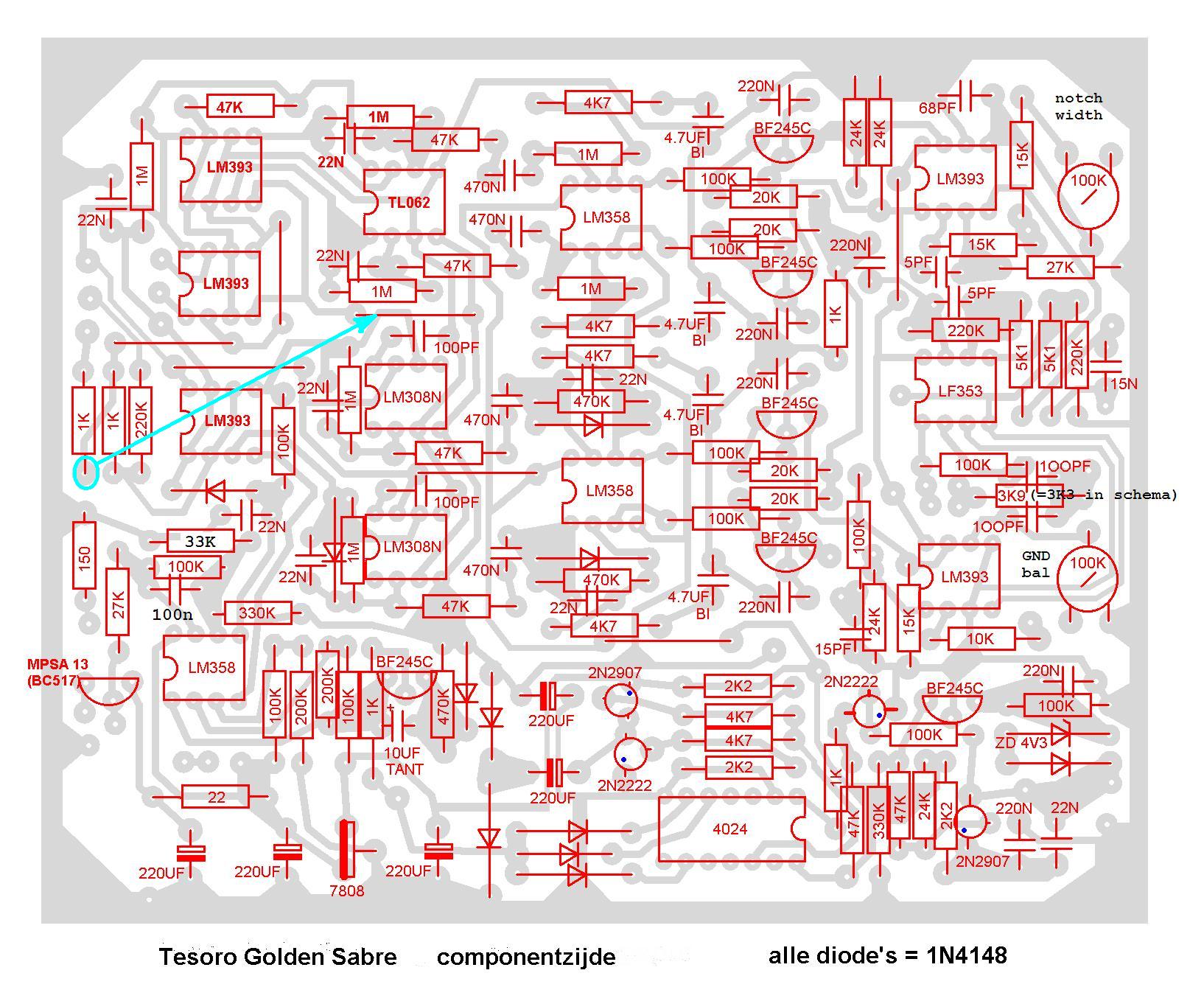

                              • DFBowers sens.control mod on TGSL
                                Ok dfbowers, i will compare TGSL with TGS schematics to see if there are any diferences.
                                Nelson
                                Hi Nelson ,
                                I think the sensitivity control mod DFBowers made on his TGSL is also usable for the TGS , the schema is in this part the same.
                                Only DFBowers used a 100K pot and in the TGS there is a 10 K pot connected via a 1K resistor to the ground , see attachments .
                                I will try to test this mod this week on my TGS as soon as I 'll get my MD more stabil , otherwise it won't be much of use in this case .
