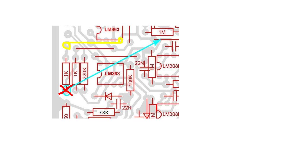

  • Do you mean this way ?
    Grt Nakky
    • Originally posted by nakky View Post
      Grt Nakky
      Hi Nakky ,
      Yes , I was suggesting the bridge as a possiblility for the -5 volt connection .
      Have you tried it allready ?

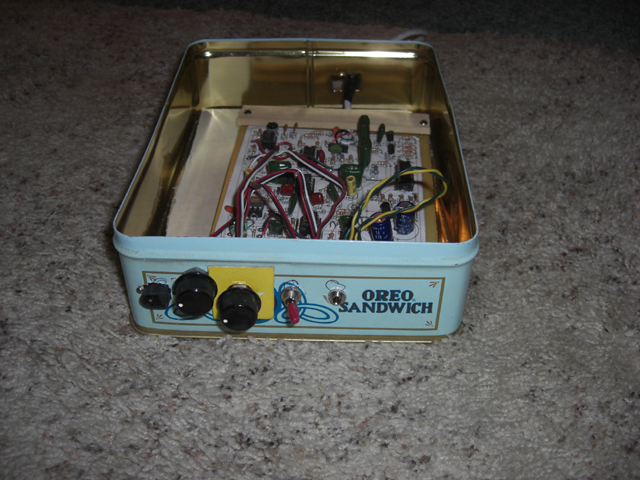

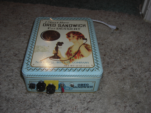

                • packaging
                  PCB packaged for next field test, wires less free to move, container to keep light out.

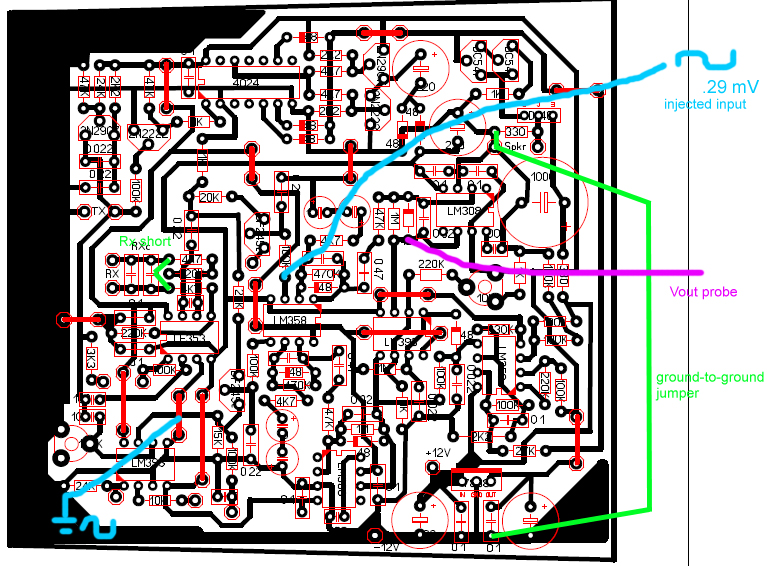

                        • one mystery solved -- ?
                          I believe I solved the mystery of dfbowers "peaked" wave during my signal injection test to test the filter sections of our PCBs.
                          And it is the opposite of what I would expect given the excellent performance of the the MD.
                          (To recap -- injecting a tiny signal at the input of the LM356 gives an amplified signal at the output of the LM308 (using DISC channel).
                          I noticed that the output signal on dfbowers PCB looks less sinusoidal than mine; in fact quite "peaked" with occasional wiggles and jumps.)
                          I randomly noticed that when I plugged in some headphones, the output signal looked really distorted, jumping sharply with each beep. (why is it beeping when the GB channel has no input... geez I'll check...)
                          Anyway, I unplugged the headphones and pondered it some more. The obvious suspect is one or more of the "rails" (ground, V+, probably not V- because audio not connected there).
                          So I ran a jumper from the "speaker" ground to the battery ground.
                          Voila - the signal became much more sinusoidal. I reconnected the headphones, and instead of a short, choked beep, it was now a longer, smooth beep.
                          Conclusion -- the audio circuit (even with headphones unplugged) -- causes distortion of signals running through the filter/amplifier section, and it seems to be because of loading of the ground buss.
                          The irony in all this is that dfbowers TGSL is an excellent machine! Apparently my PCB has less loading from the audio, but his PCB seems to be superior -- maybe because of better handling of coil noise somehow (which I have yet to identify the reason).
                          However, it reinforces my desire to adopt a PCB layout where the audio ground connects directly to the battery ground. (Unless it turns out this loading effect actually improves performance somehow!!!)
                          I have attached video showing the difference in audio beep and output waveform with and without the "ground jumper". Note the output waveform is the smaller one at the top -- sorry, it gets confused with the larger input waveform at the bottom a little.
                          http://www.youtube.com/watch?v=JldwJ9HeqXQ
                          BTW: using scope probe, it seems that the audio affects the output of the LM358 also, but more difficult to evaluate because of smaller signal.
                          -SB

                                Hi Don:
                                First, I don't trust any test I do unless I do it at least three to thirty-three times! So will continue to check it out.
                                Quick answer -- I didn't isolate the audio ground, just jumpered it in parallel, sort of load relief on the main ground buss -- arterial bypass so to speak. Yes, I created a "ground loop".
                                My test was somewhat artificial as I injected the signal I was studying. Still, adds to my feeling that a better audio ground may be a good idea.
                                See attached photo. The green lines are jumpers I clipped on to perform the test. One is just to short the RX coil input to keep it from adding another signal. The other is the ground-to-ground shunt that I theorized would relieve some of the ground buss lifting by the audio pulse. In a revised circuit, you would also cut the ground connection from the speaker to it's current ground buss connection.
                                You can also see where I injected the signal and measured the output.
                                It was dang tricky to get clips to stay put, so always some room for error.
                                Now -- why did I get a beep with only one channel? That troubles me, so I need to check to make sure this isn't all BS.
