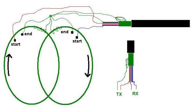

- What thickness wire for coils. What resistance (previous values not certain).
I have 7-8 coils with wire thickness 0.25, 0.27, 0.30 (without varnish). Last one I use is 0.25mm (0.28 with varnish) 5.95mH and 6.37mH, 24.8 and 25.7ohms.
