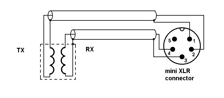

                      • [quote=simonbaker;95881]
                        Originally posted by Darko View Post
                        Disc pot should affect voltage on C15 (in disc mode -- no affect in "all metal" mode).
                        GB pot should affect voltage on C12.
                        If your detector is good indoors, I don't think these voltages will hurt anything when outdoors, just my opinion.
                        Phase of null signal affects whether positive or negative voltage on caps. Some coils you can get minimum but not phase for positive voltage. Or you can get phase for postive voltage, but not minimum null.
                        I believe the shielding of the coil affects the null a lot. Very conductive shield can make null phase shift, make difficult to get postive voltage on capacitors I think. But not completely sure, I'm studying coils now because of these differences.
                        I think best strategy is to try to get positive voltage on C12 by moving a little off the null point, but not too far. Even if voltage is between -.7v and 0 should be OK I think.
                        Again, if your detector is working great, I don't think it matters anything else. Your detector seems to be very good, congratulations. Interesting point about computer nearby -- I'll pay attention to that now! Wireless transmitter especially...
                        -SB

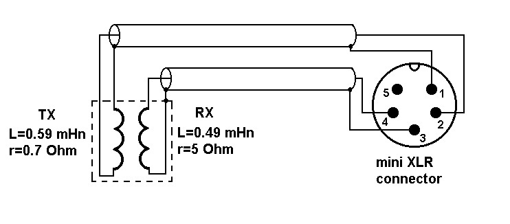

                        With this way of coil wirements voltages are ok on c12 and c15 and it is possible to null coil in proper way, but sensitivity goes down by 2-3 cm? Disc is exelent and stabillity become slightly better. Freq for bit go higer, from 14.70 to 14.74.
                        • [quote=Darko;96686]
                          Ok, please compare this to what you had before -- what did you change?
                          Are those values correct??? .59 mH or do you mean 5.9 mH? .7 ohm, or 7 ohm? Are you making coils with very few turns?
                          Are you grounding/shielding differently?
                          Please more description, I'm not clear what you are saying.
                          -SB
                          • [quote=simonbaker;96701]
                            -SB
                            Sorry for misunderstanding. All parameters are standard exept wirement of coils. TX coil is not connected to the shield in coil housing. It is working good but now I have other problem. Even connected in this way or even as stated before, both ends, TX and RX connected to the shield, when I touch coil housing with hand, sensitivity fall drasticly. Some situation with several coils??!!! I think shielding is good, cable also good..I dont know why this happens!
                            • [quote=Darko;96702]
                              Ivconic and Max probably answer this better.
                              A picture of your coil housing would be helpful.
                              - Does sensitivity fall as your hand comes near, or suddenly when touch coil housing?
                              - Are you sure you are connecting ground wire of TX to shield, not hot wire?
                              - Exactly what type of cable are you using?
                              - What thickness wire for coils. What resistance (previous values not certain).
                              - It is not too surprising that touching coil would reduce sensitivity, but before simple answer, I hope someone with good working TGSL will try it with theirs and see how touching housing affects sensitivity.
                              - It is possible touching coil housing affects null through capacitance, etc. -- maybe even deforms coil positions -- can you see any change in null on scope?
                              - What problem are you trying to solve by experimenting with shield connections? Less noise/chatter?
                              -SB
                              • -A picture of your coil housing would be helpful.
                                It’s Bulgarian plastic housing like ivconic uses for his coils. I will attach here jpg when will make some shots.
                                Only when I touch housing , or cable.
                                Yes, I’m sure.
                                DIN cable, 5 wires. Tried with two similar cables.
                                I know that this is normal if sensitivity falls just a little when touch coil but I’m loose 10-15 cm of sensitivity of machine!!
                                -I don’t have scope. I uses sound card scope until I noticed chatters when my PC is turned on. Now I null coils with multimeter.
                                I try (and success) to achieve good phase like you says that voltages on c12 and c15 must be a positive. With normal (both TX end and RX end on GND in search head) wiring I don’t have success.
                                Well, in both cases of coil setup I notice fall of sensitivity when touch search head housing or cable.
