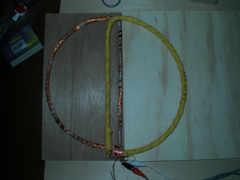

                  • #84
                    mirror-phase experiment
                    Ever tried this?
                    While fooling around with new TX coil (TX coil about 6.3 mH, RX coil about 6.75 mH), I adjusted oscillator cap to give frequency around 18.5 kHz and reversed leads of TX coil to get similar null phase to normal setup.
                    It made a pretty good detector! - seemed like less chatter and more depth??? Not sure how it affected discriminator yet.
                    My guess is I was on the other (high) side of the RX resonant frequency... not sure at this point.
                    Frequencies from 17 kHz to 19.5 kHz had interesting performance.
                    -SB

                      • #86
                        Originally posted by Ultimate_Haze View Post
                        How much you have now for 1e coin?
                        Can you post some pictures of the coil?
                        I will try.
                        What cap value gives you 18,5 at oscillator?
                        Don't forget, this is just experimental weird stuff!...
                        I am trying unshielded TX coil with shielded RX coil.
                        I use 24 awg wire so coils are big thick monsters, only about 7 ohms resistance.
                        I rechecked TX coil inductance after soaking with glue -- it is actually 5.9 mH now. (That crazy coil drove me nuts... too high, remove windings, still too high, oh well, just put on glue... now lower...??? Maybe glue expanded...)
                        RX coil 6.7 mH, 7 ohms. But sometimes I add resistor to increase ohms.
                        Coils are not glued to form -- so can adjust null -- but many chatters because of vibrations -- have to wait to calm down.
                        Oscillator capacitor of 10 nF (instead of 22 nF) gives about 18.9 kHz.
                        Don't forget -- reverse the TX leads, then null coil as usual!
                        I think on bench I got about 20 - 26 cm (more like crack sound) of silver quarter dollar with this setup -- with normal setup maybe 15 - 20 cm and more chatter.
                        I'm probably exaggerating... easy to believe something is better when it's not. Also, discrimination probably all crazy.
                        But interesting to try just for fun, I'd like to hear if anyone else has some results.
                        -SB

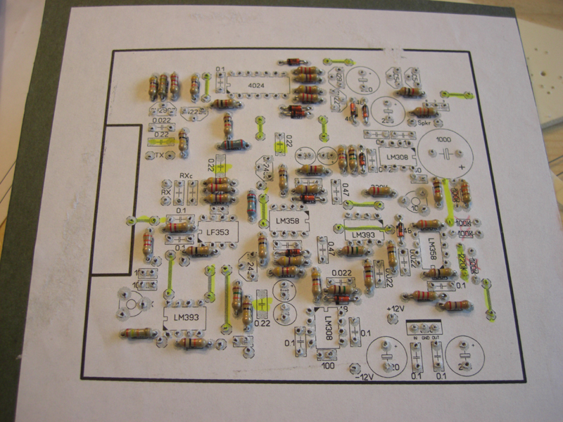

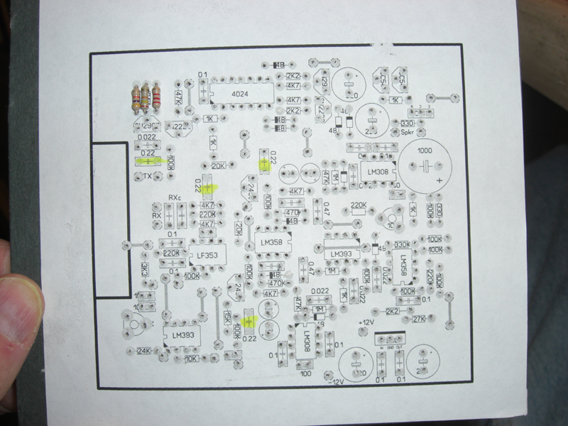

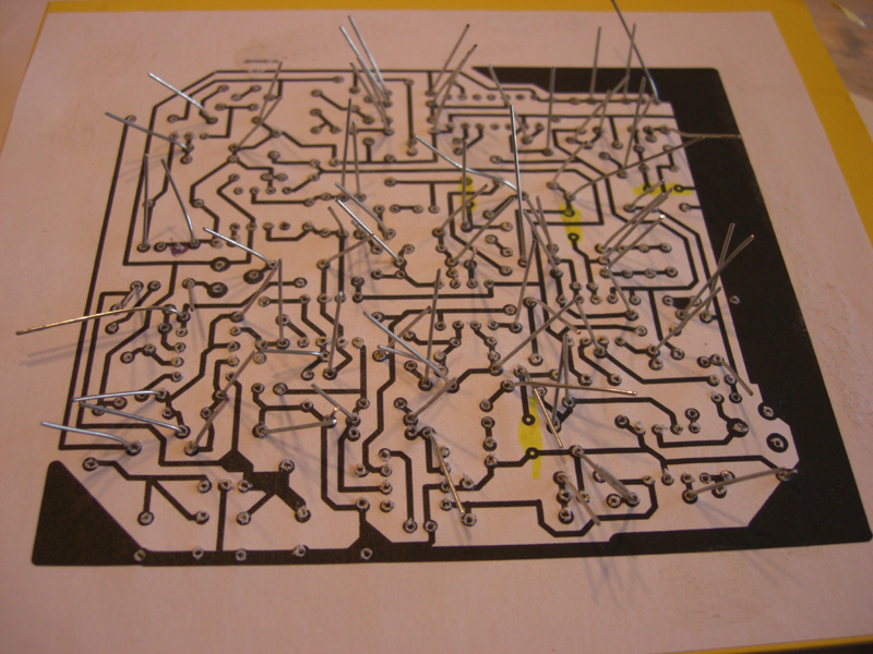

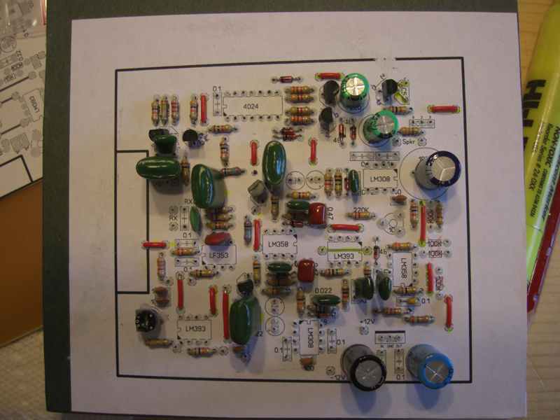

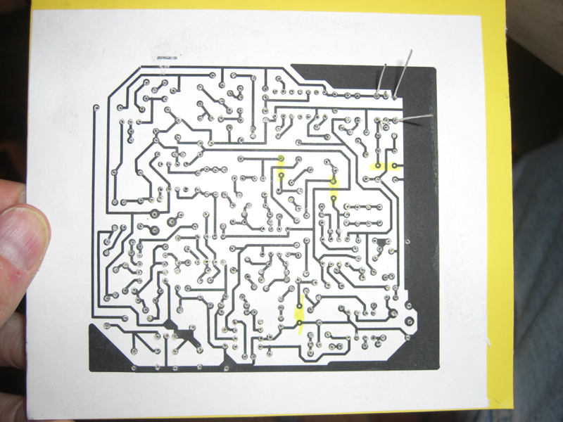

                          • #88
                            TGSL circuit built on cardboard, hand-wired
                            My first TGSL Final does not use PCB. Instead, I printed and glued the layout images on both sides of a piece cardboard, drilled holes, placed parts, and hand-wired the circuit.
                            It was important to line up both images (top and bottom of PCB layout) on each side of the cardboard as I glued them on. But it was not too hard if you print out the border lines and trim the cardboard after gluing the first image. The holes on both sides lined up quite well.
                            It was very difficult to hand-wire; took several days. But I was ignorant, had not soldered for a long time. I used bare copper wire from craft store instead of tinned buss wire. The solder would not flow on the copper wire -- caused many problems. If I were less stupid, I would have cleaned copper wire with abrasive. Now I have tinned buss wire (30 awg), much easier to work with.
                            I also bought new Hakko solder station and was not familiar with the iron, so learning as I built. It was messy, but I could do better next time.
                            I used a hand drill for holes. It worked well, easy to drill through cardboard; but takes time to drill all the holes. That is one advantage to perfboard designs -- no drilling!
                            To make the cardboard more permanent, I have acrylic coating I can paint on, but I have not used it yet.
                            Attached are some photos and in next message also.
                            -SB

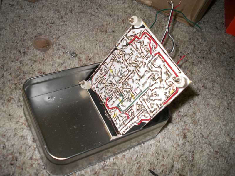

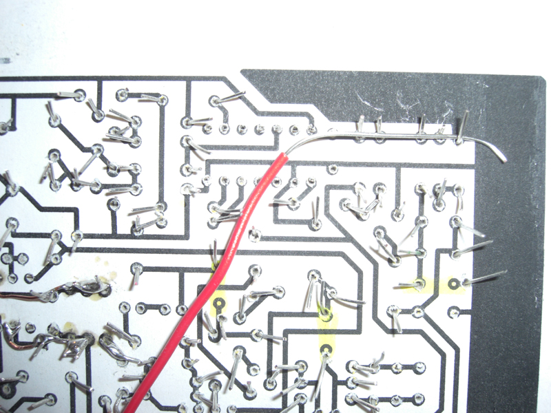

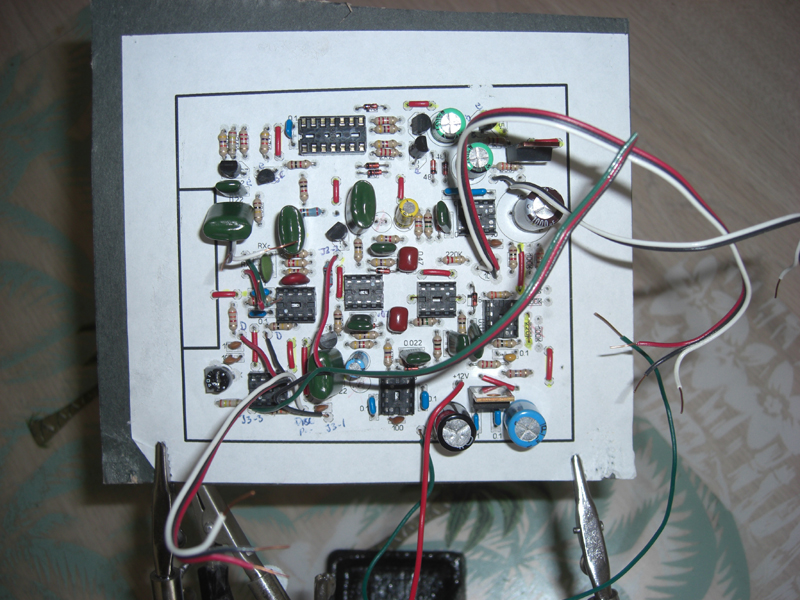

                            • #89
                              TGSL circuit built on cardboard, hand-wired (cont)
                              More photos.
                              Lessons learned:
                              - Next time, don't leave insulation on top-side jumper wires -- easier to attach test probes.
                              - Add test point loops on top of circuit board for oscilloscope probes.
                              - IC sockets with longer pins would be easier.
                              - Use some kind of pin at trace corners to wrap/guide buss wires.
                              - Don't use copper wire for buss wire, or make sure clean it first.
                              - Use 63/37 solder instead of 60/40 solder for quick joint.
                              - Don't trim parts leads until ready to solder -- they can make useful buss wires.
                              -SB
